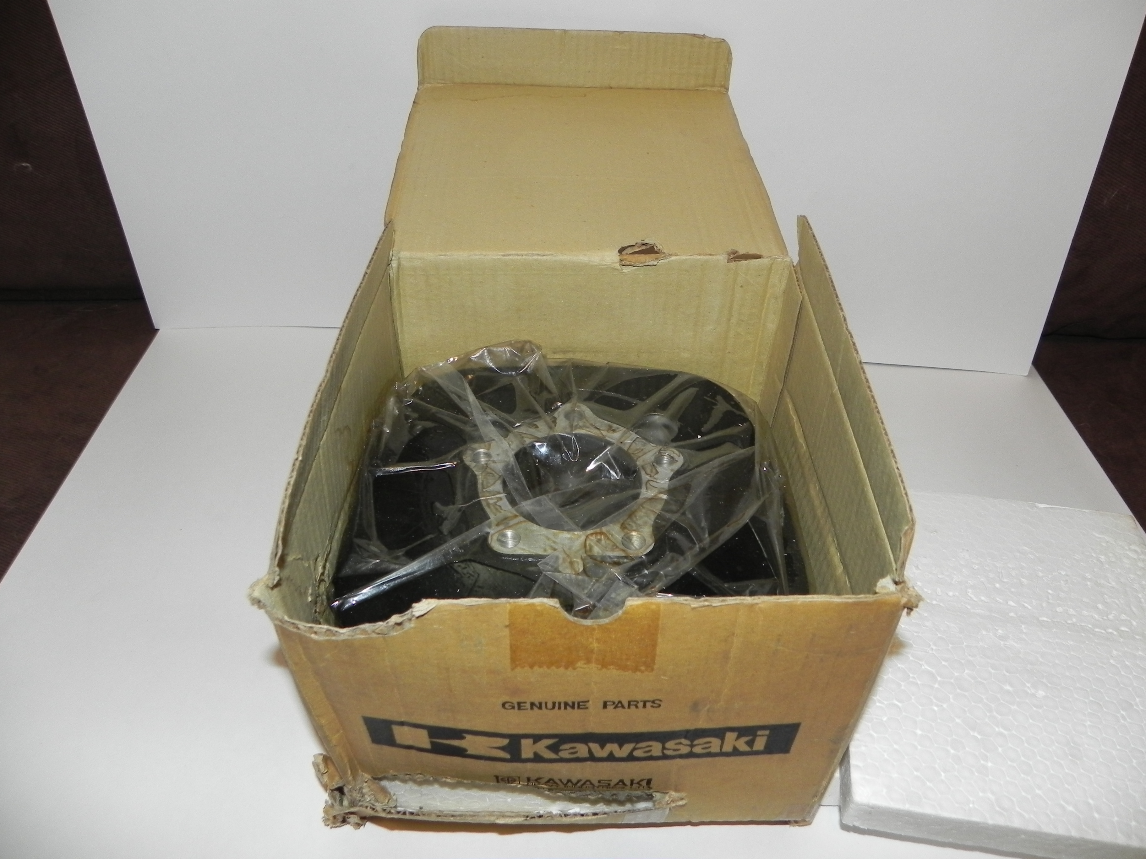

Posted: 05:18 pm Jan 28 2021
Hopefully, pretty soon you will have one even better than this one I used to have: :boogie:
