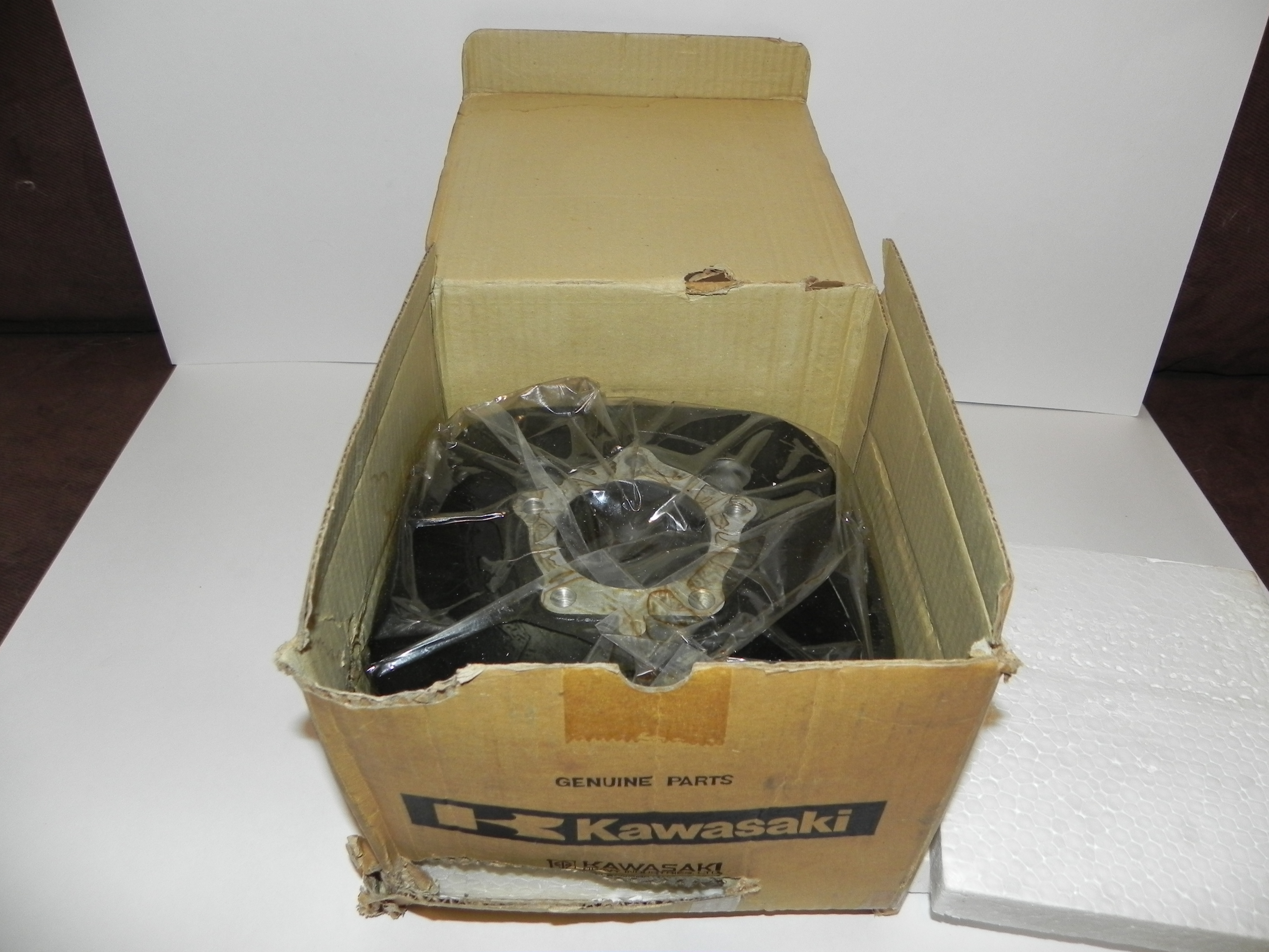

Hopefully, pretty soon you will have one even better than this one I used to have: :boogie:
