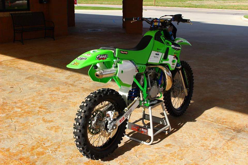

I'm a fan of the KX500 fender on the rear. It fits with very little modification.

Wow! NICE!

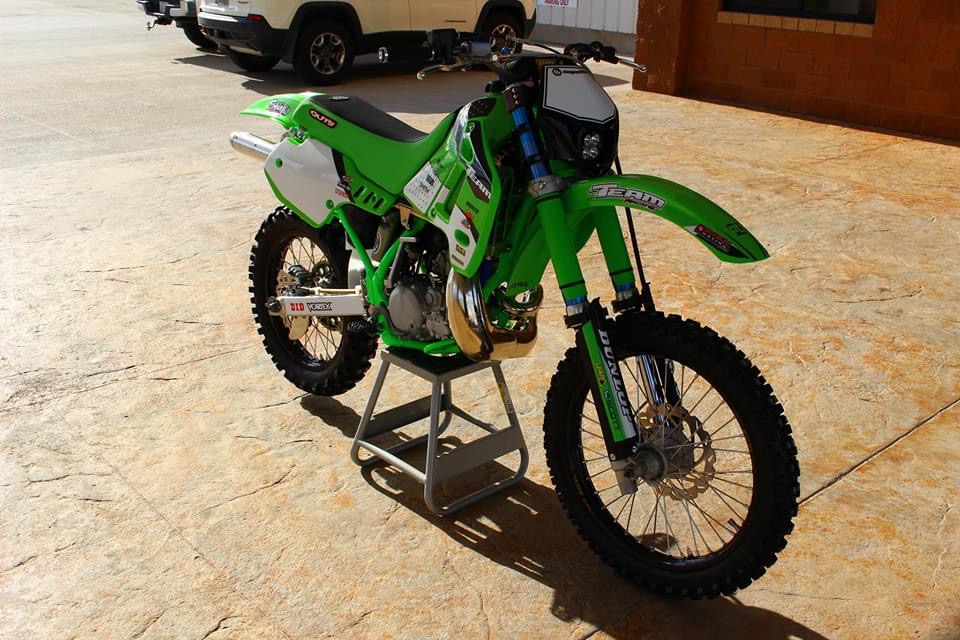

BigD, what is the front fender you're running? Looks great.
