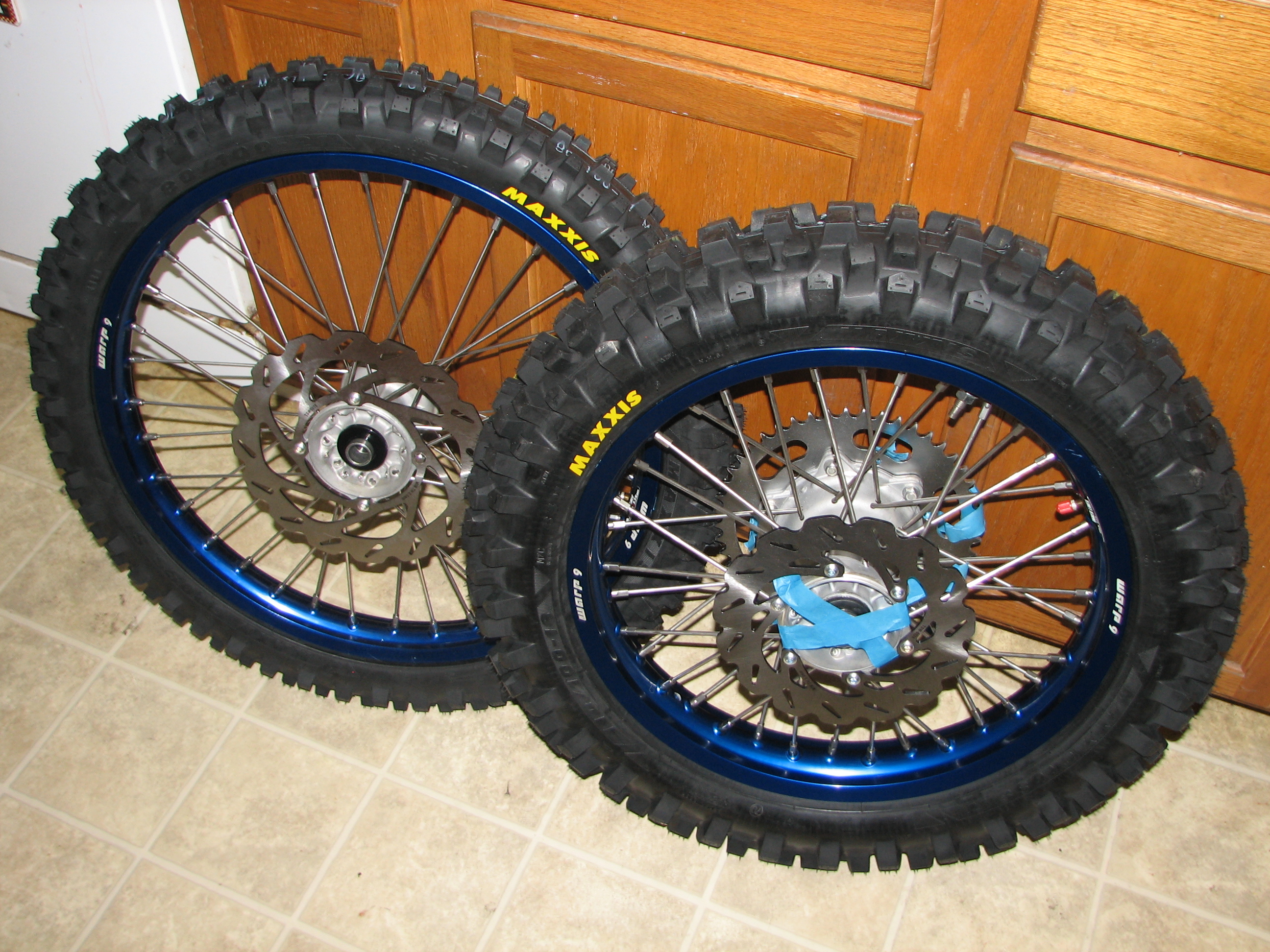

Re: '89 wheels
If you order rims then definitely check out the Warp 9's. Excellent customer service and the wheels I built with their rims are still true and ding/damage free.
Here's a pic of the wheels I built using Warp 9 rims when they were new.
