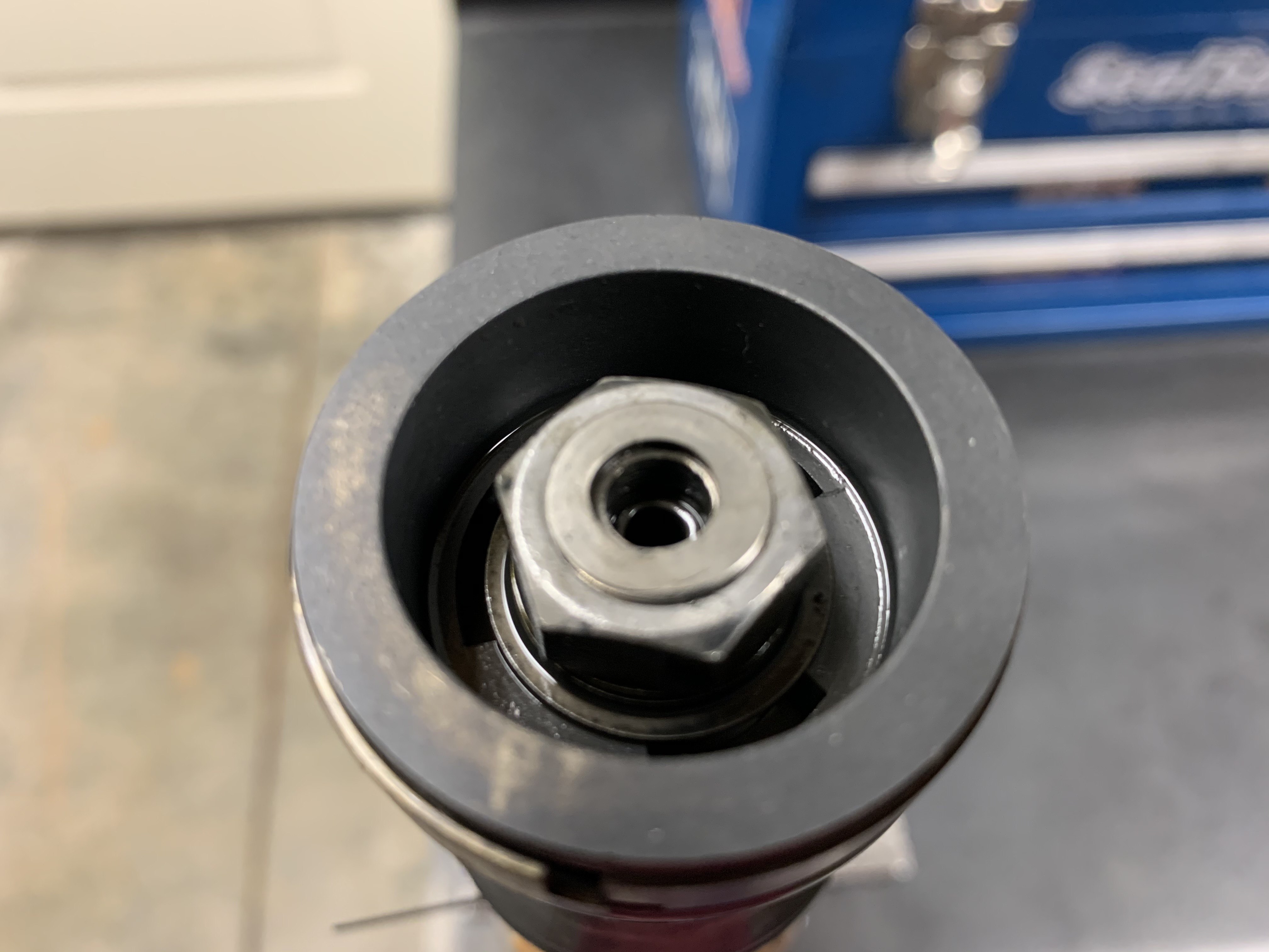

Question: Since I am replacing the piston seal head, I'll need to remove either the nut by the piston or the clevis. The nut on my piston shaft has a plate over it, which is different from the punched threads I ground down on my 86 KDX. How is the plate removed so that I can access the nut? Would it be easier to remove the clevis and if so, how should I position the damping dial?

Can you post a picture of the whole body and whole shaft?

Here you go - thanks for thinking about this.

Is the end of the shaft not peened over like the newer shaft ends? On those, I just shove some grease down inside to catch the filings and flat grind it down.
It almost looks like a Showa, where it had the reound needle holding portion at the end and one would have to grind it at an angle to keep the parts inside. Look on youtube for the Race Tech shock videos. The two styles are shown.
Someone on eBay has a shock for sale, showing the cap does not have the two holes. :hmm:
