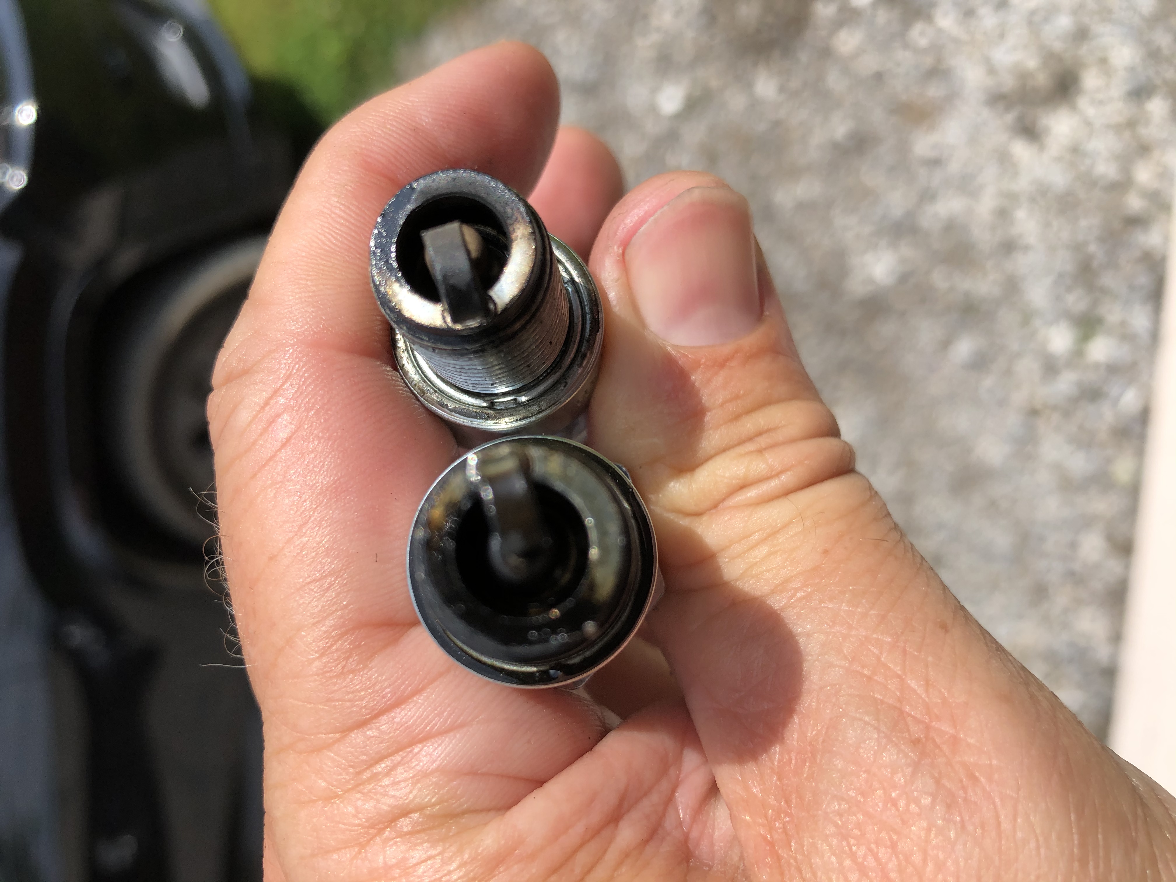

I’m trying to tune this carb.
The bike is idling fine but when I try to open it up the bike seems to bog down and doesn’t open up.
First plug is to the right and the second plug is to the left.
I thought it was running lean but looking at these plugs I’m not sure. New to this tuning thing. Any advice would be great. I’ve turned the needle 2 turns to the right.

typically yes when a bike bogs its because it is lean and needs more fuel but when i look at those plugs it looks like another problem might be learking inside the engine maybe leaking crank seals? Doesnt look like 2 stroke oil burning there. What oil are you using and at what ratio are you using. Those are great carbs but they do require careful set up do you have all of the manuals that came with it? They are way better but they are still not all the way there yet Cody Webb is working with the manufacturers of both the Smart and Lectron to get it to where riders of their caliber are satisfied . You have a great Carb there but those plugs are raising a red flag to me did the bike run great before the new carb install?

Golden spectro has been around for many decades and has a trillion million of die hard users and it is an olde but goodie so that is not the problem But there is something wrong with the plugs in the pictures that are not related to the carb, Im not going to ask what jetting you are using cuz you aint got non.lol I do know initial setup is critical from all the research i have done on this carb as i may purchase one my self. Did your plugs look like these pictures before the carb? What is your cranking psi with a compression test? I do think a complete top end check is in order starting with the easiest first Reeds By the way what plug are you using? Kips valves, partially clogged silencer,working into crank seals,popping the head off and checking the cylinder for wear,piston wear rings so forth a cracked or chipped reed will cause rich running conditions or not run at all, You should only achieve the perfect coffee and creme plugs on extended high rpm use usually general riding will be slightly darker and that is normal, There is alot of knowledgeable people here and with all our heads together we will get you through this the patient always survives! the give away here is you say it seems to be running lean but the plug is saying something that its way to rich thats what is indicating the problem is else where. so first things first what plug are you using? check the reeds for proper closing chips or cracks I hear you saying the bike ran good before the carb what did the plugs look like then. It is surprising how well these bikes will with completely worn out top ends. 15 years ago my buddy had one that had 0 resistance when kicking it over or by hand by that matter and it ran good go figure

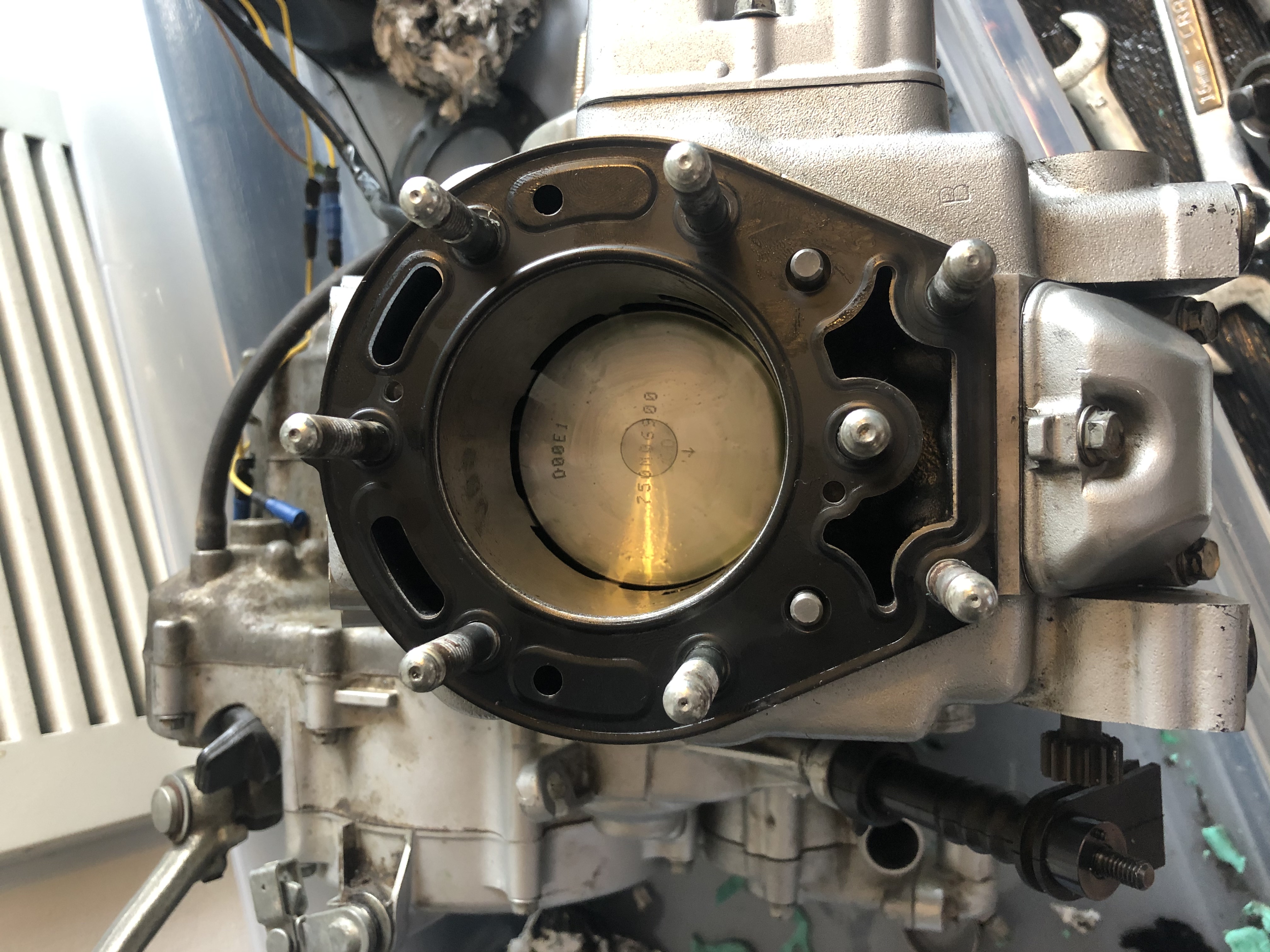

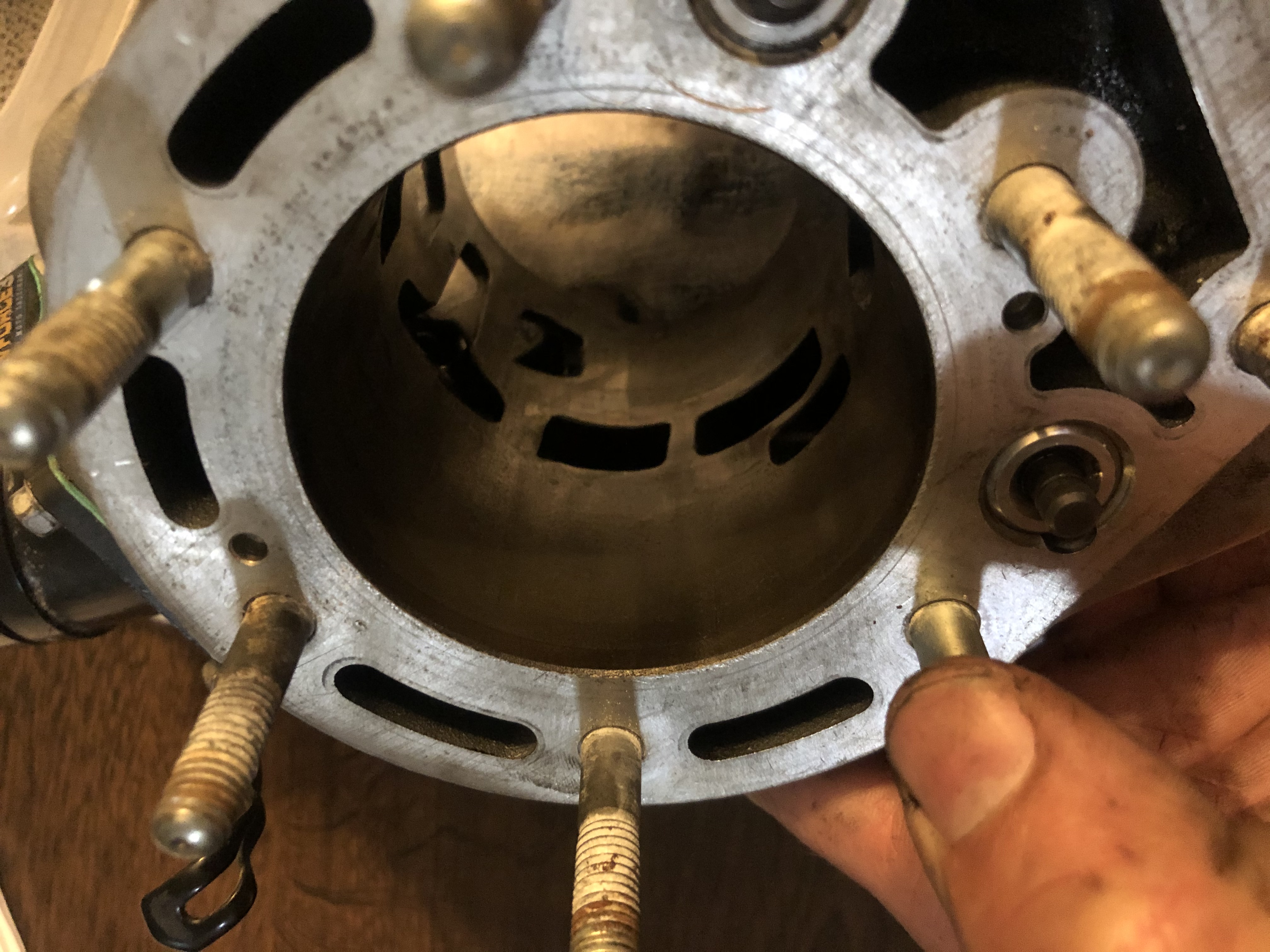

Ok, so I decide to open up the top end and started going through the bike. The Reeds looked good but ended up buying new and adding V-Force Reed Valve so we are good on the reeds, opened up the top end and everything looked pretty new but the Kips system was covered in junk. Cylinder looked good and was within all the specs in the manual. Going to get it all back together and start fresh with my Lectron. I'm hoping the cleaned Kips system and a re-adjustment might be the key. I did notice the seal from the carb to the airbox wasn't good so purchased a new larger clamp.bikeman2502001 wrote: 08:16 am Aug 23 2020 Golden spectro has been around for many decades and has a trillion million of die hard users and it is an olde but goodie so that is not the problem But there is something wrong with the plugs in the pictures that are not related to the carb, Im not going to ask what jetting you are using cuz you aint got non.lol I do know initial setup is critical from all the research i have done on this carb as i may purchase one my self. Did your plugs look like these pictures before the carb? What is your cranking psi with a compression test? I do think a complete top end check is in order starting with the easiest first Reeds By the way what plug are you using? Kips valves, partially clogged silencer,working into crank seals,popping the head off and checking the cylinder for wear,piston wear rings so forth a cracked or chipped reed will cause rich running conditions or not run at all, You should only achieve the perfect coffee and creme plugs on extended high rpm use usually general riding will be slightly darker and that is normal, There is alot of knowledgeable people here and with all our heads together we will get you through this the patient always survives! the give away here is you say it seems to be running lean but the plug is saying something that its way to rich thats what is indicating the problem is else where. so first things first what plug are you using? check the reeds for proper closing chips or cracks I hear you saying the bike ran good before the carb what did the plugs look like then. It is surprising how well these bikes will with completely worn out top ends. 15 years ago my buddy had one that had 0 resistance when kicking it over or by hand by that matter and it ran good go figure
