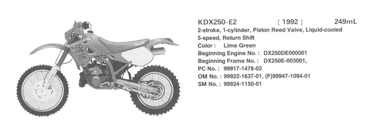

Hi.
https://en.impex-jp.com/catalogs/moto/k ... -1597.html
1992 KDX250-E2.png (179.04 KiB) Viewed 7949 times
From the Impex site, it looks like a standard piston from a dirt KDX250, 13001-1345. Wiseco used to make one.
Be sure to make sure the cylinder can use a stock sized piston or get the correct one for a sleeved cylinder if that is what you have.
https://www.partzilla.com/product/kawas ... 9b8092697c
The stock cylinder would have an Electrofusion coating, which is similar to Nikasil or plating / plated. It was not sleeved or iron / steel when new.
