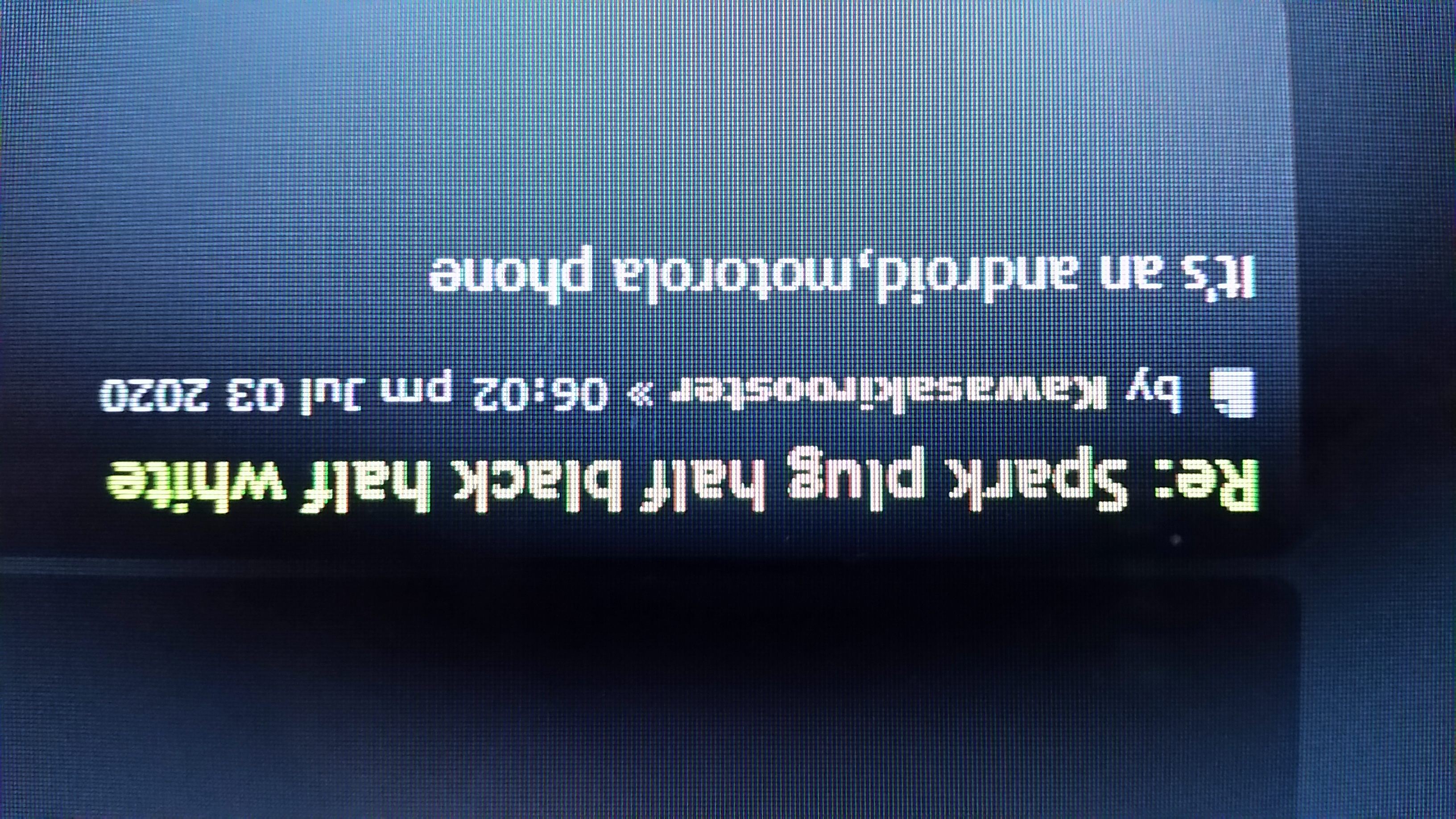

Sorry for the delay,work is busy,I don't know this pic posting is not going the way your post says, no option to place in line, tried dragging,hence the result you see
Re: Spark plug half black half white
What kind of device are you using?
Kawasakirooster
Posts: 14
Joined: 06:32 pm Jul 05 2019
Post by Kawasakirooster »
It's an android,motorola phone
It is working for me using Android Samsung. I am not sure what is going on.
