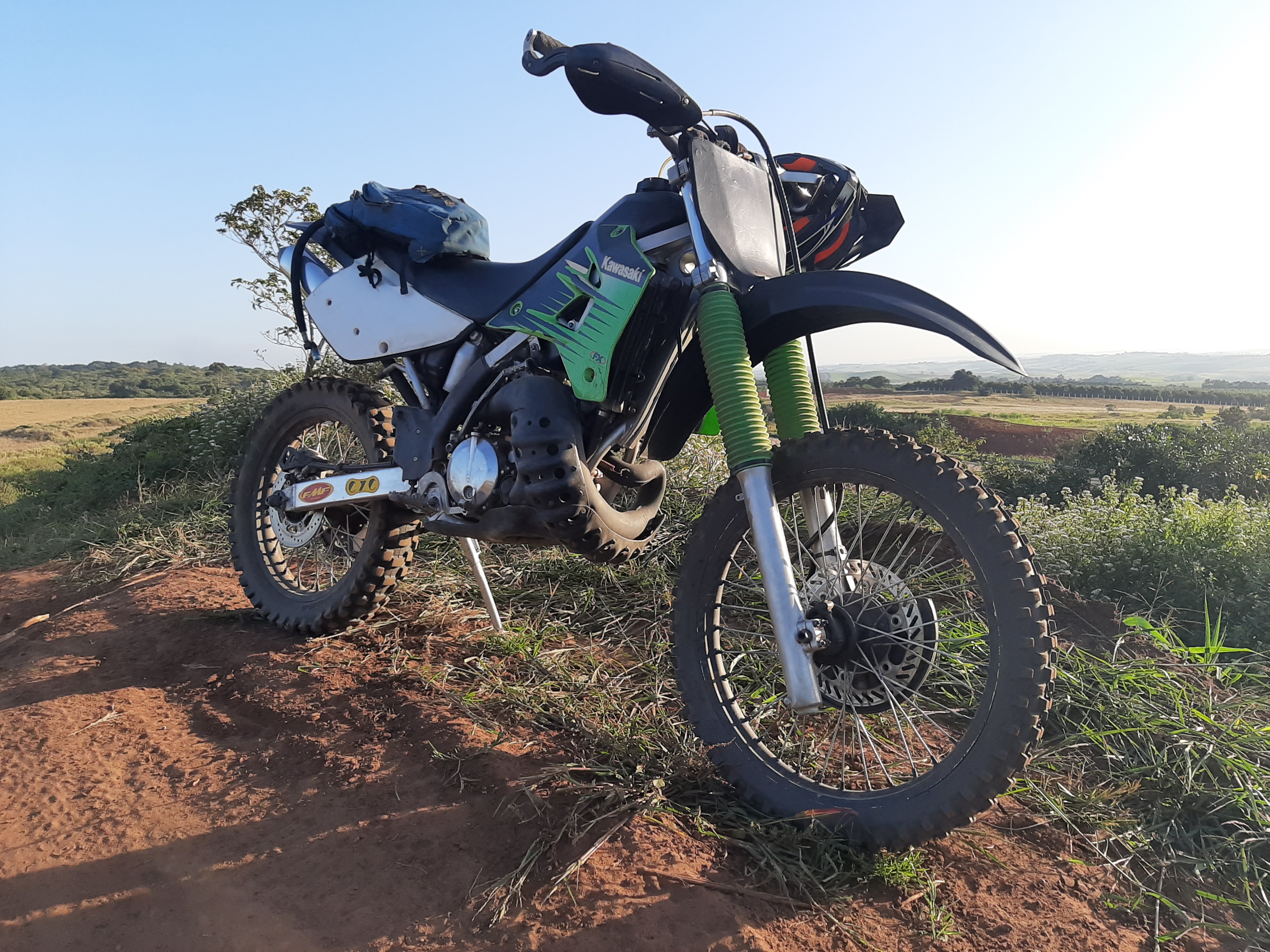

Re: 2005 KDX 200 Not reving into powerband
Post by JohanKDX200 »
Pride and joy
Pride and joy
Oh hell yeah! NICE!
