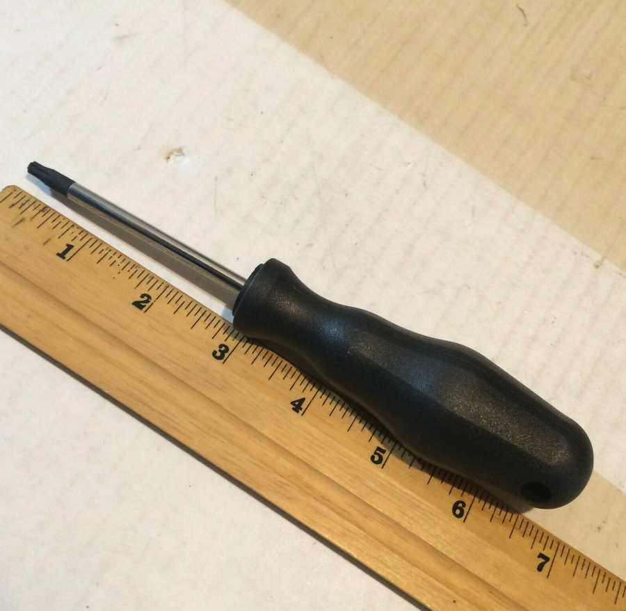

Re: Please HELP 2001 KDX 200
Not the bowl gasket. There is another gasket in the fuel bowl. You will need a Torx bit to remove it.
- Posts: 14748
- Has thanked: 193 times
Security T-20
Member treelimb on here got his from Lowe's. They show one set in store at Madison Lowe's. You can order a single if you don't want the whole set. It HAS TO BE a somewhat long bit / socket, not a real short one. There are other carb parts in the way.
If the carb is dipped, it sometimes damages that gasket.
https://www.lowes.com/pd/Kobalt-8-Piece ... et/3387794

- TwistedRoot
- Posts: 323
- Location: Florida, US
I found this T20 on ebay for $6.
- security Torx20.png (1.1 MiB) Viewed 4532 times
