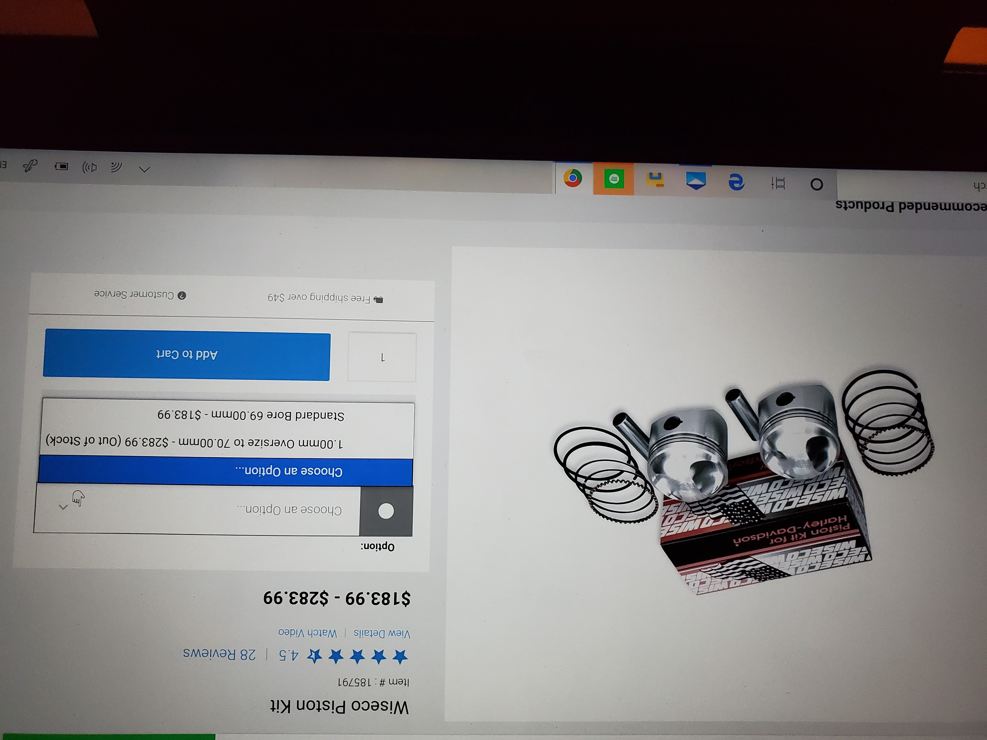

Would this be the correct piston ? I am not sure what standard bore or oversize 70mm is?
Rippy11
Posts: 28
Joined: 08:47 pm Jun 06 2020
Re: **New /Old KDX220R 2001 info request
Post by Rippy11 »
lets try this the right side up :rolleyes:
Standard size is what you want unless you have specifically had your cylinder bored out 1mm and replated. Not sure that is the correct piston or not as Wiseco's part number (750M06900 - Kawasaki KDX220 '98-05 ProLite 2717CD) is different from what's in your photo.
