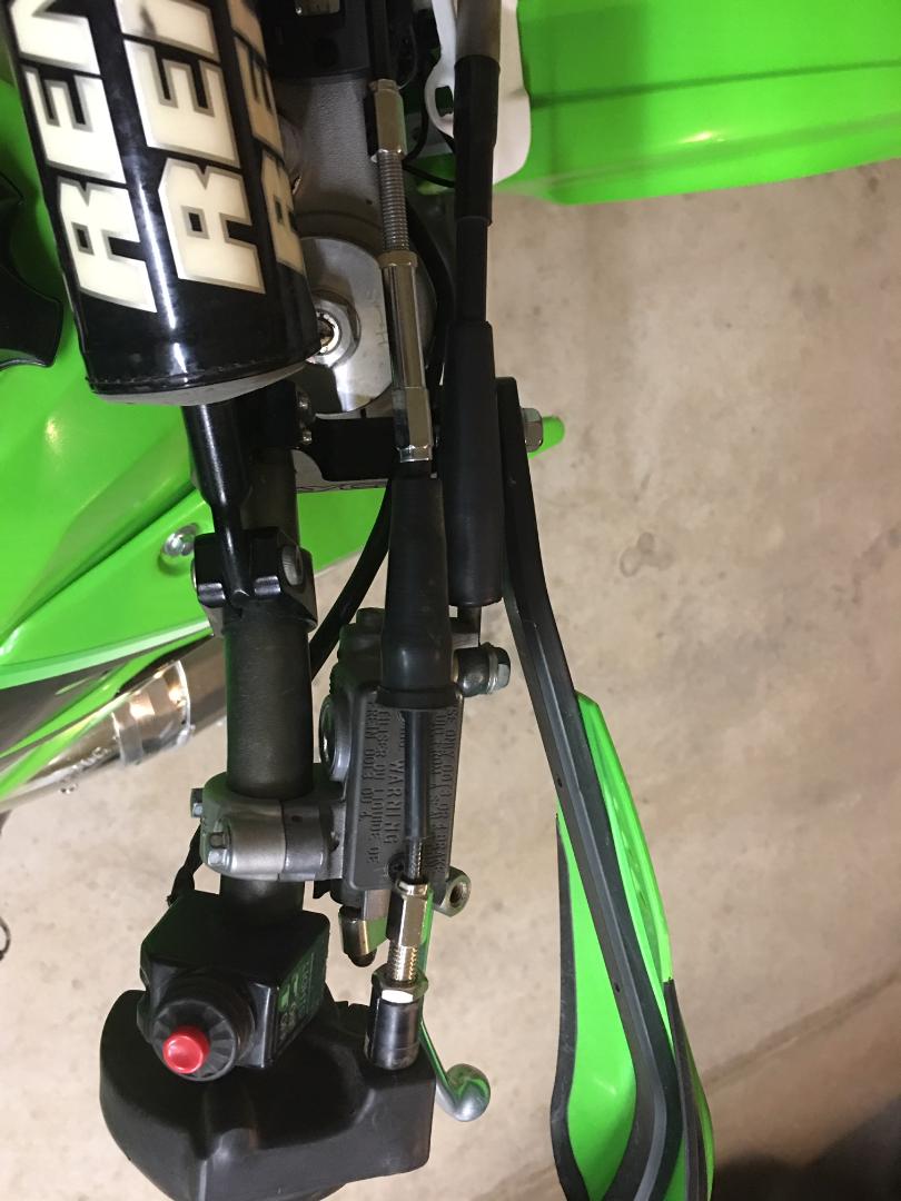

My throttle cable is also right under the tank, but it still works fine. I think I also have the Barnett cable since it came with the Lectron, and I have it adjusted almost all the way out so that there's very little play (pic attached). I wish that it didn't have to be adjusted that far out, but I've been running it this way for about a year now with no issues. Let us know how your carb works when you get your boot clamp secured. I'm sure you're going to love it! :supz:

GATOROC wrote: 09:06 am Jun 22 2020 My throttle cable is also right under the tank, but it still works fine. I think I also have the Barnett cable since it came with the Lectron, and I have it adjusted almost all the way out so that there's very little play (pic attached). I wish that it didn't have to be adjusted that far out, but I've been running it this way for about a year now with no issues. Let us know how your carb works when you get your boot clamp secured. I'm sure you're going to love it! :supz:
Thanks for the pick GATOROC! That's exactly how my cable adjustment looks as well.
For the boot clamp, I just need to get over to ACE hardware and pick one up. Hopefully on Monday or Tuesday of this coming week I'll get out riding and be able to report back!
