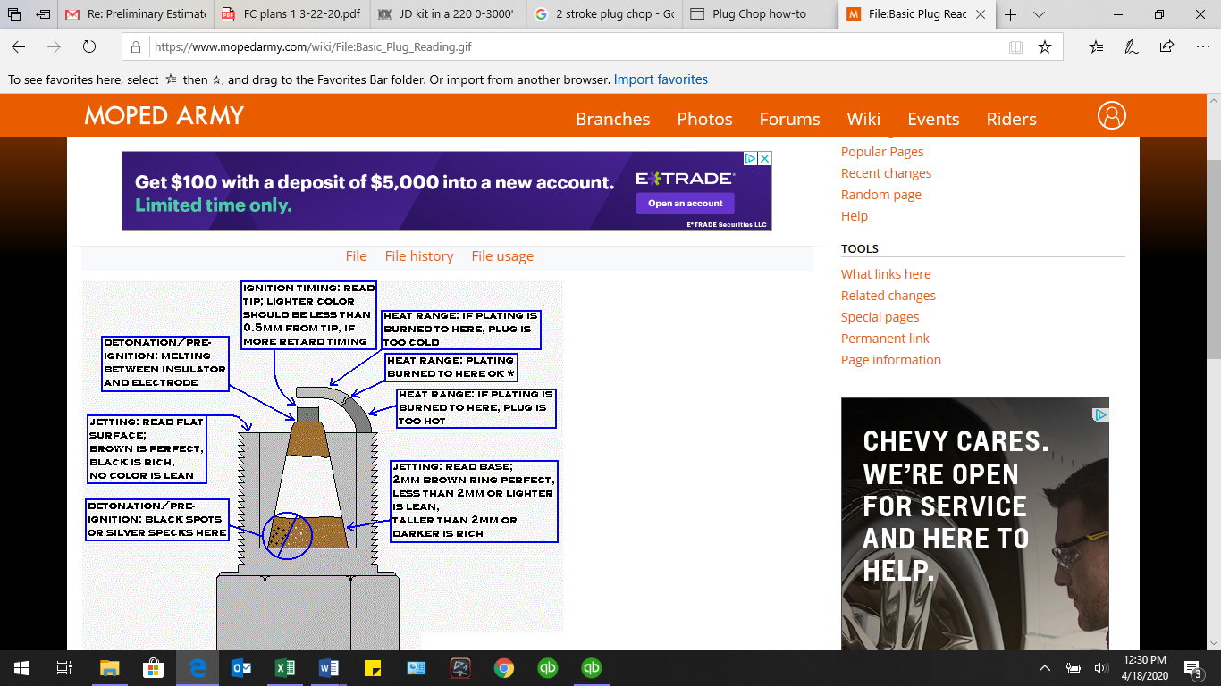

In the meantime I would try that main jet chop again. Something didn't come out right. The lighter section that's below your color line is what should be showing the color. Not that thin of a line and not that high up. The color itself would be great if that were at the bottom of the insulator.
Check out this picture which is main jet chops from rich to lean. It would run great on the 4th plug but If there was one in between the 4th and 5th that was a little smaller and cardboard colored, that would be the one.
Screenshot (100).png (1010.89 KiB) Viewed 7591 times
Shoot for a color line like this one on the main jet. That middle white section would show color during a 1/2 throttle needle chop, and the top brown section is the pilot.
Screenshot (101).png (489.47 KiB) Viewed 7591 times
