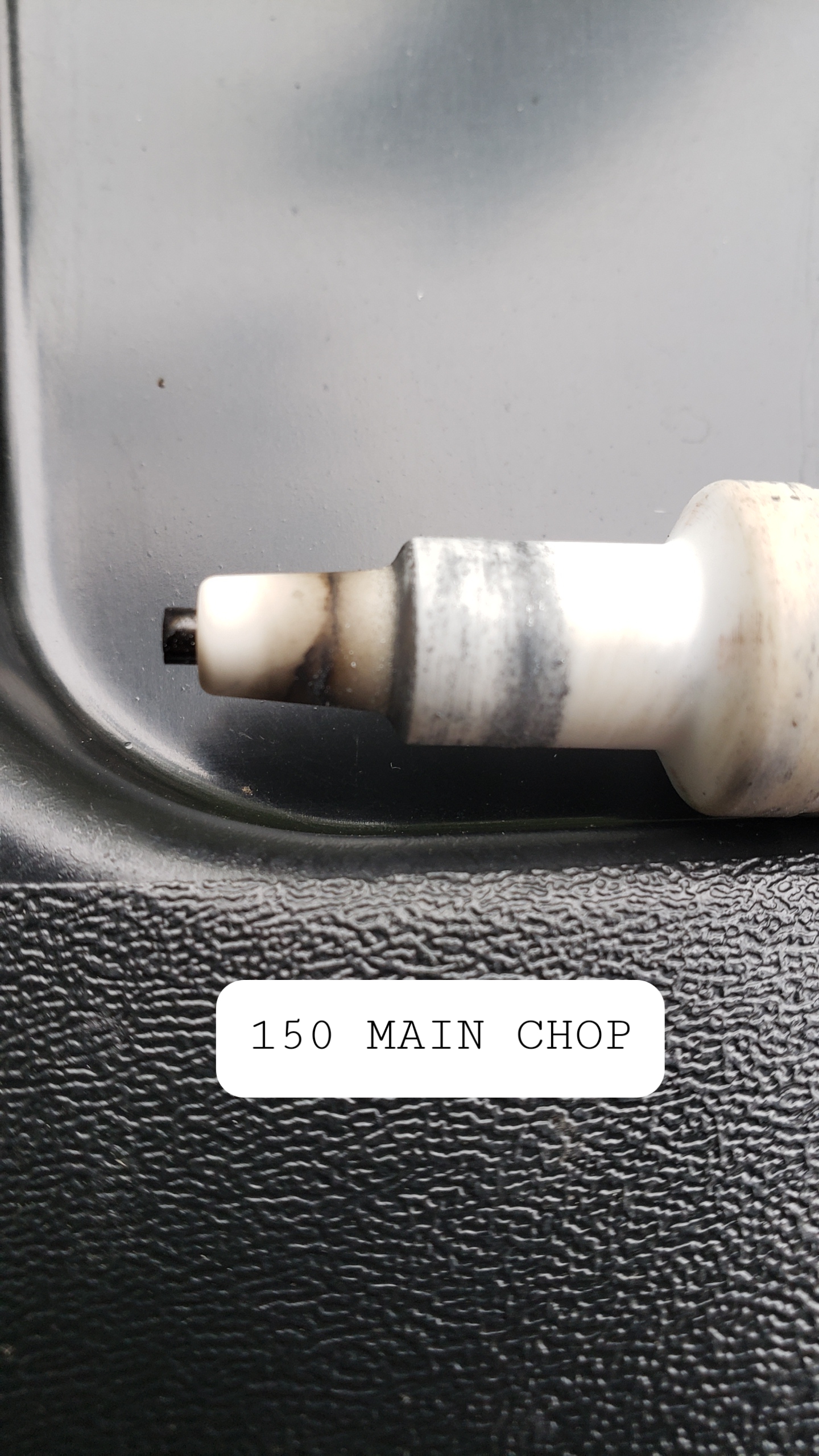

150 after 2 separate runs.
- 20200418_085416.jpg (1.47 MiB) Viewed 7594 times

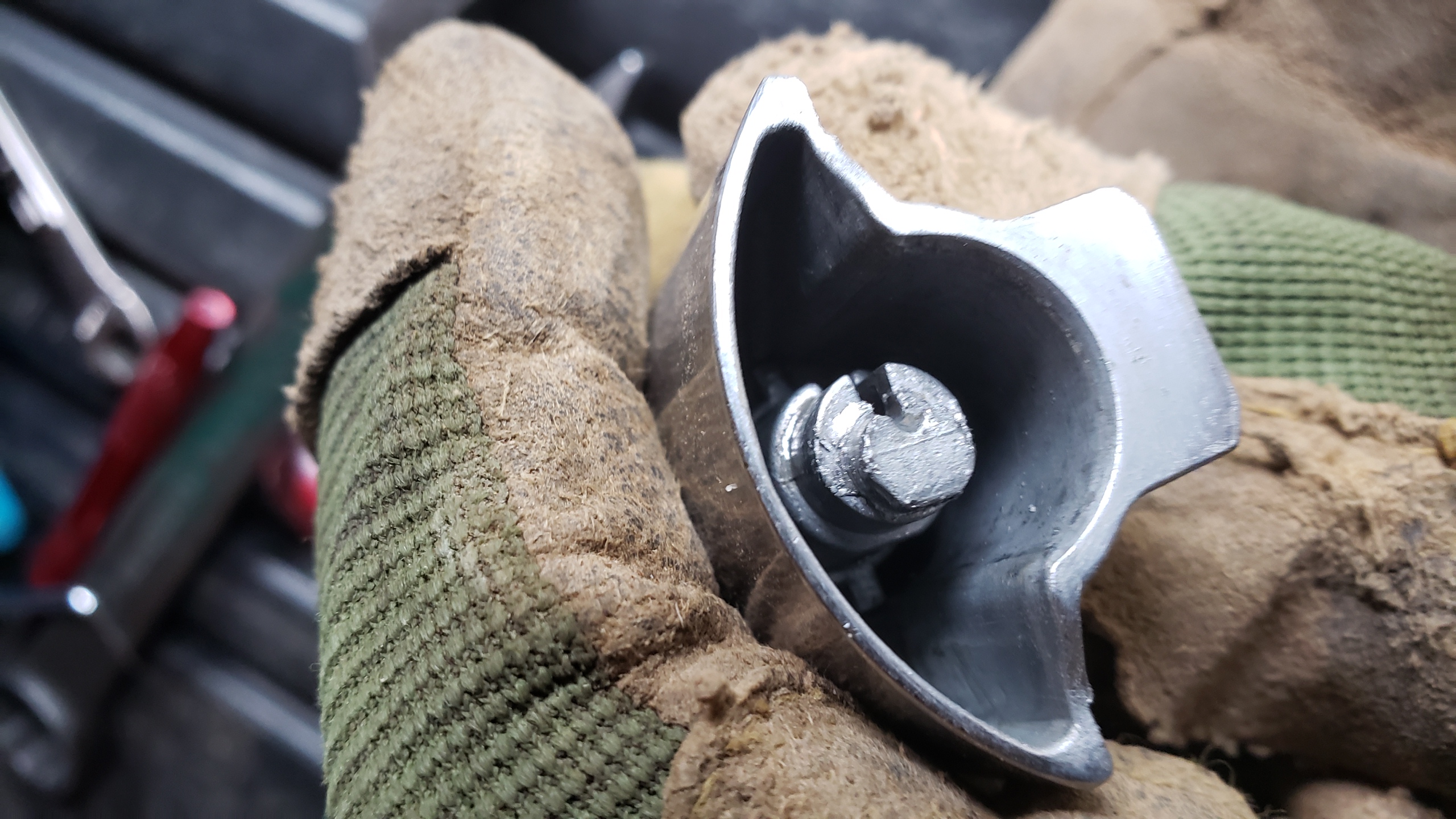

Unfortunately the very first thing I did was installed the Red on clip 3 & rounded this nut. And it won't come out! I tried a 5.5 mm & heat, no luck. So im stuck with it for now. Dam it! No needle swapping today.
- 20200418_075853.jpg (1.07 MiB) Viewed 7594 times

Just when you were ready for a day of tuning. What a bummer! Off hand I can't remember how far down that is in the slide. Would the tip of a small vice grip fit down in there? Probably not. That thing just needs to be snug.
In the meantime I would try that main jet chop again. Something didn't come out right. The lighter section that's below your color line is what should be showing the color. Not that thin of a line and not that high up. The color itself would be great if that were at the bottom of the insulator.

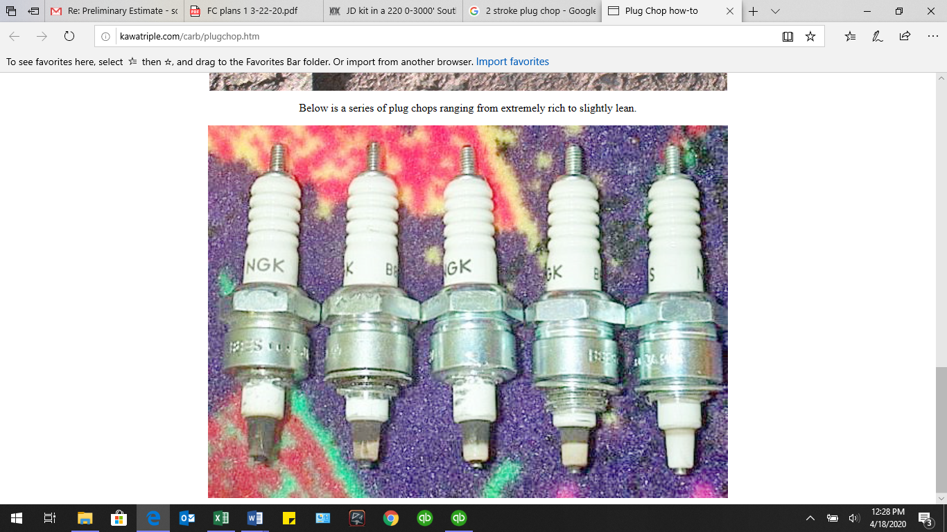

Check out this picture which is main jet chops from rich to lean. It would run great on the 4th plug but If there was one in between the 4th and 5th that was a little smaller and cardboard colored, that would be the one.
Shoot for a color line like this one on the main jet. That middle white section would show color during a 1/2 throttle needle chop, and the top brown section is the pilot.

Get a "Bolt Out" or whatever they call it that cuts into the head to get it out.
You are not the first to round that off. You won't be the last. Six-point is the way to go. Besides torquing the cylinder nuts with the Motion Pro torque adapter, I don't think any other fastener needs a 12-point tool to touch it.

I had that same problem with rounded bolt, took it to a machine shop, they couldn't get it out and just gave up, I got a smaller hex socket and hammered it on, it came loose instantly
