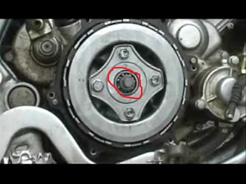

in the picuture . the peace circled . mine moves side to side. is that ok ?
Re: screeching noise on clutch side
Moves side to side in which direction? up/down or front/back, or in/out? That is your clutch actuator rod. When you pull the clutch it goes in and disengages the plates. If its up/down/front/back then that bearing is likely going. When you pull the clutch and aren't moving the center basket stops moving so the noise would stop. Clutch out and the whole thing is spinning

Ok it moves side to side. So that maybe be the noise. But only thing I touched was water pump stuff. This weekend going tare it apart again. And look for signs where it might be wearing
