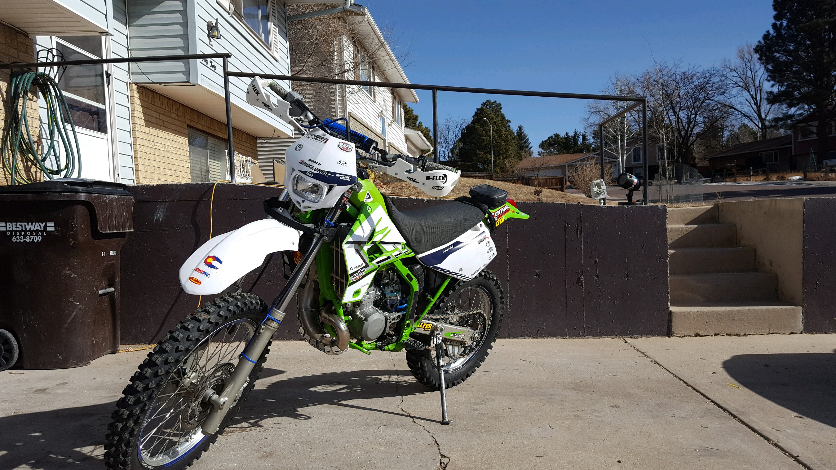

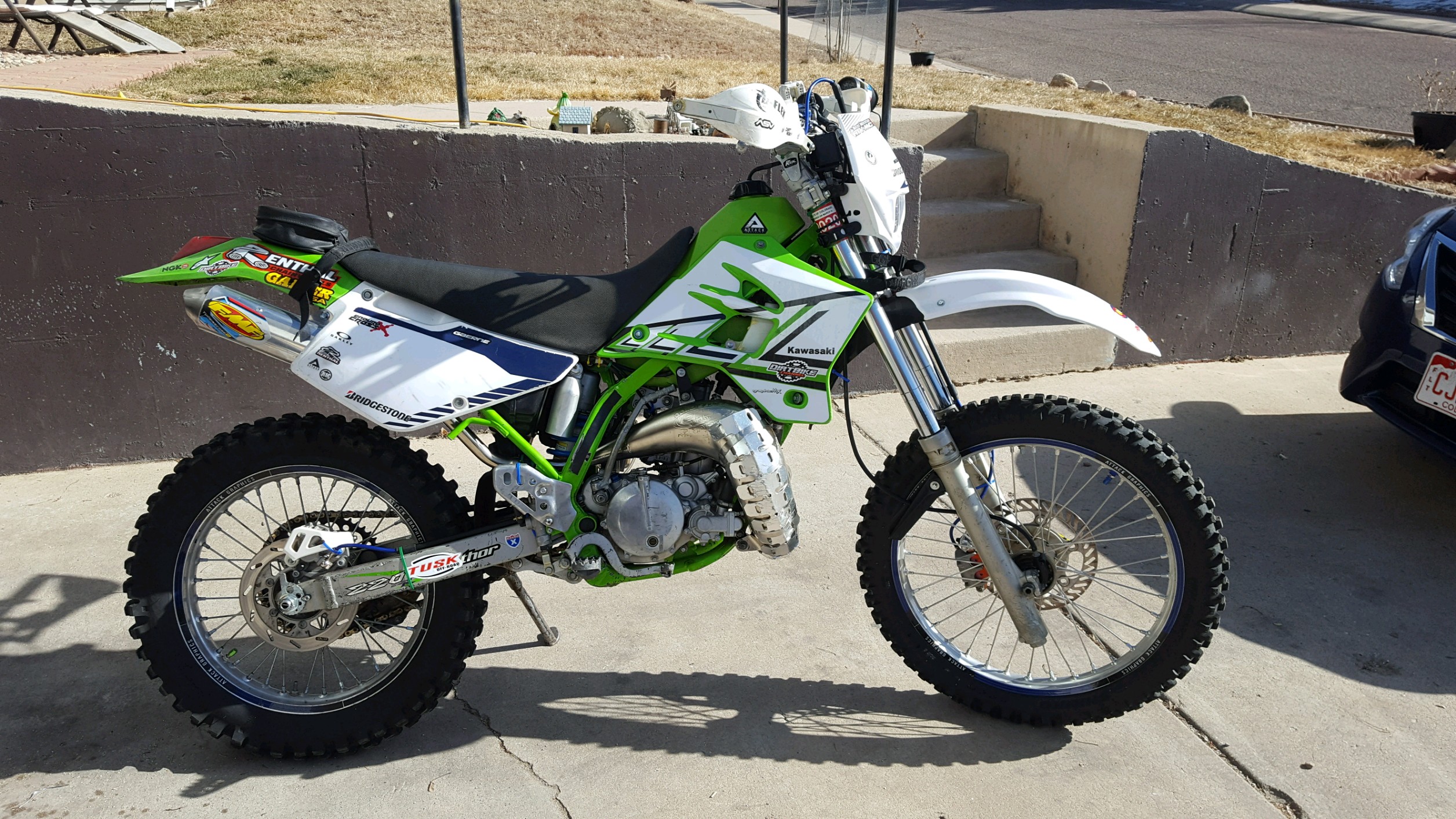

Ive been recomended to run sabre at 90:1 on my KDX 220r 2001, I ride mainly single track colorado high country ??
what do yall think? Blow my engine or Ill be fine??
currently running 50:1 and yes plugs can be dark

And the offer for the fork boots still stands! Damn, that's a nice looking bike, I still say!
