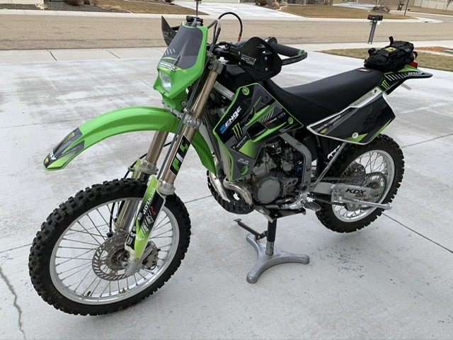

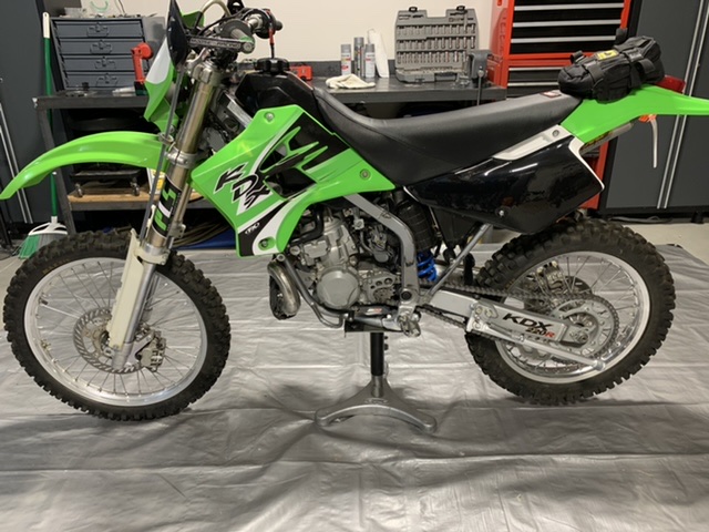

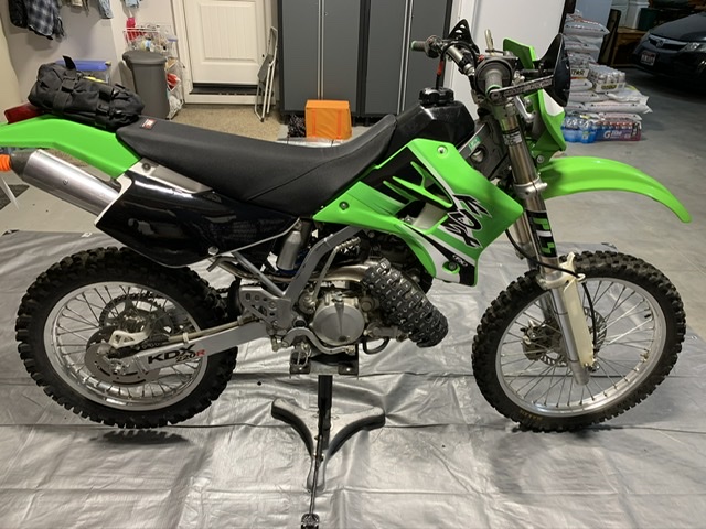

2003 KDX 220
2003 KLX Forks, brake line, lower triple tree
1994 KX250 upper triple tree - to retain rubber mounts & oversize bars
Small hose clamp on frame stop - works perfect for tank clearance
Everything bolts up perfectly, stock odometer, caliper, front wheel.

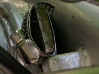

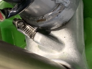

Can you post a pic of your hose clamp/ frame stop?
Everything looks great!

This is all I did, haven’t ridden it yet, but should work just fine

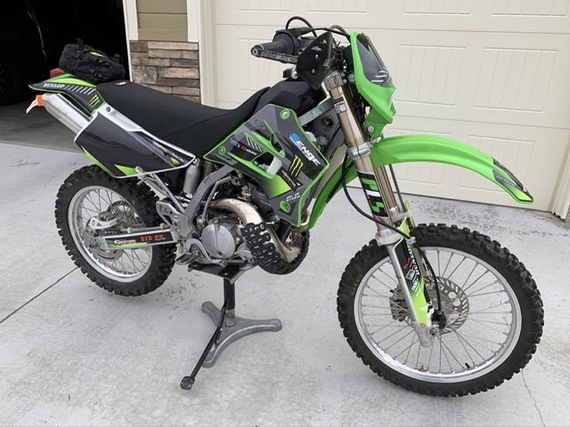

First ride out with KLX fork conversion. I weigh 155lbs in street clothes. We rode some the Rabbit Creek 100 course, which is fairly whooped out in sections. The KLX forks aren’t any stiffer than the stock KDX forks, but seem more planted, and look awesome. After riding some single track, I may need stiffer springs.
