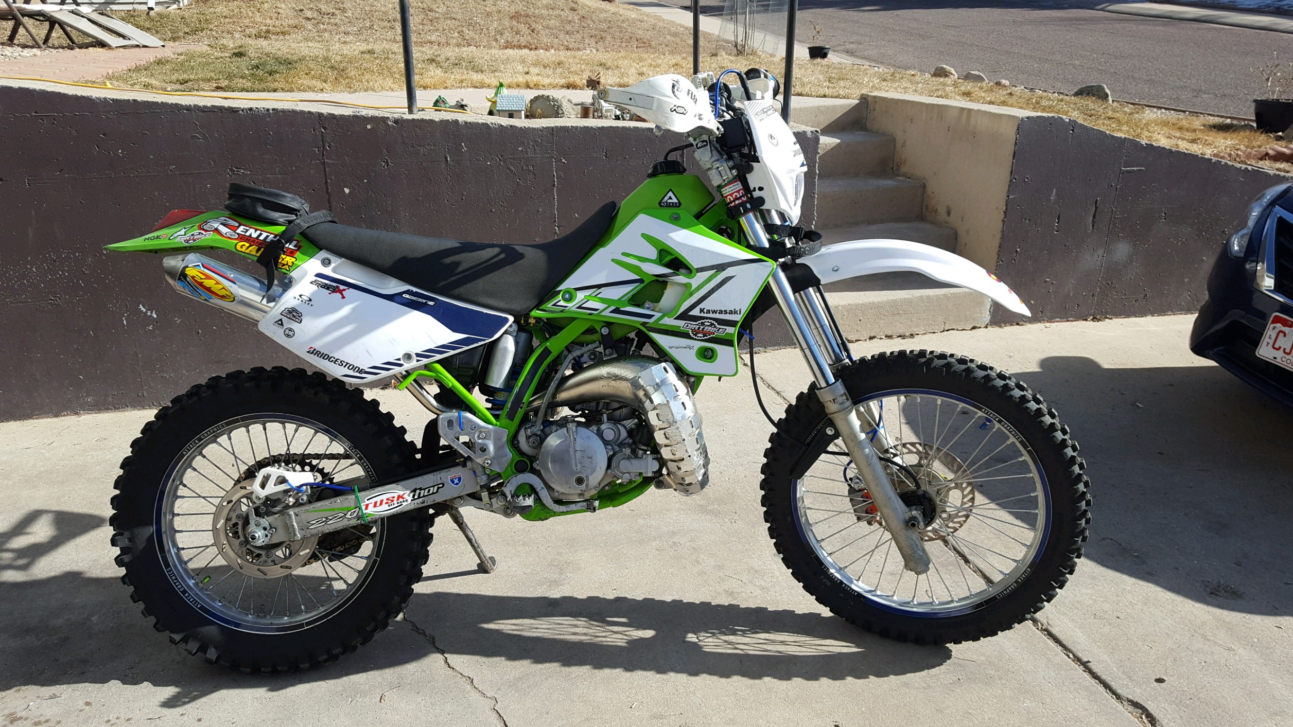

Re: Why Convert Front End?
Hey, kvkdx, that's a really nice looking bike. I like the white. Tell you what, make a donation to this site so you can send/receive PM's and I have a set of fork covers you can have for free. All you have to do is PM me your shipping address. When I get your PM I'll know you've made that donation. No size requirement on the donation. Site doesn't run for free. BTW, sooner or later, probably sooner if you're riding much, you're gonna' have to do something with a worn out kick lever. Take the money you're saving on fork boots and put it into a KX125 kicker conversion. Search the forums for that. Keep on brapping!
Not seal savers, boots, I know lots of folks think they detract from the look, but they do work and help prolong the life of the seals and wipers. Or you could go the route of the 98 RM and run fork guards up top.
I agree with doakley though, you've put together a nice looking bike. Man, if you could find a white rear fender that worked...
