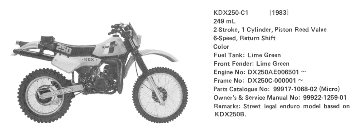

Re: 1983 250 pistons
Posted: 11:57 pm Nov 24 2019
It is a KDX250-C1. We got the "B" models in the USA. Look through this:
https://www.cmsnl.com/kawasaki-kdx250-c ... dtd2pNKiM8
Stock WAS Electrofusion coating. Did someone sleeve it since new? Having a cylinder plating company to strip off the old coating and plate it is usually the best way to go. For info's sake: (I know you are not mailing it over here)
https://www.millennium-tech.net/serviceInfo.php?id=7
Posted: 08:15 am Nov 25 2019
1984 frame numbering starts at 701. 1985 frame starts at 901, so I doubt they made very many at all!
The source is the Model Recognition Manual that dealers used to have in paper format.
