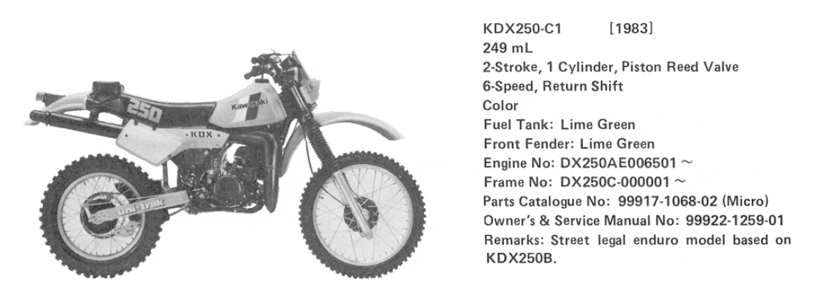

Thanks it engine no DX250C A E 008122
frame 6/83 DXC250C 000 452
Re: 1983 250 pistons
It is a KDX250-C1. We got the "B" models in the USA. Look through this:
https://www.cmsnl.com/kawasaki-kdx250-c ... dtd2pNKiM8
Stock WAS Electrofusion coating. Did someone sleeve it since new? Having a cylinder plating company to strip off the old coating and plate it is usually the best way to go. For info's sake: (I know you are not mailing it over here)

I wonder how many C1KDXs were made for Australia?I figure at least 452 as my frame is 000 452. There is a bit of a history of japanese manufacturers making registerable versions of enduro bikes for Aus. it certainly opens up your riding options being road legal and hopefully will ultimately get this bike registered. Seems like core mechanical parts will be obtainable ,some other bits may require persistance and ingenuity!

1984 frame numbering starts at 701. 1985 frame starts at 901, so I doubt they made very many at all!
The source is the Model Recognition Manual that dealers used to have in paper format.
