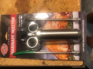

Back bleed it from the lowest fitting using a syringe type injector with the upper master cap off or use a hand vacuum pump like a mighty vac and draw using suction down from the master to the slave. Good luck those can be a pita!

I'm going to try my wife's turkey injector syringe and back fill from the bottom.
Let you guys know.

I went to the TSC (Tractor Supply Company) & found what I needed. Worked pretty darn well.
Re: Hydraulic question
Perfect tool for the job!
