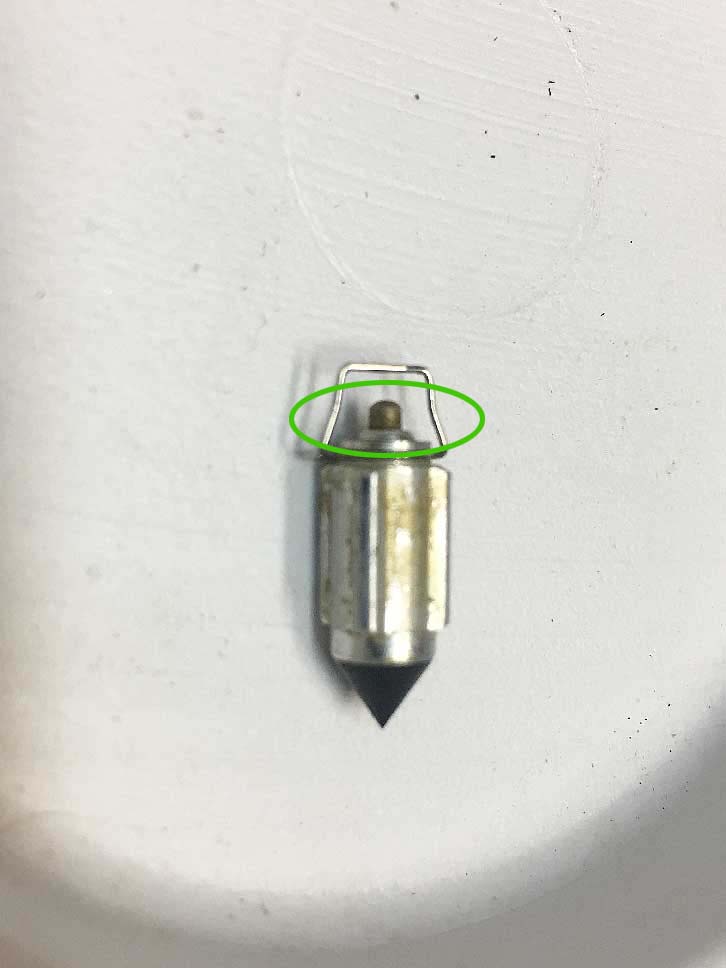

On a stock PWK35 do you all know if there is a spring that sits under the float valve? It hung a little previously and I could measure it at 17mm, but after reassembly they flop around. Not sure if Im missing something or not. Floats have more play and bowl overflows. Did not see anything on the RM oem site and Im kicking myself for messing with it! :oops:

The float needle has a plunger that is spring loaded. The spring can get tired so when you replace the float needle it holds the float up better. I had to replace my float needle to get the float level problems resolved.
Re: Spring under the float valve?
Yes, the float pin (on the opposite end from the rubber tip) is spring loaded. Easy wear item to replace and they do wear out.

Can you point me to that part or does it come with the a new float?
Is it this thing? Its described as a "clamp" tho not spring.

TwistedRoot wrote: 03:40 am Jul 04 2019 Can you point me to that part or does it come with the a new float?
Yeah that’s the clip that keeps the needle from falling out of the seat right?

#16030. You can find one at a local shop.

rungrandpa wrote: 10:48 am Jul 04 2019 #16030. You can find one at a local shop.
Ok so its an internal spring. I wasnt sure if there was a separate part or not. This pic shows the "spring" loaded part. This is the original float valve, not the newer one that came with my kit. Sorry about the dumb questions.

TwistedRoot wrote: 11:05 am Jul 04 2019
Yes. It dampens the impact of the tang from when the floats hit the float arms. It’s all one part, technically.

Thanks kdxsully. That was kind of dumb on my part. I knew there was not an external spring. Idk what the heck I was thinking. Anyway I have my float set at 17.8mm and will get to testing out some different needles. I recently tried out a DEJ needle and all I can say is: wow.
