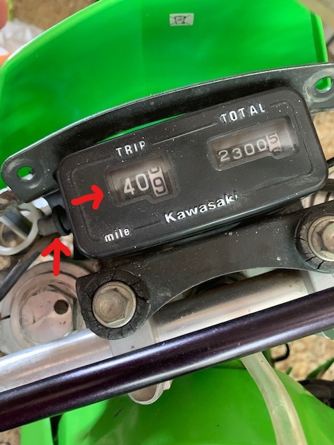

I replaced the cable with a brand new one and it appears that the odometer works and rolls over but the Reset knob on the "Trip" side won't reset. I haven't jumped into lubing and cleaning the odometer yet but based on the suggestion above I may give it a shot. I was hoping that by riding some miles and having the numbers turn would loosen it all up but the little side knob still doesn't re-set the numbers.

That is it. I thought it just pulled out a little, then could roll the numbers back and then it went back in. Someone correct me if I am wrong.

Correct. Pull the knob out, and turn. Push the knob back in.

Guys good news, I was able to do a good clean out and a lube to the odometer and it is all working great. The Trip meter knob works again too.
What I discovered was if you remove the odometer from the bike there are 2 spots that appear to be meant for lubrication. I cleaned out the dirt and sprayed the the lubricant and Voila! all works well again. I should mention that I had already purchased a new cable. Cheers!
