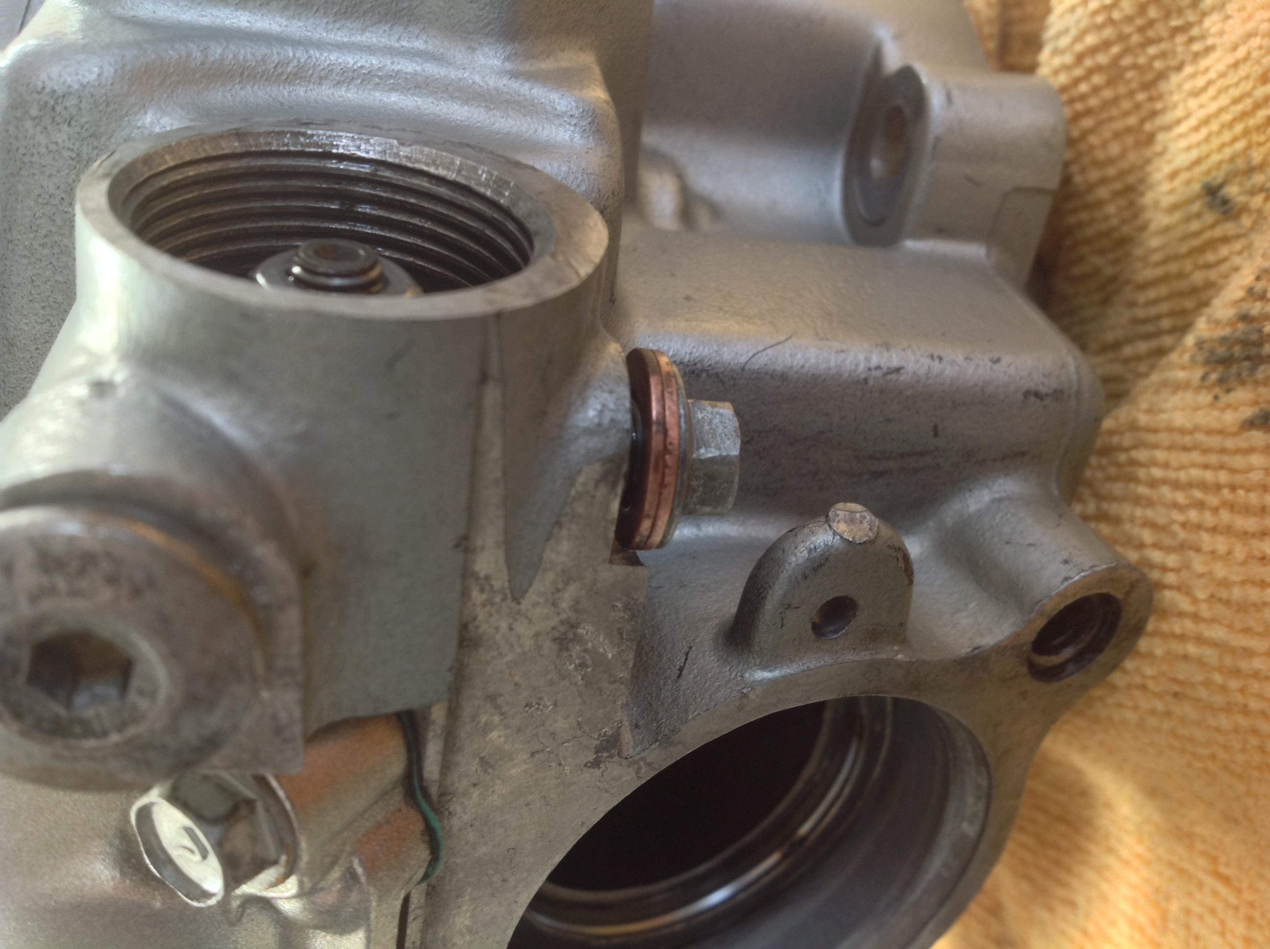

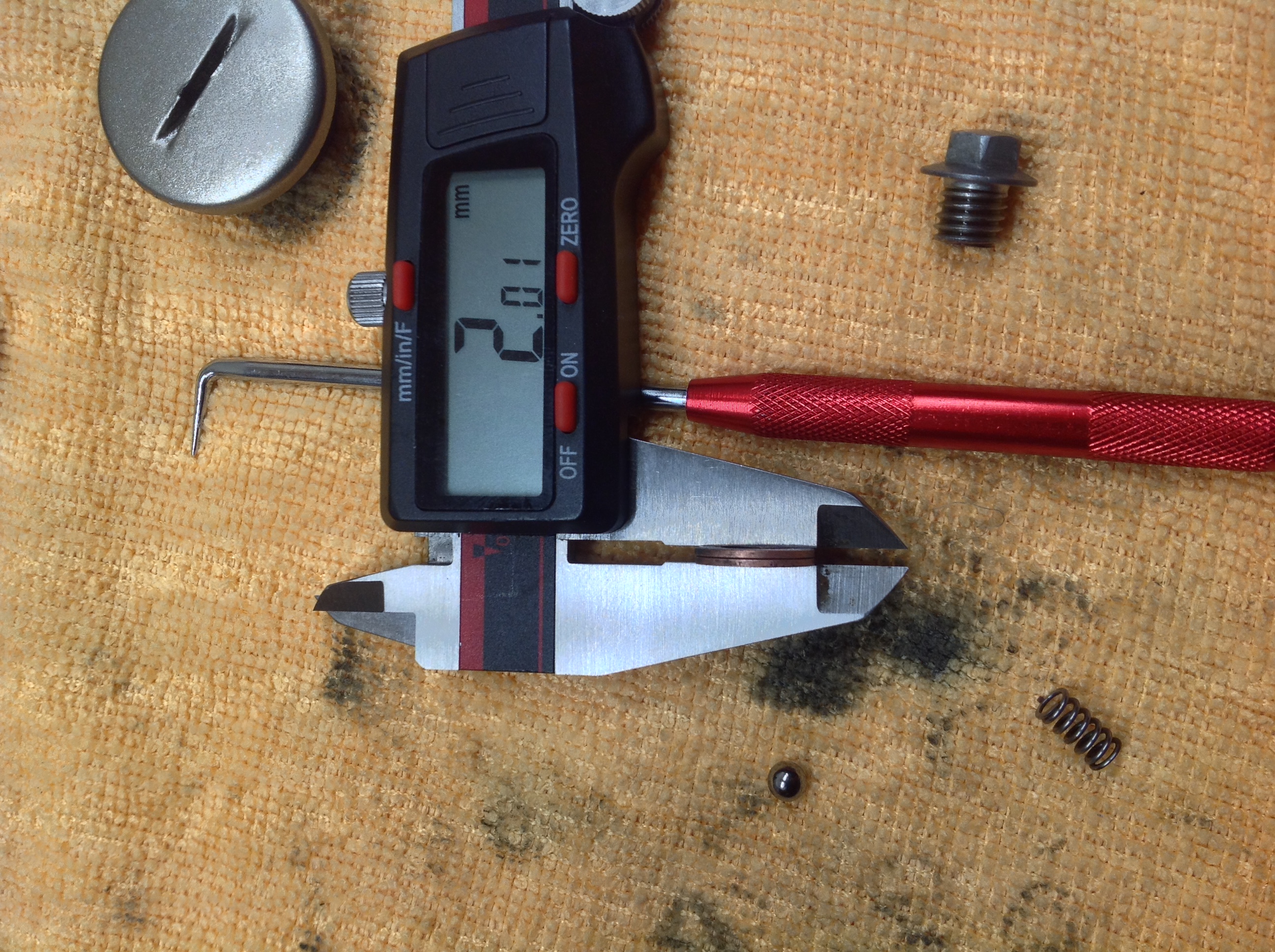

To you guys that know these bikes better.. How much tension should there be when actuating the kips valve? There's a definite break over force required to get past the detent ball in mine. The issue I have is that something is holding it open once it gets past the detent. I am see it start to ruturn, but it doesn't have the force to make the full return... I'm thinkin it's in the actuator arm somewhere.
tmosely1
Posts: 14
Joined: 04:50 pm Jan 28 2019
Re: Kdx220 stops increasing rpm at 1/2 throttle
Post by tmosely1 »
So the kips valve opening and rotational pressure is controlled by the detent ball and spring. Mine already has a pair of copper washers to shim it out. Is that oem correct?
tmosely1
Posts: 14
Re: Kdx220 stops increasing rpm at 1/2 throttle - kips issue
Post by tmosely1 »
Schematic and manual seem to confirm that is correct... Anyone have any idea what the oem thickness is? Possibly they have been over crushed and are providing too much drag?

I just did my 220 and mine has 2 washers. The detent definitely adds some initial resistance.
If your cylinder was just plated, the power valve rod bores can become really rough. I gently honed mine with a drill and some fine grit sandpaper, and this really smoothed things out.
