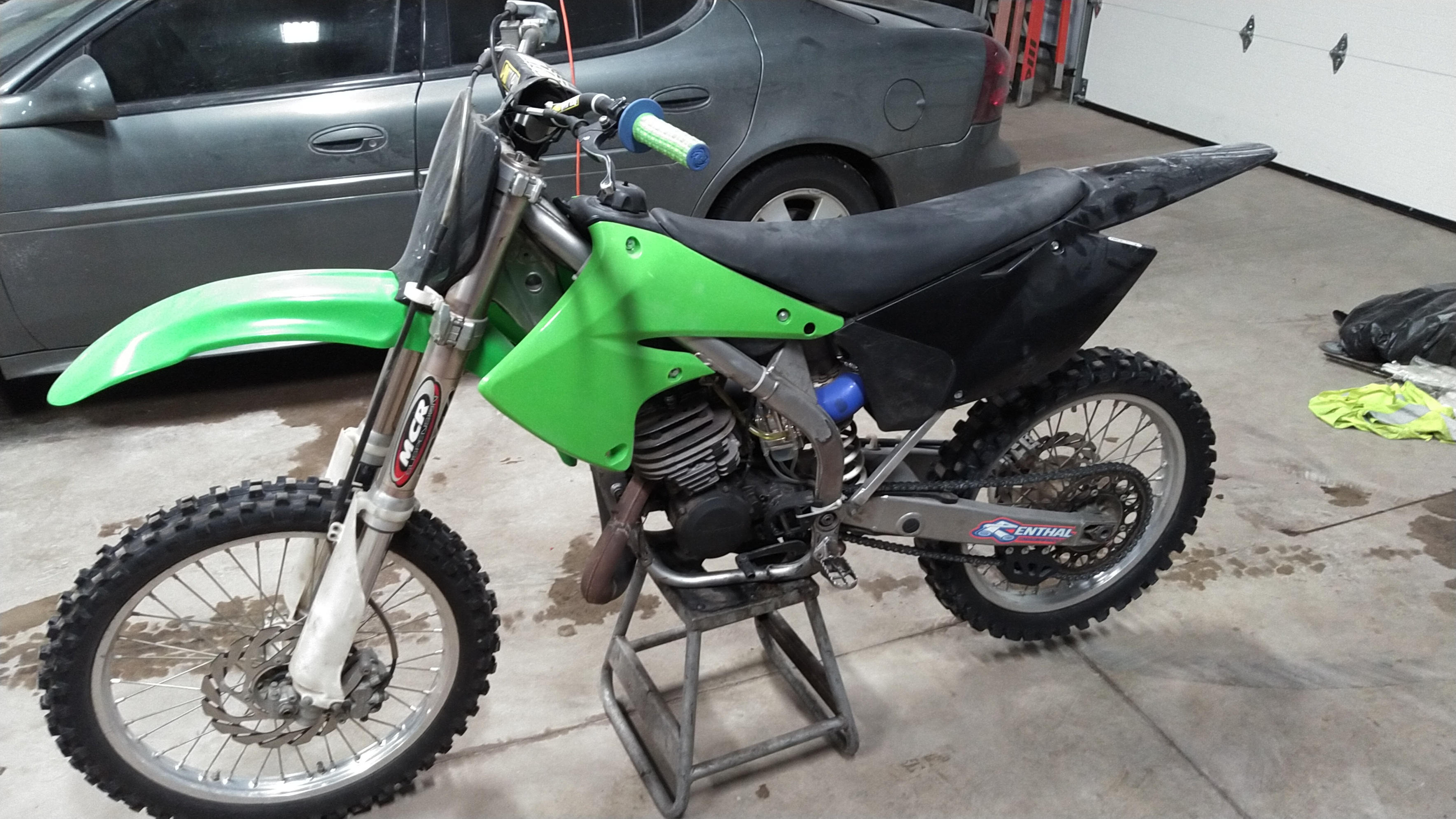

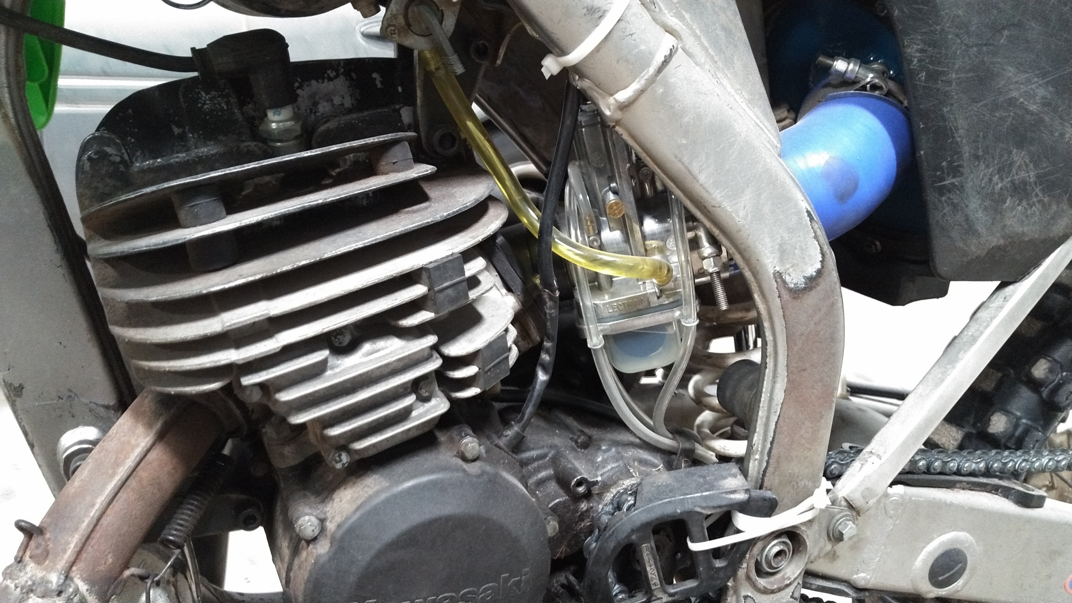

I am currently in the middle of a hybrid build. I'm putting an '86 Kdx200 into an '04 Kx250f.
Currently the engine is in the frame(full engine rebuild year and a half ago); having milled the shifter side case half, faced both swing arm baring sleeves, fabricated new top and front engine mounts (the mount locations were close enough that nothing was relocated only new mounts made), utilized v-force 3 reed cage assembly, a late model Kdx200 intake manifold, Lectron carburetor, air boot replacement consisting of 2.25" I.D. intake hose/flared tube welded to air box-backer plate.
Still to do is; finish the header (nearly done), mount the silencer(new DG)/fabricate and weld mounts to sub frame, fabricate and weld on lower engine mounts, turn support rod for radiator shroud

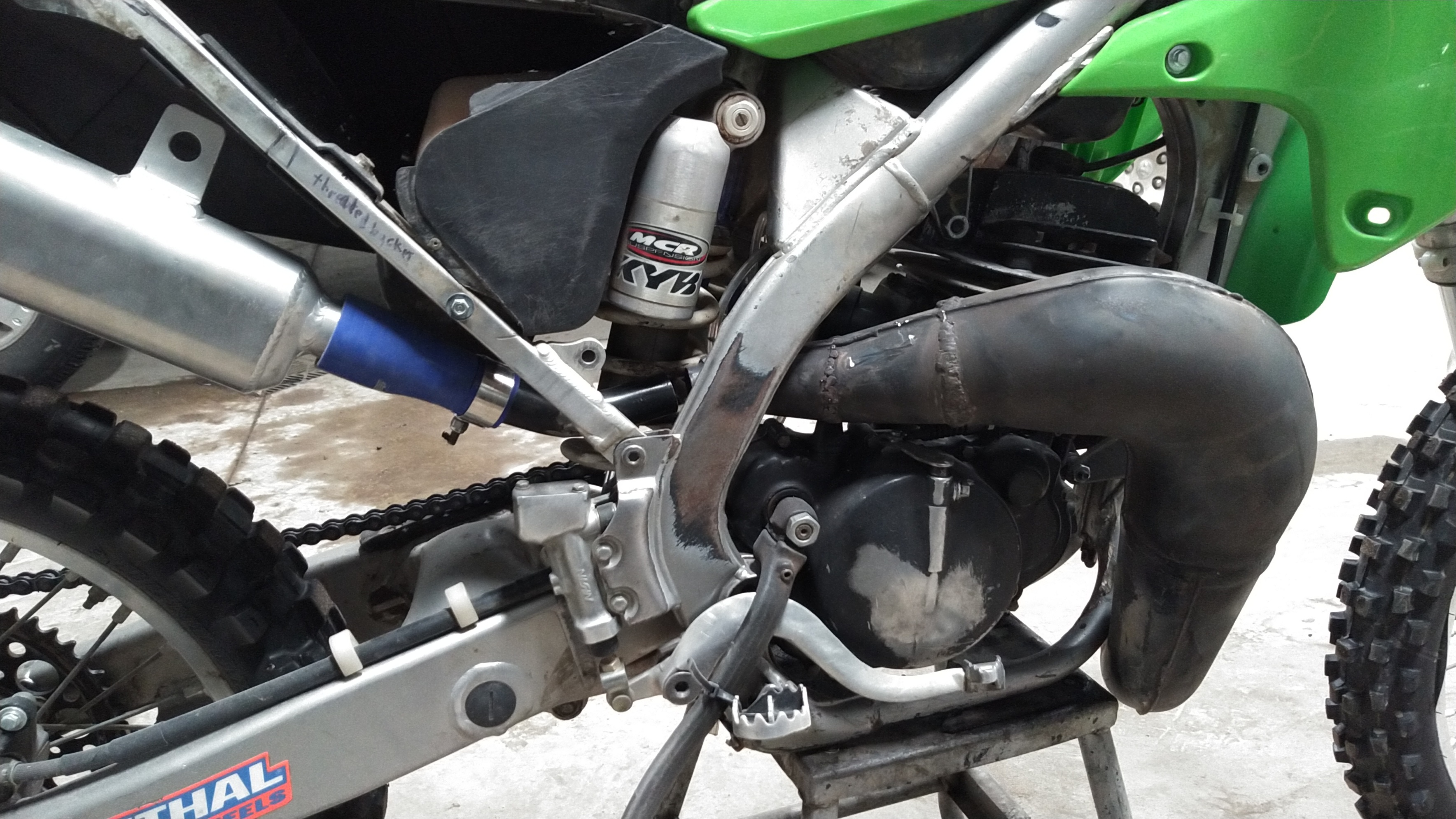

Today we did frinal assembly of the intake, and confirmed the drive train.
The air boot replacement came together perfectly, really tight to the frame and the shock but there's no rub. Chain was cut and tensioned.(I believe it was 117 link with the axle blocks ~2/3 of the way back) The clutch cable was good, throttle cable ran cleanly, the electrical hooked up and run in its final location.(the electrical has been cut back, no odometer - timer button - headlight/break light) Essentially the same electrical set up as the Kxf - series.(if I decide to add a head light I will add an externally charged battery supply due to the 6 volt system)
The header mounts were tack welded but the muffler is not mounted. It was mid 40's today but we had 18" of snow last week. There's now 3" of compressed snow on the back driveway, and almost a foot of heavy wet snow through the back yard and woods. The bike felt soooo balanced n light and slid out smooth and controlled on the corners. The snow on the back woods trails was soft like blow sand and heavy like wet sand. Unpassable for the first lap and doable in upper second gear for the second lap.(louder than $#!+, the neighbor heard it, came over and did some wheelies and kicker pop hops)
The gearing on both the Kdx and Kxf ran 48 tooth rear sprockets and there is a 50 on there right now. The gears feel so short, but it was awfully slick out. Going to wait for traction till I decide whether to change it or not.(the knobby on the rear has ~1/3 of its tread left)
The clutch worked well, I forget what brand.($50 eBay special, springs-plates-frictions) The clutch cable is a modified kx450f cable.(had a used one around and it had the length the others didn't) The new pads and rotors worked well despite no wear/break in and being packed with snow.(EBC sinterd pads and driven 'blade' rotors) the carburetor seemed ok but it hasn't been tweeted yet and the weather is a ways off from what I specified when ordering the Lectron.

Very loud, I have the muffler (DG straight through) but no spark arrestor. I'm thinking about grinding the exposed welds off the end off the muffler and welding a short piece of aluminum tube to the end. So I can use a slip over and clamp on(set screwed) spark arrestor.(ORV licenses are great, but if you're not abiding the rules you're still violating the law. Please if you're not riding leagaly, please do, the last thing we as a dirt riding community need is a reputation that makes it easy for the public to write us off as a bunch of unresoposible hoodlums, regardless of how close to the truth it is) :yawinkle:

Header is fabricated and mounted, the silencer is here but not mounted(no mounting points yet), and I have not purchased a spark arrestor yet.

I have now got the exhaust squared away, it's ready to ride.
Cosmetically the only remaining concern is the Kickstarter. At the moment it rests on the side of the frame where the very top of the boot settles. This is to avoid the expansion chamber which runs between the cylinder and the frame/Kickstarter.

Hay all,
I got the chance to ride the bike today. The first thing that I noticed was that the real power of this thing is loooow in the rpm's.(new tire Atrax-TG4 100-90x19) It then pulls smoothly through the mid and high rpm's. I am waiting for a day in the low 70's to dial in the carburator fully.
With the rear sprocket up two teeth(19" rear wheel) it feels like the gears are incredibly short, first is almost unusable.(~8mph screaming the engine) The top speed feels similar to the '86(?low to mid 60's?), however the ergonomics are vastly different.
The balance was awesome.(coming from the kx450f the weight felt noticably lower to the ground) We got a ready to ride weight of 220lbs.(weighed on works pallet scale) It is clearly in need of the suspension being resprung, although I am hesitant due to the redistribution of weight and how it may effect the spring rates.(I resprung the 450 two years ago and it has proved to be great in the woods using stock valves and 7wt oil instead of 5wt)
This bike is very nice as is and I think with minor adjustments can be made spectacular; carburator tweek, sprocket swap, bark busters (I tagged both pinkie fingers on trees today)
That's it for my preliminary assessment. I will try to keep this thread informed and up to date. Ride safe everyone.
