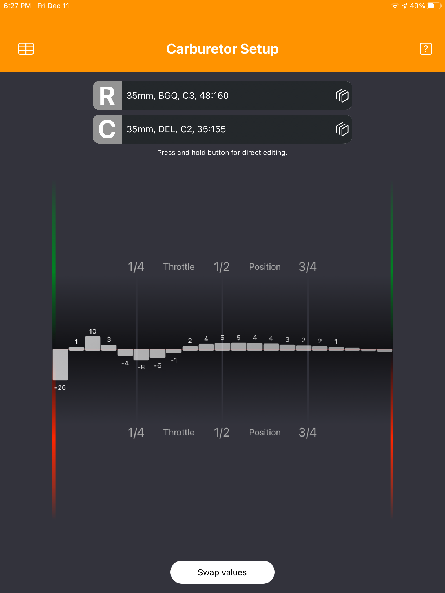

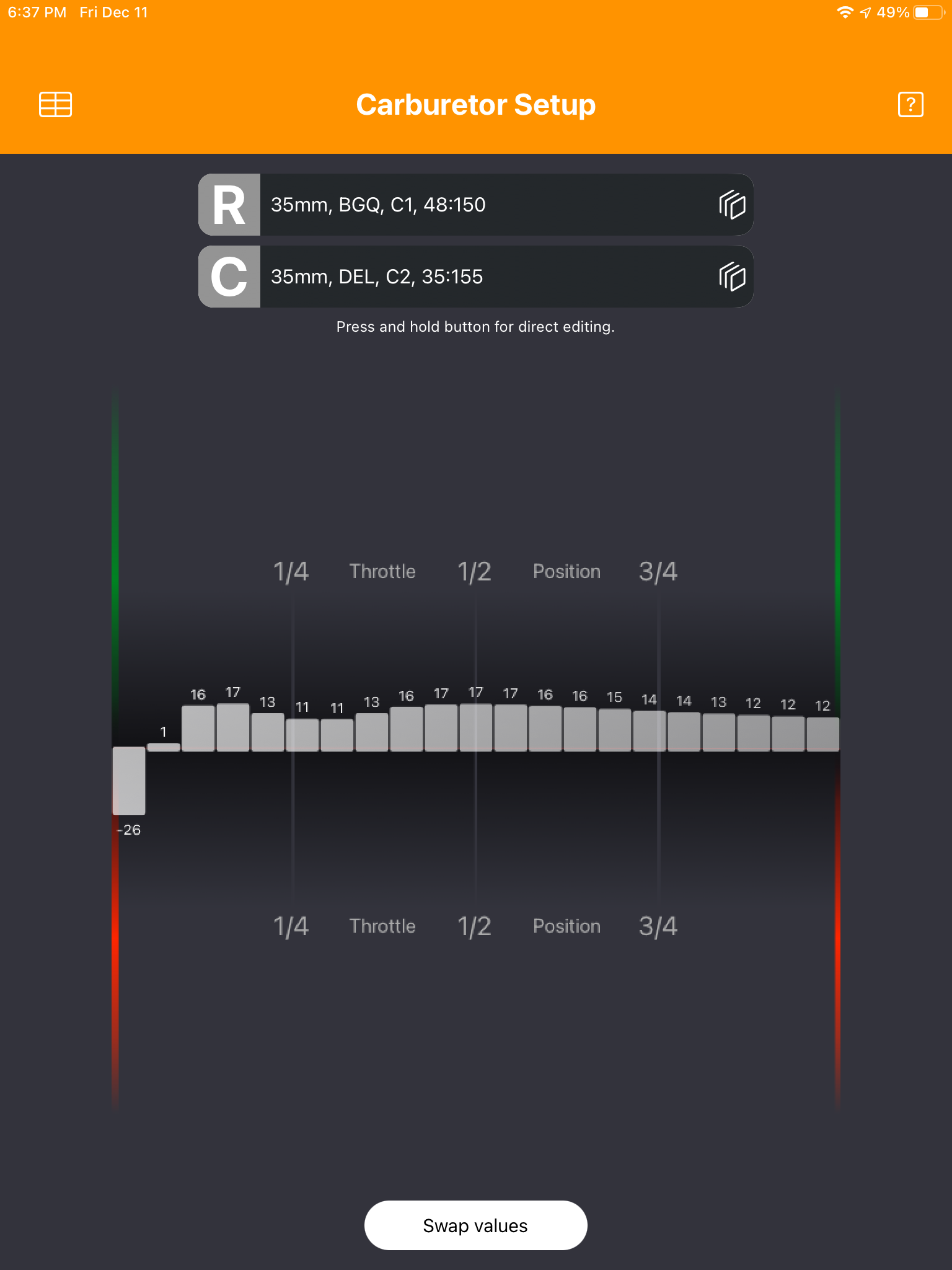

I used the kyajet app which was very useful to understand how tweaking each variable would change fuel flow at each throttle position. Everyone says how rich the stock jetting is, but really with the DEL needle, I’m mostly richer everywhere except idle and 1/4 than stock. I think that 5 slide causes lots of problems at idle?
And here is how the prior owner had it jetted and how much richer I have it. It spooged like crazy when I got it, now with richer jetting, much less spooge.
