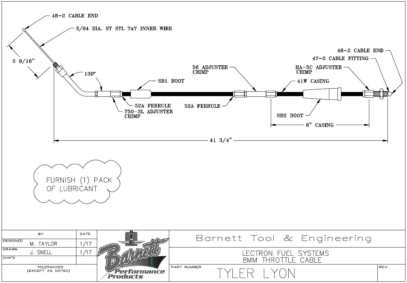

After thinking about it, I am going to order a custom cable from Barnett with the angled end on it, an adjuster, and shorter length. Also getting some different fuel line to try, a wide assortment of clamps, going to countersink the screw closest to the frame, and replace all of the phillips screws on that cap with socket heads (gotta love McMaster Carr!).

I spoke with Barnett's about another cable for it. Its no problem for them to make a cable with the same dims as the I got, but with 1/2" longer casing (cable will protrude 1/2" less), an inline adjuster, and a 130 degree fitting on the carb side. Waiting till I get back from this work trip and I will double check my 1/2" cable length estimation and I'll order it.

Yep, I ordered the following "custom" cable from Barnett. Basically the same as stock, but with an additional adjuster, 1/2" or additional casing, and an angled connector on the carb side. Works like a charm. The inner wire of the stock cable is definitely too long, it will only get worse as it wears. I think I paid around $55-60 bucks for this
