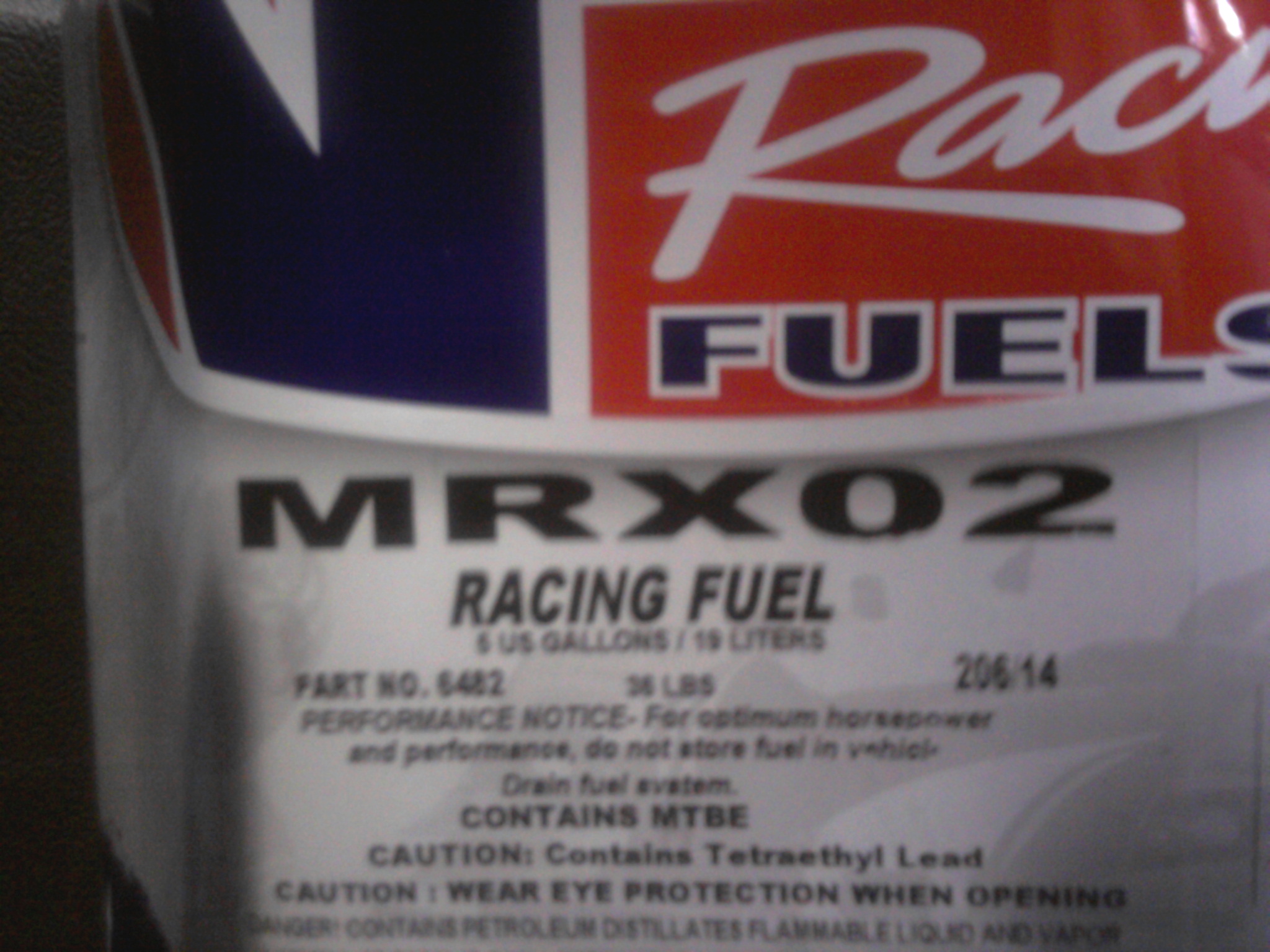

Down the line I might consider having the cylinder ported. Probably have the head cut ASAP as well for more compression. I am in the habit of only running high octane anyway for the extra additives. Might even start buying Sunoco or VP Race fuels.

Hopefully, you can keep both.
I think it requires four brackets. I looked at mine years ago. I think there was the swingarm caliper mount hanger, bracket for rear brake pedal spring holder, rear master cylinder holder and maybe one for a pedal stop??
I DID NOT ride it, but I swapped my E wheel onto my '87. I used a 3 mm washer either from a C or E. I am not 100% sure on alignment, as this was at least 12 years ago. I never got around to a conversion, but going to E stuff did not look too tough back then.
Get the bike in the garage before you go shopping in your head. :-) Some parts are hard to find or NOT cheap.
Company bonus money well spent (pic below) :lol:
