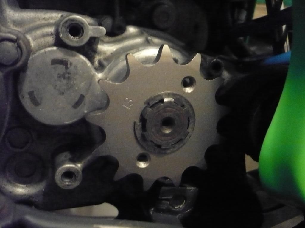

Got a few more goodies for the bike today.
- Chain
- Front sprocket
- Frame guards
- Rear tire
"General street use"....uhh woops?
Kenda Trakmaster K760..Anybody use them??
UFO frame guards from FRP. Look kind of dumb on the black frame but meh
