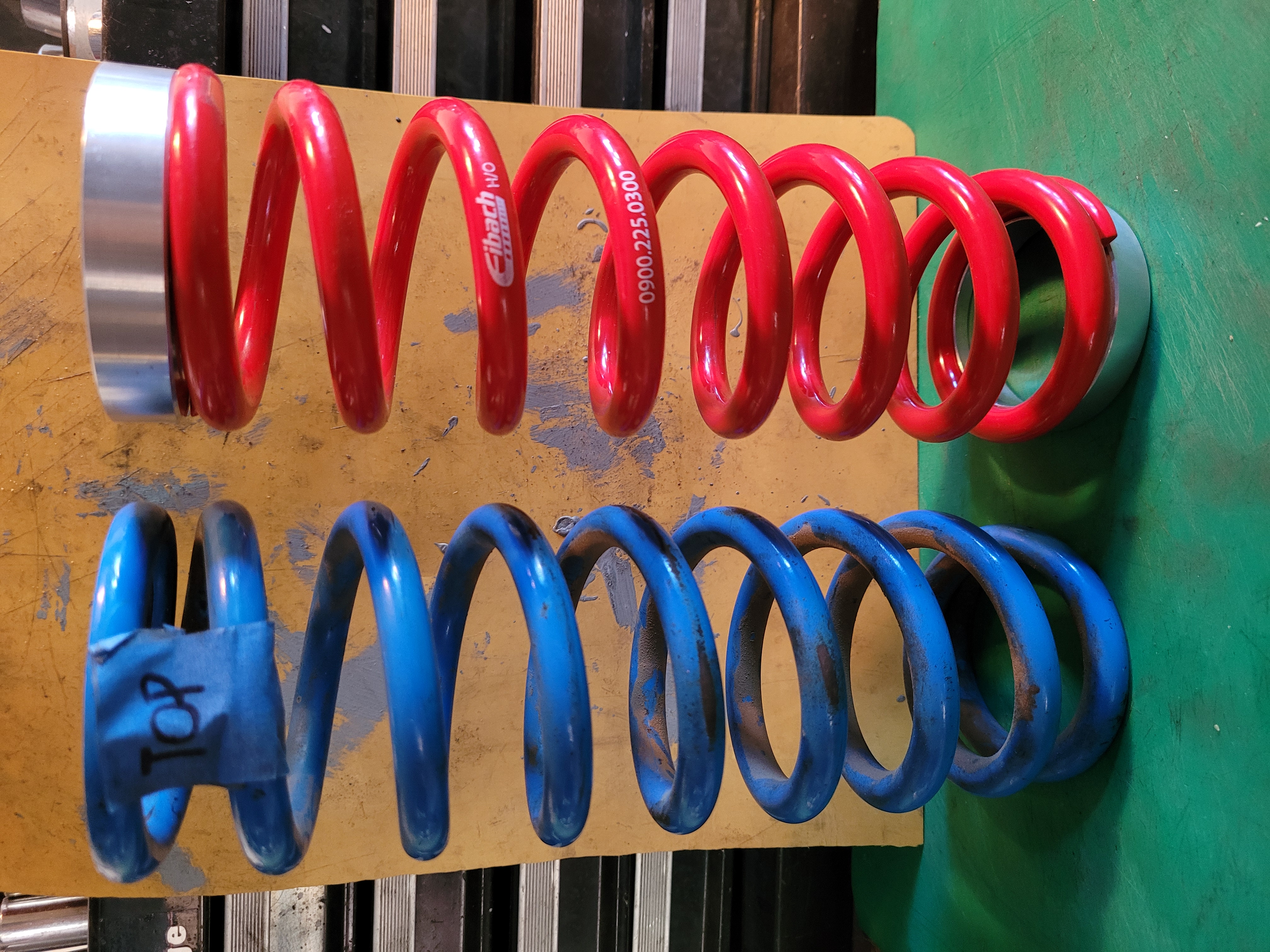

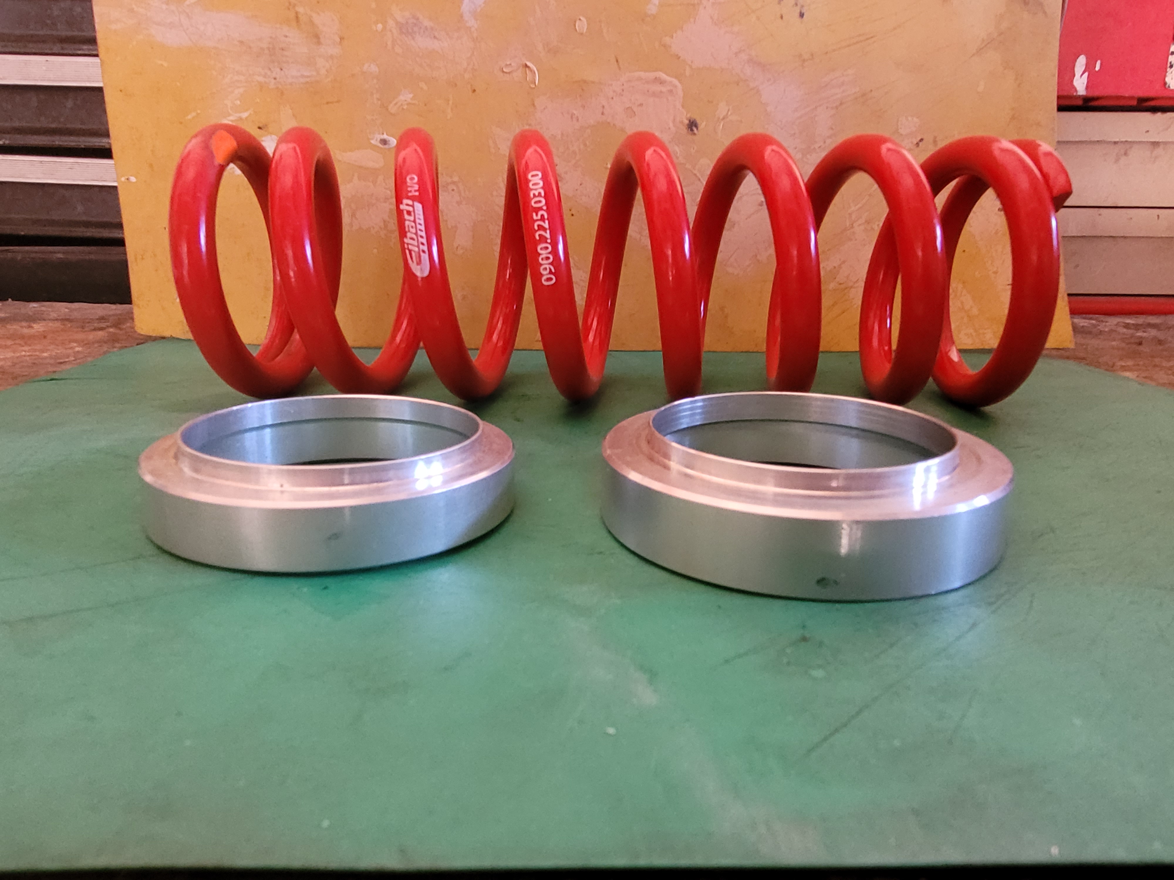

Rideinredneck:
if you discover your new and any future rear shock springs have inner diameters greater than the stock shock spring seat outer diameters, then see the aluminum collars Race Tech made for me (photo). These collars allowed me to use the red spring Race Tech selected for me (rider weight, riding terrain & style, and stroke shortening). This red spring is straight rate (e.g, not progressive). I think it's rated at 5.0 kg 5.3 kg/mm. (will check records). Of course, if your new spring is same or near same length as OE spring, then collars you use would be thinner..
The collars are also spacers needed to assure frame geometry remained unchanged using the shorter red spring. Here's a photo of the blue OE spring and red aftermarket spring with collars.
- 2-Collars.jpg (1.96 MiB) Viewed 11429 times
- 4-Springs.jpg (4.12 MiB) Viewed 11429 times
