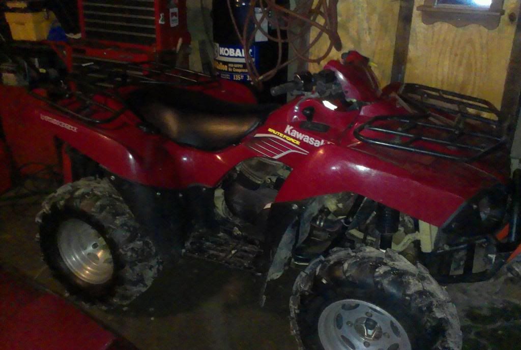

05 Kawasaki Brute Force 650
Post by ICRage42 »
Uploaded with ImageShack.us
Got it muddy after running through the levels and whatnot. Gonna give it a good rundown and cleaning. Had it down the road a bit and well it attracted some attention from other atv riders on the block.
An 09 polaris (biggun not sure what size), a yamaha 450 also like new, guy farther down road has a ltz400 and my neighbor to the rear with two honda 400exs. Everyone LOVES the new Kawi.

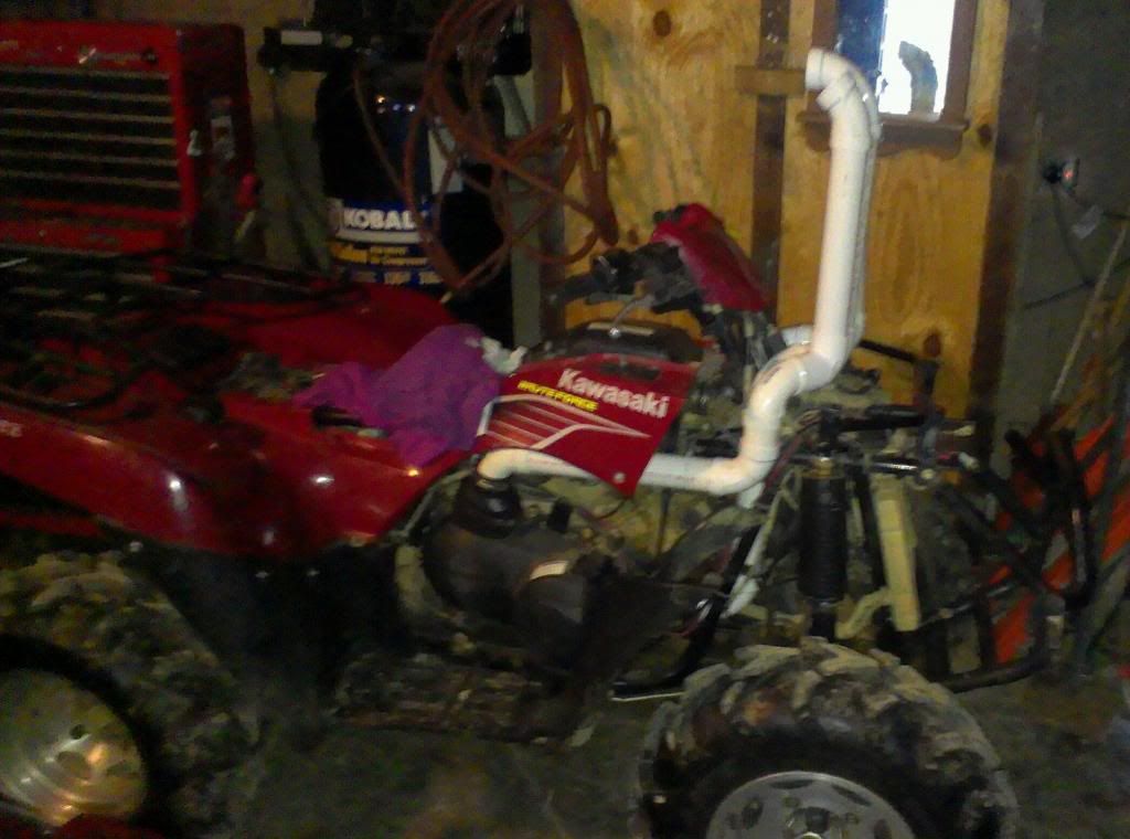

Here is with 2 in lift installed and about to take front clip off to do a snorkel and radiator relocate kit on it. (just gonna weld one up I cant see paying someone 150 bucks for two brackets and some hose)
took a quick pick of snorkels. Not really going boating with it ....its just the dam choke cables Ive had nothing but problems with them. Theres two that connect to one and two plungers that move in or out for choke. The dam things always stick and cause problems I took the carb apart many times trying to correct. Now to choke I just muffle the snorkel a bit till she gets going. Why Kawi designed it like this is beyond me.
