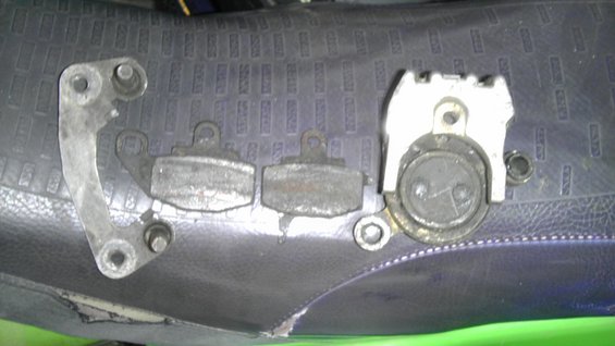

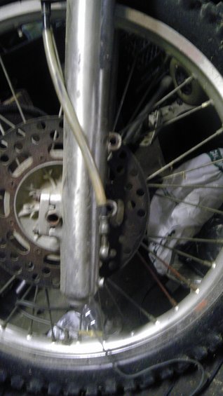

I have been having trouble getting the correct parts for my KDX front brake I called a used bike dealer here close to me and I got down there and what he had and what i had are two completely different. this thing just doesn't look right has anyone got any ideas on what I have.

Not KDX forks / brakes?

Time for a KX fork swap. :wink: Other than that, no.

Yeah, that pic shows something other than '89-'92 forks. How about a pic of the whole bike?

I think I figured it out I started typing like other bikes like suzuki and yamaha I then typed in 91klr and the first pictur on the page on ebay was the exact same brake pad. KAWASAKI KL650 87-07 KLR650 06 KX125 KX250 KX500 87-88
http://www.ebay.com/itm/FRONT-BRAKE-PAD ... 125wt_1163

I wondered why This one was taller than the old one. I fell over the first time i tried to stradle it the guys wife got a good laugh anyway :oops:

I ran into the same problem with my '87 KDX. At some point in its past, the left fork got replaced with an early/mid '80s KX fork. The PO put a little steel spacer on so that the KDX caliper would mount to the wider bosses on the fork leg. My motorcycle OCD couldn't handle this, so I bought a cheapie set of used KDX forks to put it right. $50 shipped rings a bell.

I'm going to buy a new/used in good condition caliper for it since the old one is missing parts and looks like it has been beat on a little. The forks don't look to bad for wear and tear of I can find a while system from a 87-88 KX I will just get that instead.
