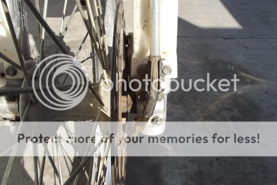

scheckaet wrote:maybe I missed something but have you tried removing the axle nut 1st then loosen the pinch clamp?
Strangley enough, the axle nut on the KX500 wheel is located inside the left fork, and held in place by the fork clamp, as shown in the following photograph.
Spud :grin:
98 KDX 220, 05 Honda XR650L, 06 Zongshen 200GY-2

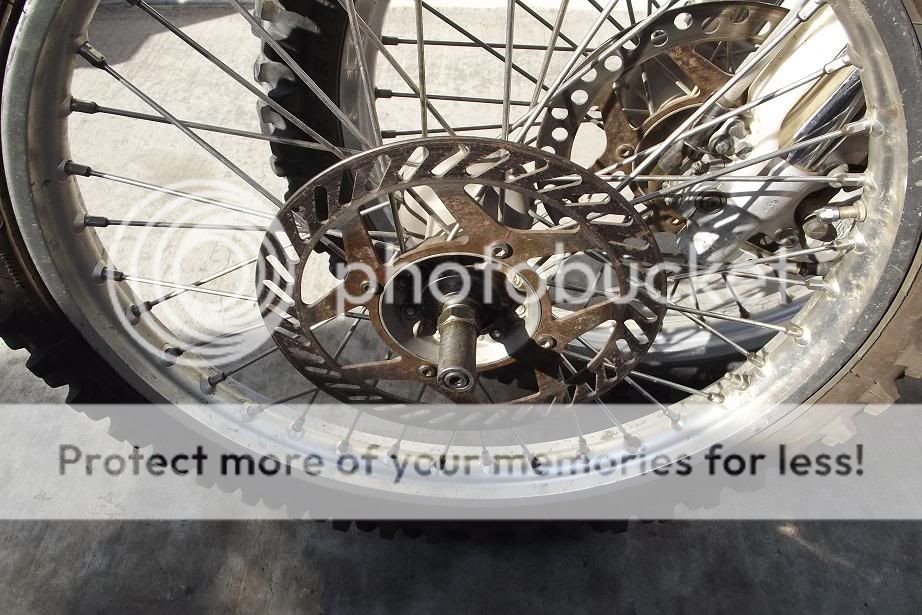

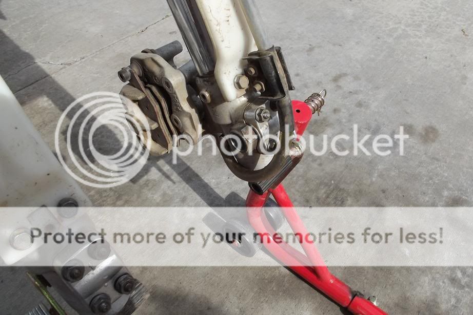

SpudRider
Posts: 24
Joined: 11:33 pm Sep 04 2011
Location: Idaho
Post by SpudRider »
Thank you so much for your help, Marrk. :grin: As you can see in the following photograph, I got the KX500 front wheel removed from my bike using the method you described. :wink:
I still need to "persuade" the axle out of my spare, KX500, front wheel shown in the photograph below. :roll:
However, thanks to you, I am in good shape, since the axle, and the axle nut currently installed on my bike are in good condition. :mrgreen: I needed to remove the front wheel to install a replacement brake rotor, shown in the next photograph.
Spud :grin:

scheckaet
Posts: 3740
Joined: 12:09 am Nov 10 2005
Location: edmond oklahoma
Post by scheckaet »
makes sense now that I see the pic. wondering what kawi was thinking when they built that bike...
gsa102
Posts: 453
Joined: 12:33 pm Aug 16 2011
Location: PA
Post by gsa102 »
That is early 90's tech. Preload the bearings, then clamp the axle to the forks. Probably to reduce stiction. And tough to get apart. Same as the CRs.
