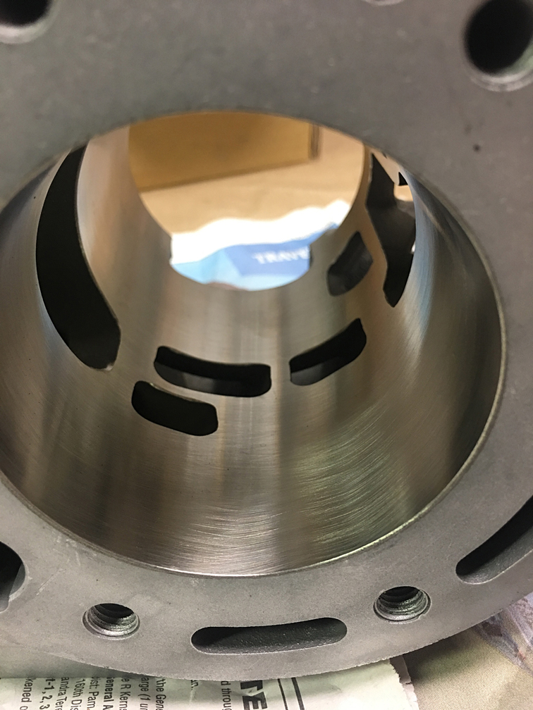

My cylinder was done the following week and I just got it back from PowerSeal. Little bit over 3 weeks. Im happy with what they did and what I paid. Customer service was great too. Heres a pic for you kawi-nuts. Stoked to have an almost new engine soon!

HECK YEAH!!! That looks awesome. Donn't forget all the cleaning steps.
