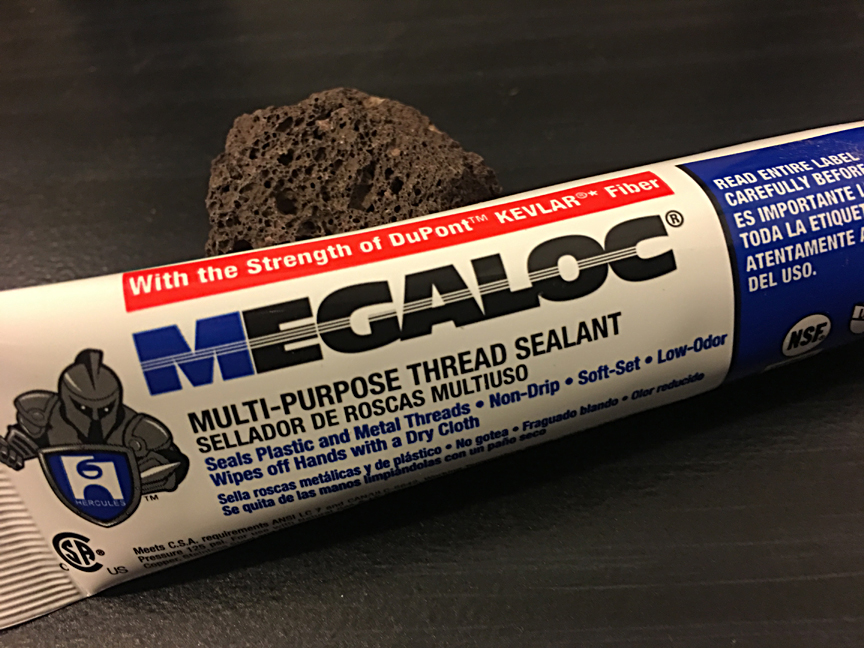

What kind of sealant did you use for your coolant plug?

Haven’t got to that point. I was thinking a generous amount of blue loctite. Maybe I need to do a little research on it. What are you thinking?

I ended up just using blue locktite and it's held fine. I had used a ptfe pipe joint compound that was appropriate for that application and it leaked.

Vossman wrote: 07:37 pm Feb 25 2019
I found this stuff in Home Depot for $2.71. Got some Blue Loctite for the studs too. I figure I wont have to deal with the plug for a while so might as well snug it up tight.
ericr: I ran out of blue and was going to use that until I found this stuff.
