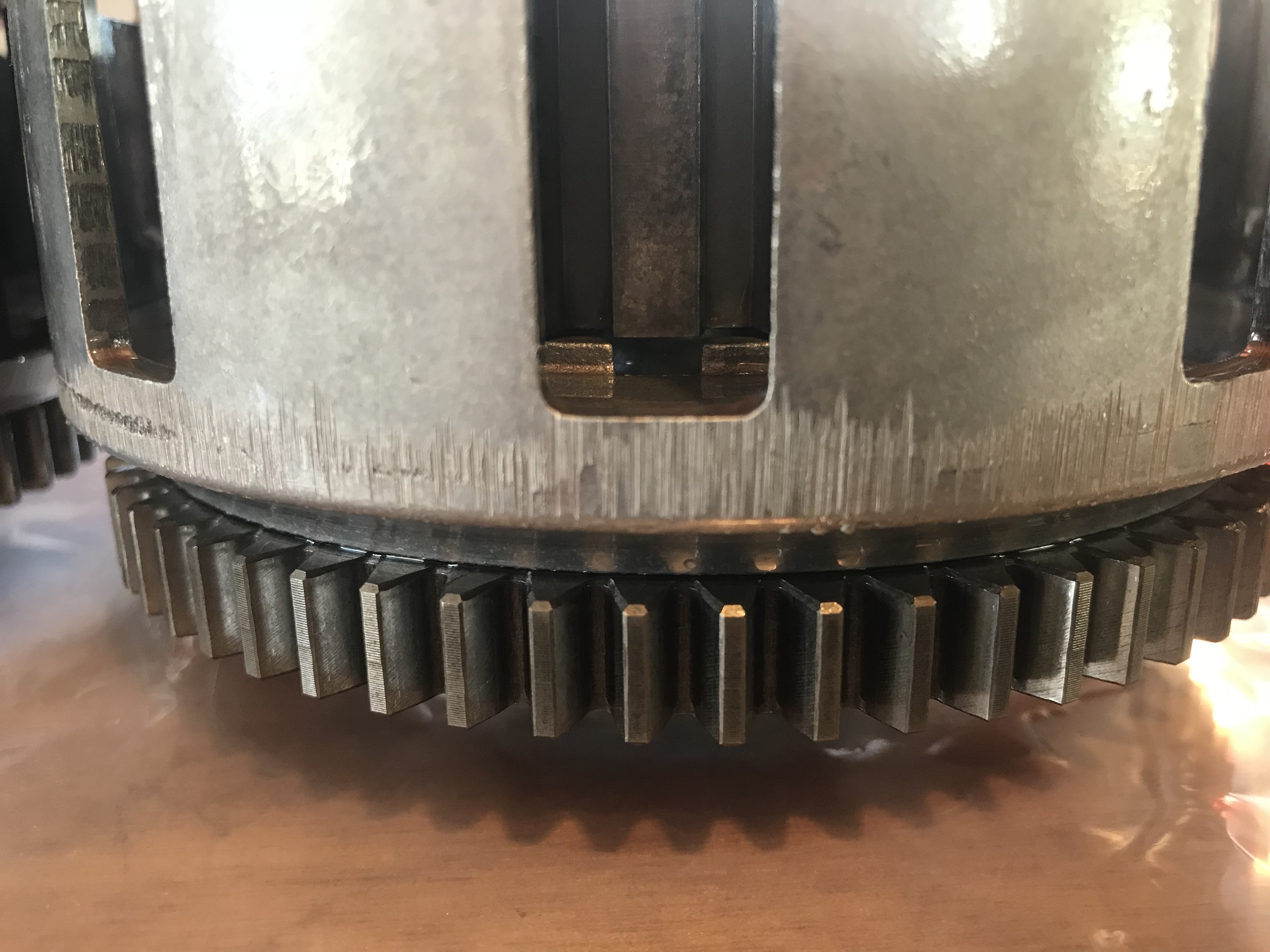

Is this what you’re referring to as gouges on the clutch basket? If so, that’s completely normal and comes that way from the factory.

G22inSC wrote: 04:17 pm Nov 07 2020 Is this what you’re referring to as gouges on the clutch basket? If so, that’s completely normal and comes that way from the factory. 9E932D2B-D7C8-41F5-8A24-ED586D5C6A51.jpeg
no about halfway up the basket there's a ring all the way around where that pin would catch between the case and clutch cover and gouge the splines. I ordered a new basket too because a couple of them are almost halfway eaten through. shame because that basket looked brand new.
