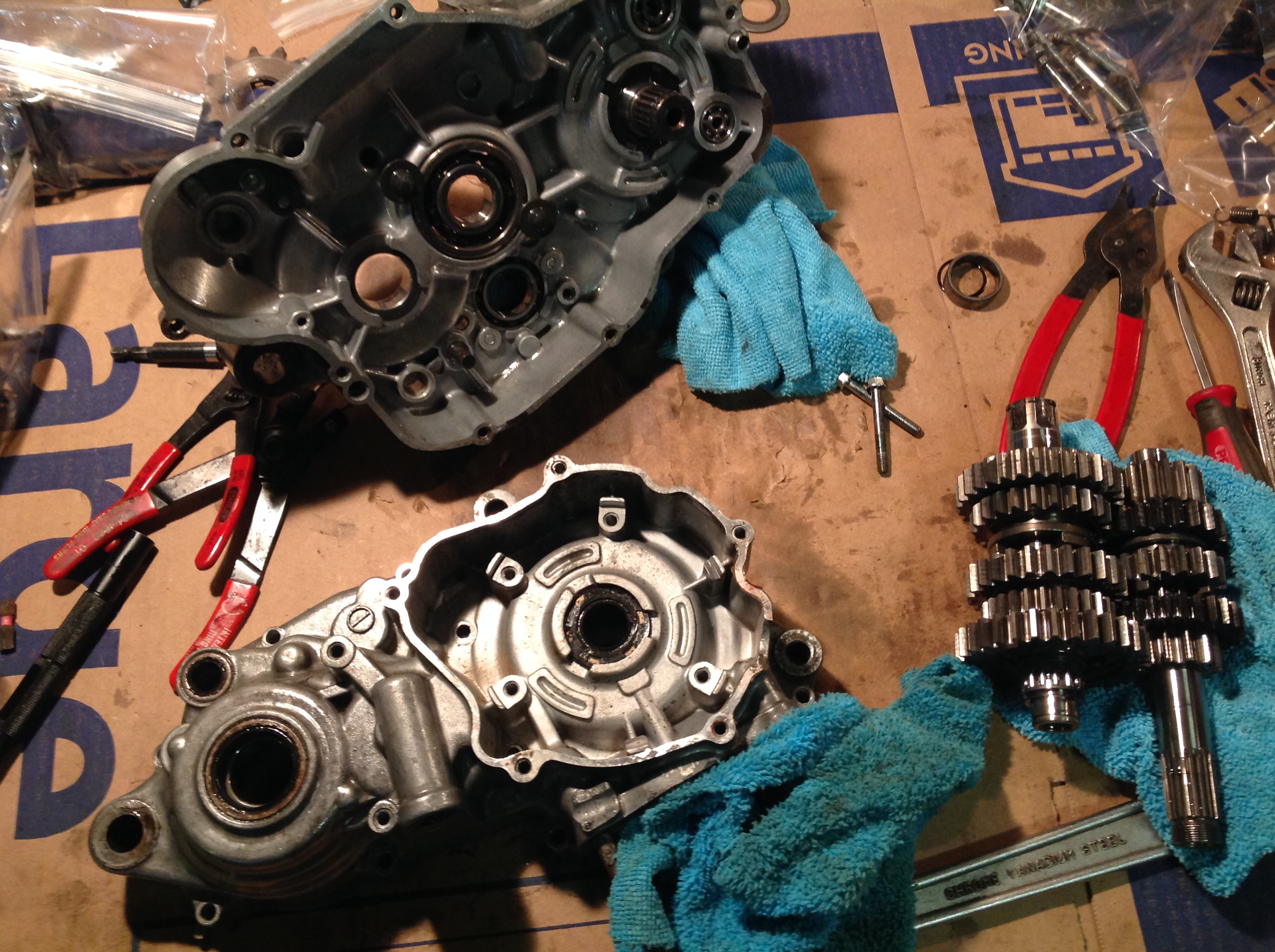

Case came apart pretty easy, was my first one, only tools I needed was a crowbar, big hammer, oxy-ace torch.
That's what the previous owner was telling his buddies I think, not sure. All kidding aside, the 50$ puller tool on ebay worked good, cases came right apart, bearing stayed in the case.
I found it easiest to just find your appropriate socket slightly smaller then case flange on seal side, and just press the seal and bearing out together. I always add a little heat just to help things press smoothly. Don't bother with trying to punch out the bearing first through the seal.
Don't mind the china crescent wrenches :wink: I actually use them as a cheap dial indicator, to check out of round shaft ends with light, quick way to see if they need more inspection.

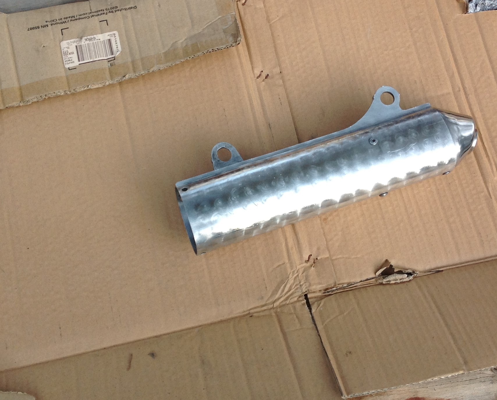

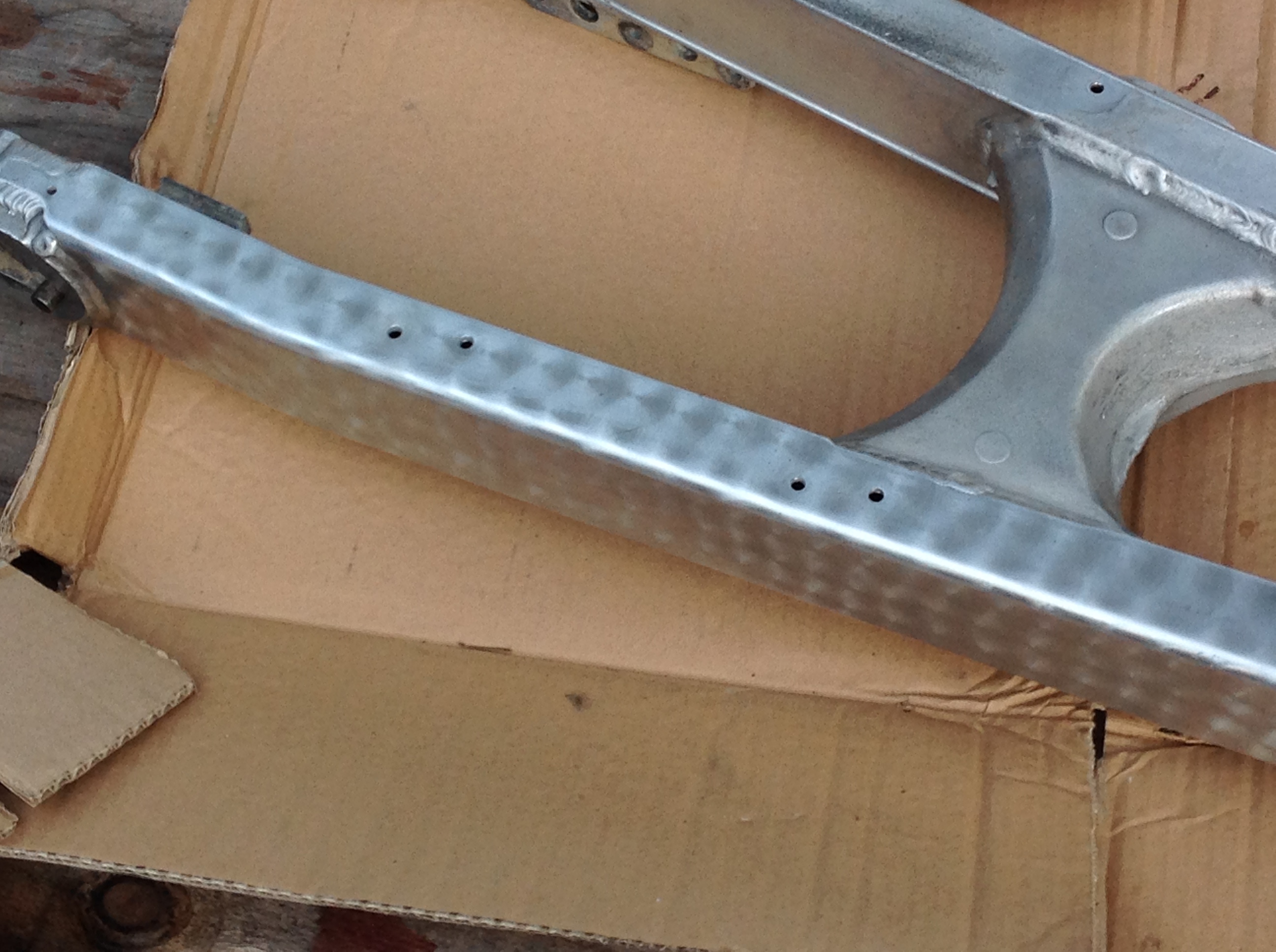

Sprucing up some other stuff while I wait for re-plate and bearings to come in.. figured i'd try a poor mans "jeweling" to see how it looks... not too bad.. I thought if it looked good enough, I would spend some time and re-do it properly... what you think?
'91 KDX 250 D1
Re: '91 KDX 250 Build thread, all advice, tips, criticism welcome
Congrats on the work.
I have never seen such a polishing technique before. It looks pretty good. I like the swingarm better than the silencer.

I agree I don't like it as much on the silencer, and it didn't take as well as the swing arm did. think I will just polish out the silencer. Ill post up some more pictures of it, easily done if you like it. You can do it to anything metal..

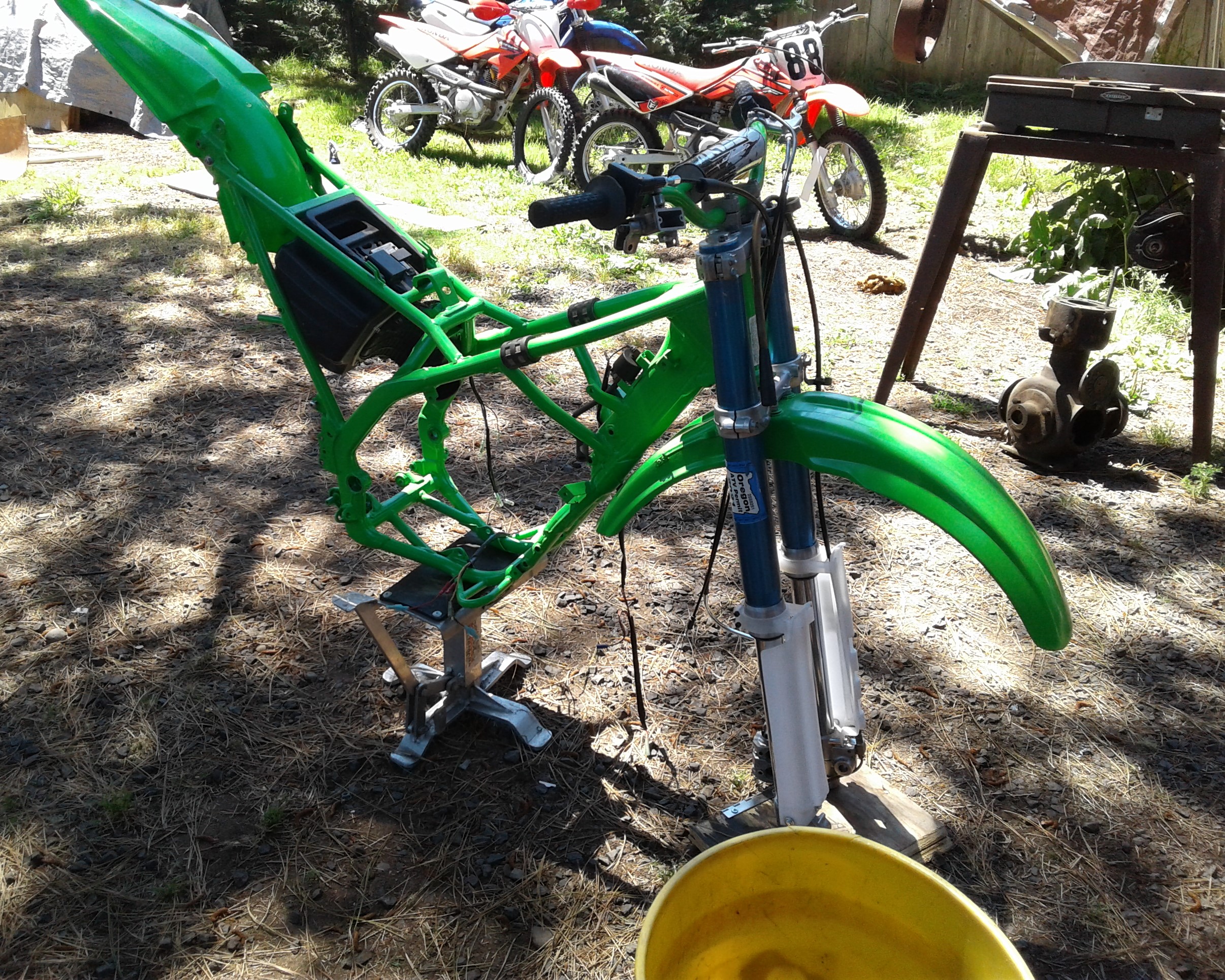

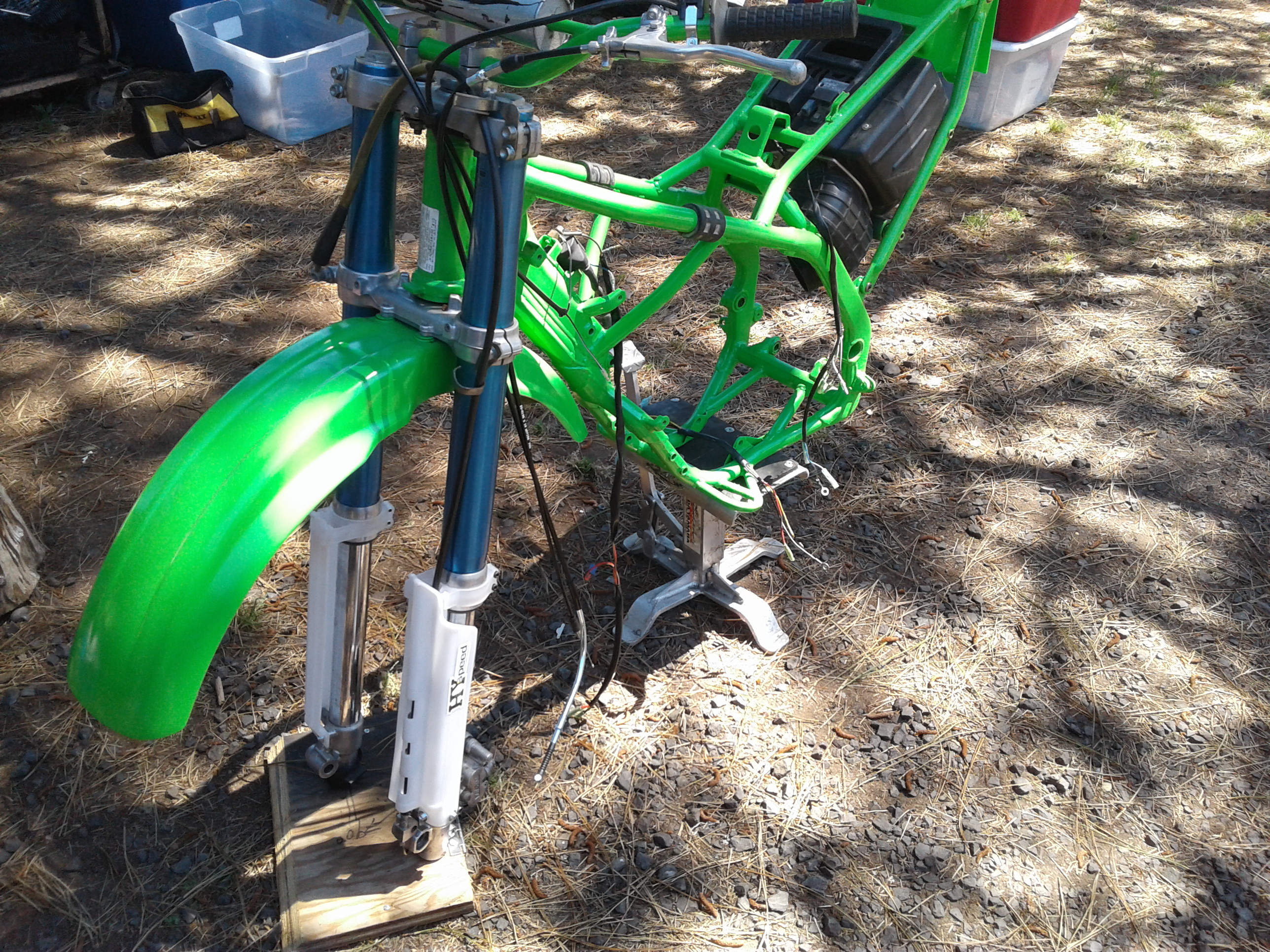

Got the frame painted. Rebuilt the forks, stem bearings. Fixed the airbox, and fitted a newer KX fender, looks good I think.

Looks better than good to me! I love lime green, so I may be biased a touch.

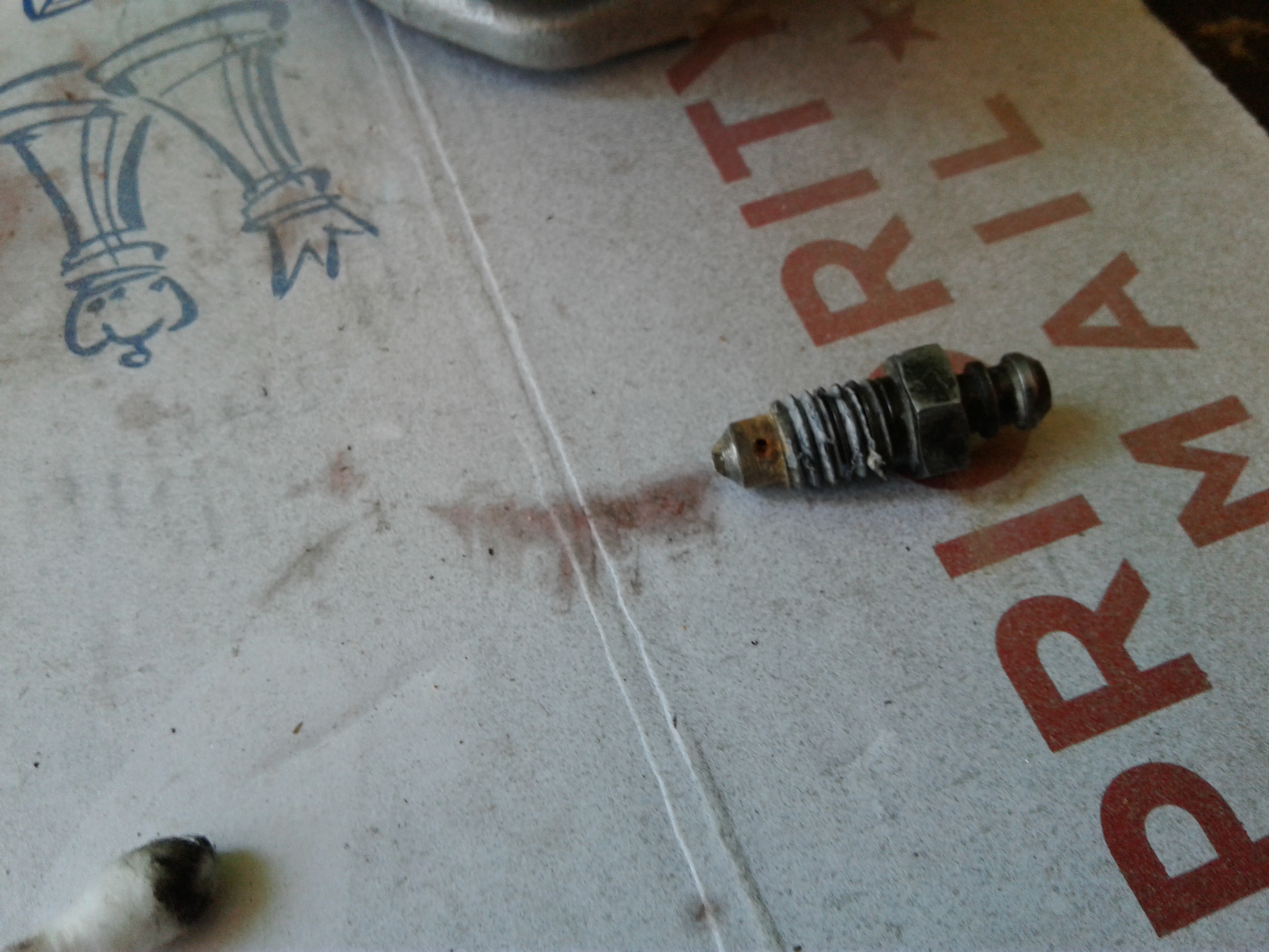

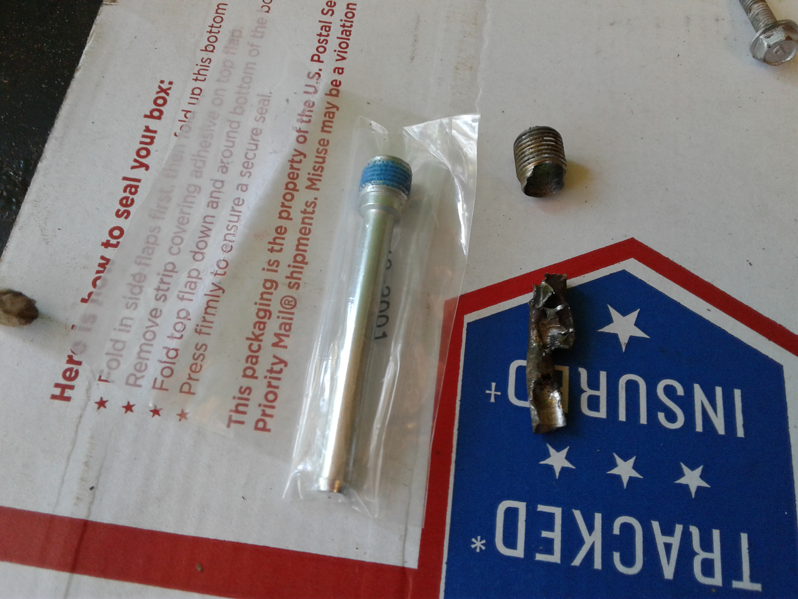

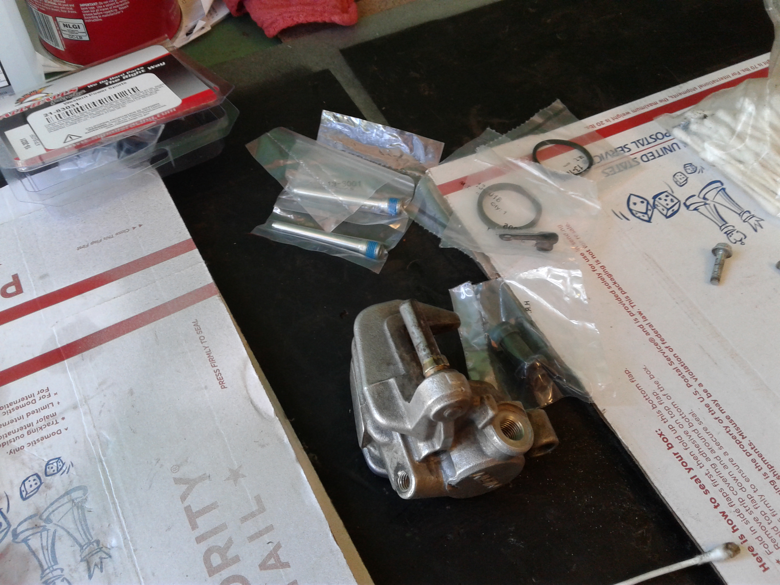

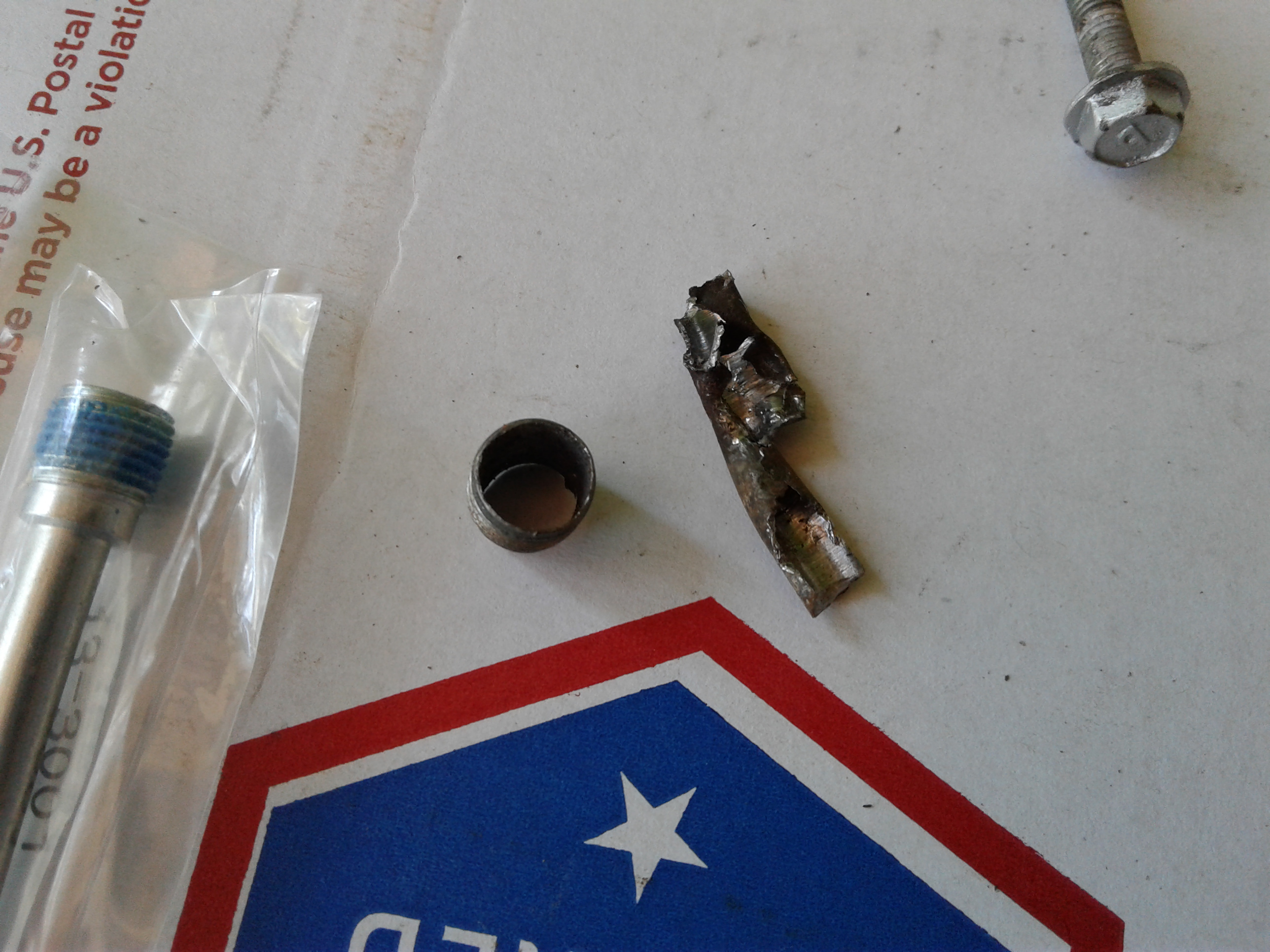

Brake calipers needed rebuilding. The front went smooth, the rear was a real treat.
'91 KDX 250 D1

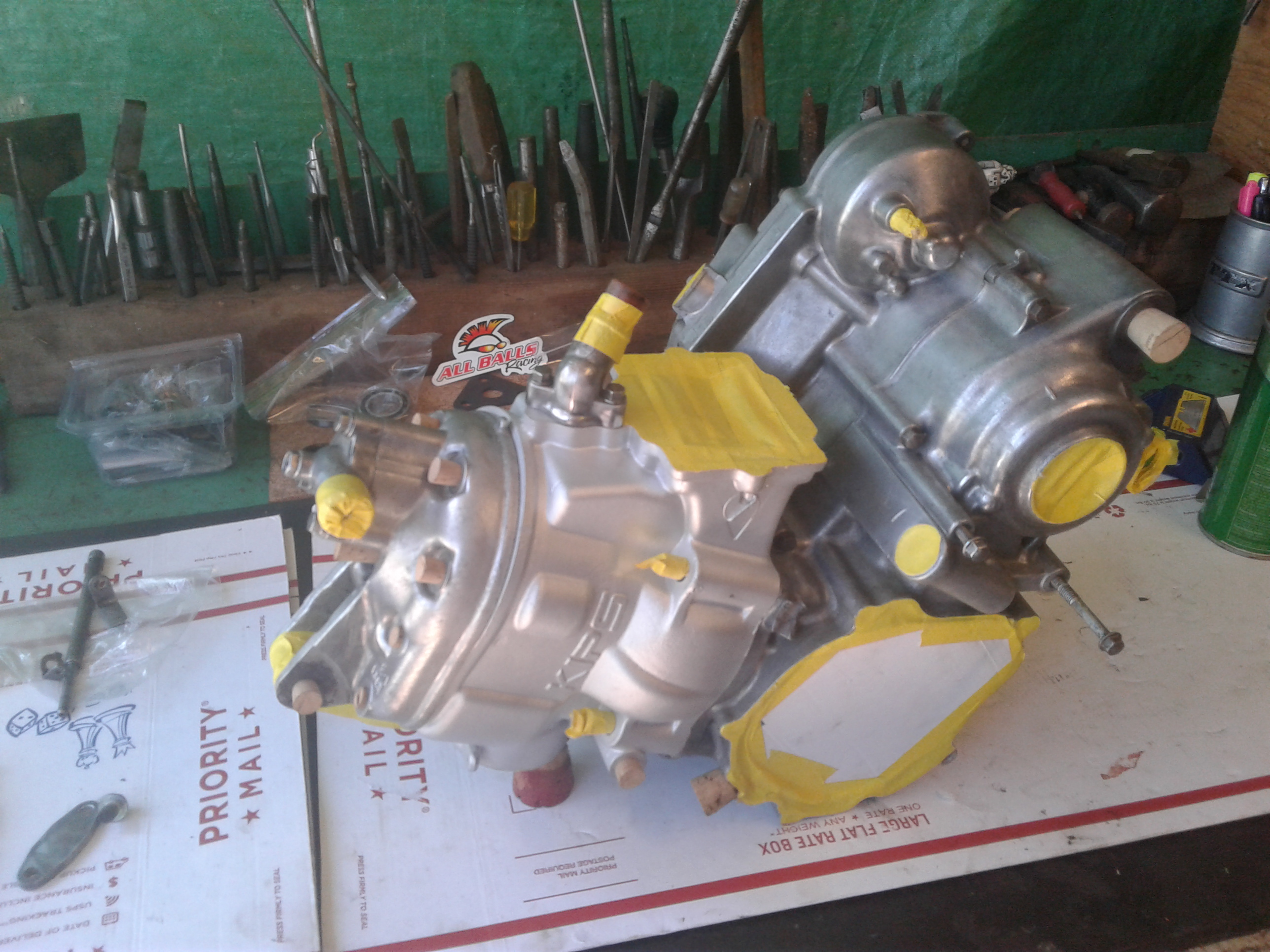

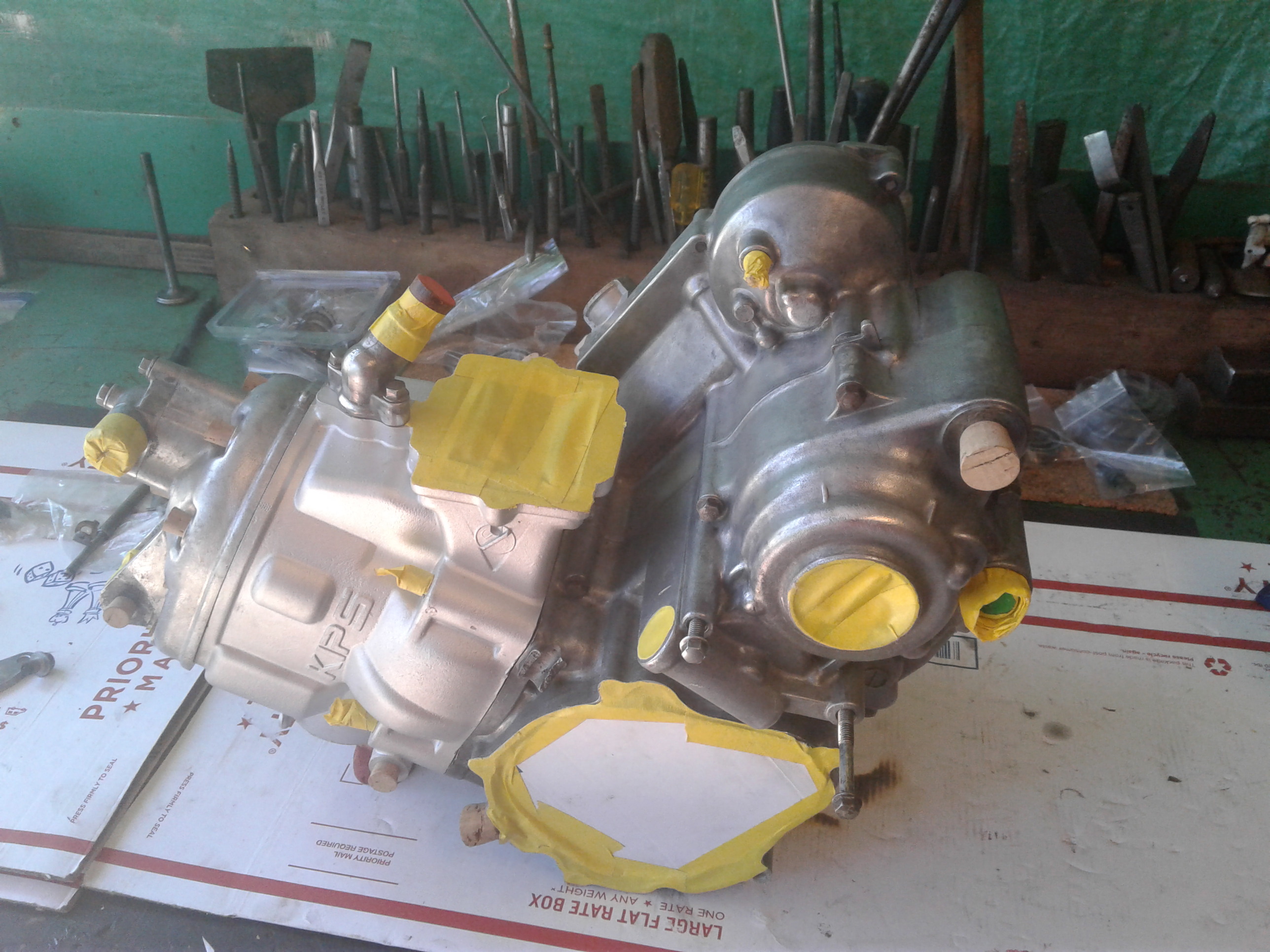

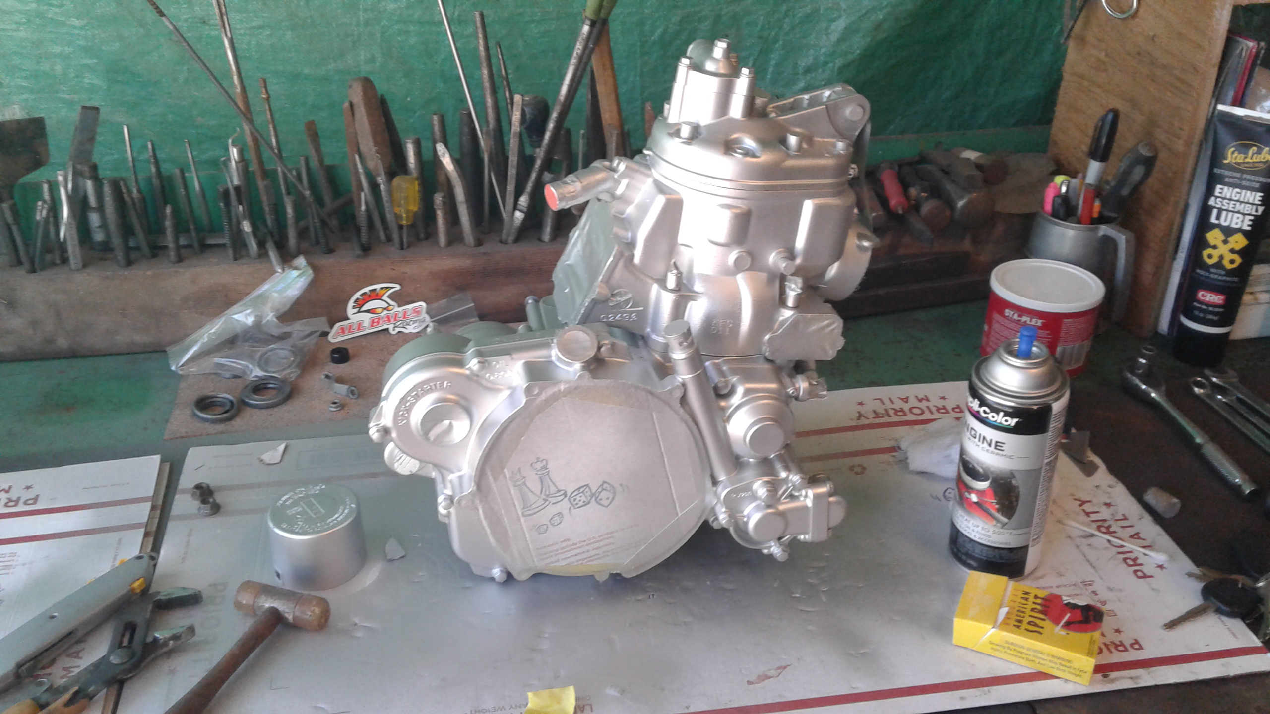

Well, I guess I decided to paint it. I know it will look bad soon, but I dont like the super polished aluminum and the engine looked like it was made from 4 different bikes, so at least it will begin to look all bad in a uniform matter :roll:
Let the masking and corking begin.
Used Duplicolor Ceramic Engine paint, its almost an exact match to the bead blasted jug from millennium.
Of course my case has the stupid broken clutch cable mount, but I have a custom bracket for it.

Oh geeze why did I paint it, lol now it looks like I should just put thing thing on the shelf with a little light above it.... :neutral:
It turned out good, but yeah, pretty much putting lipstick on a pig....

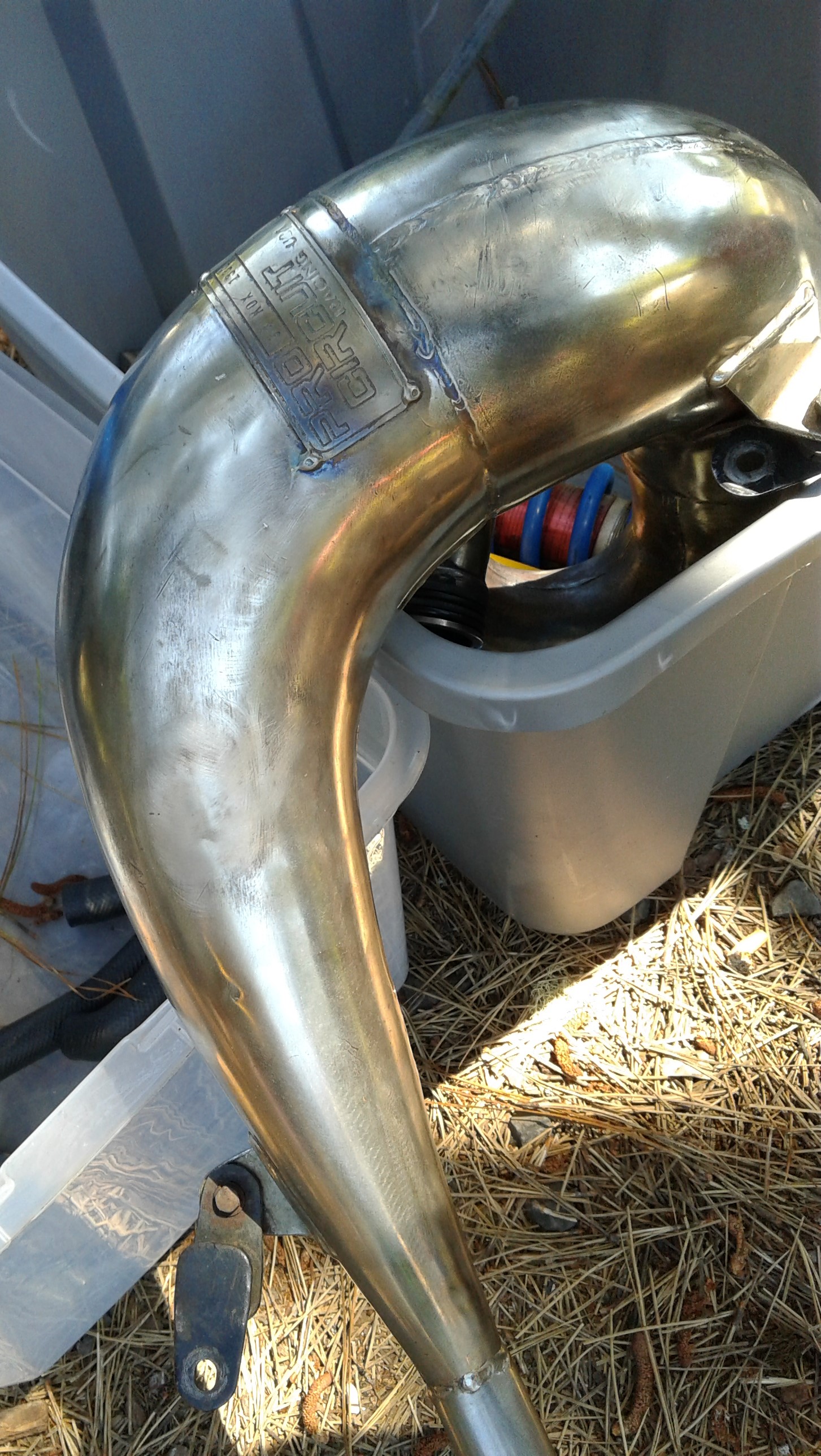

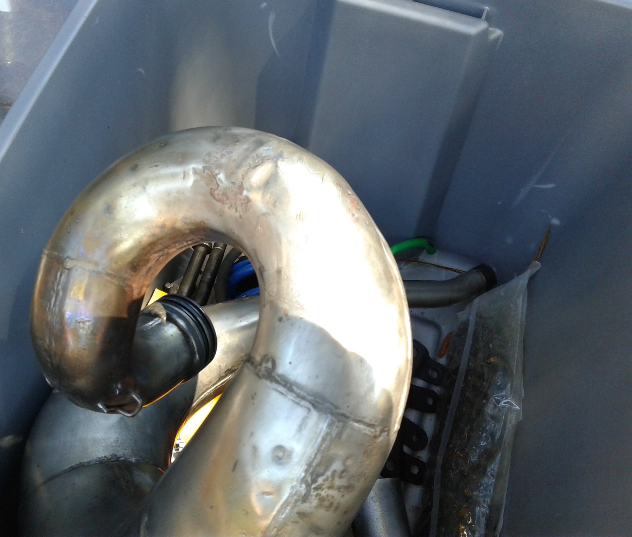

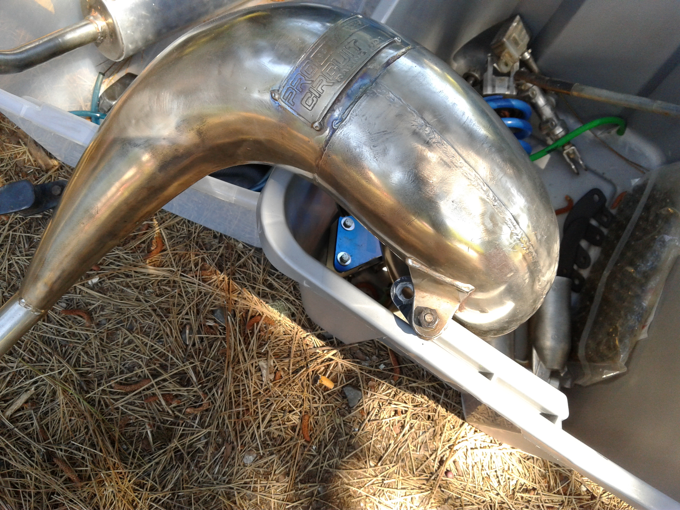

It's hard to tell by the photo's, but I was able to remove 6-7 Big dents in the pipe. Compressed air and a torch worked very well!!!
'91 KDX 250 D1
PacificNWRider
Posts: 86
Joined: 10:10 pm Feb 28 2020
Post by PacificNWRider »
If anyone is thinking about trying to fix their own pipe, I highly recommend it. I can point you to the gentleman that sells a well made tool for a very good price, and it looks to be use-able for many pipes, different sizes. I can also help with instructions if needed.
