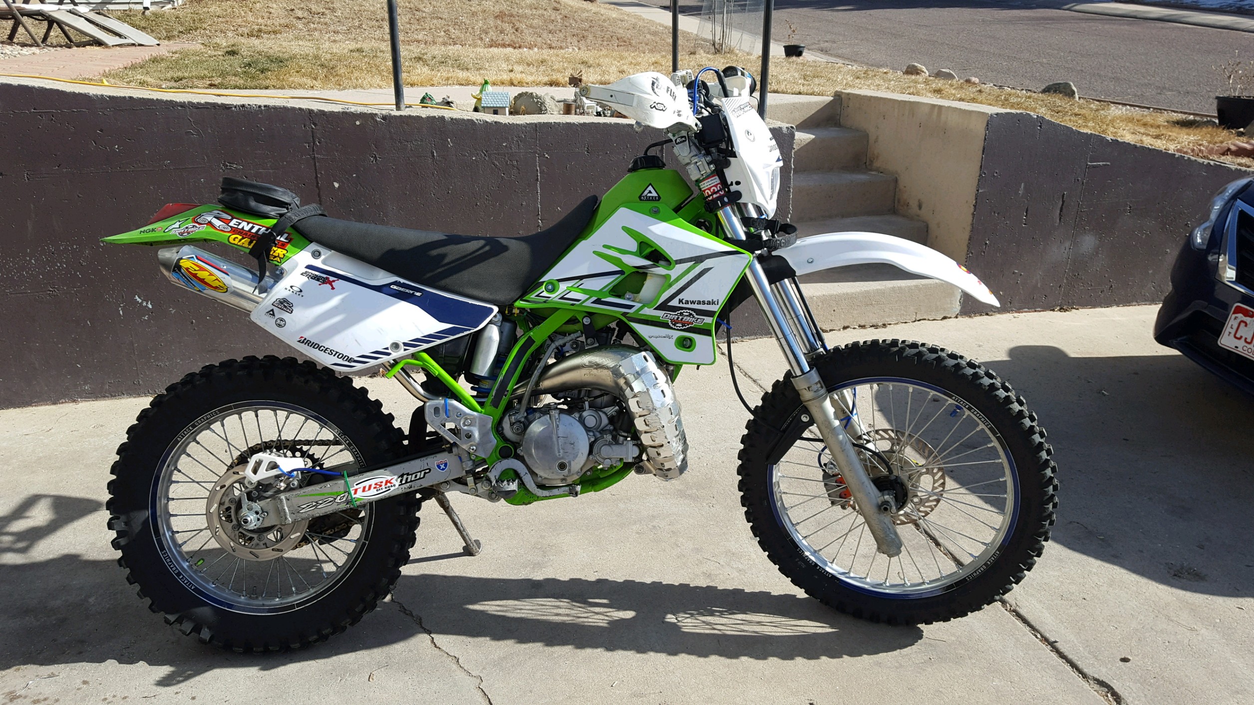

the best PRO mechanics advice who actually know and race KDX's (Freddette) says very strongly the FMF gnarly desert pipe is the 220s freind, this is the pipe I run and I can rip fast and I can crawl single track and Lug like a dream, the pipe was def worth the money and made my bike like a 250
IMO best mods would be:
FMF pipe
flywheel weight
Lectron carb (or at least carb mod as stock carb is crap)
gearing for me: 13//50 ( I can lug bike like a ktm up single track)
Reeds (boysen super stock)
((still need to get suspension done, hoping for next winter)
