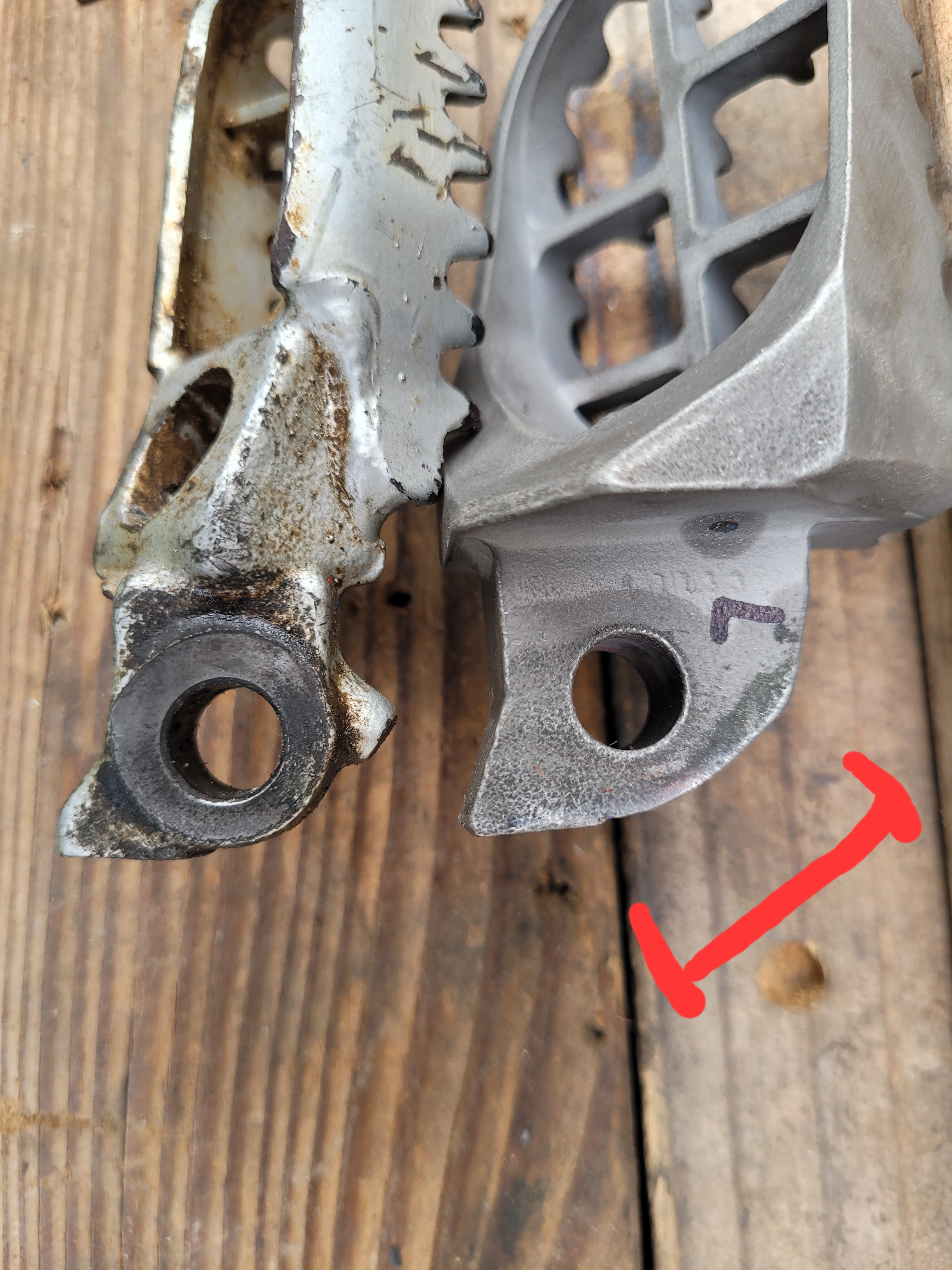

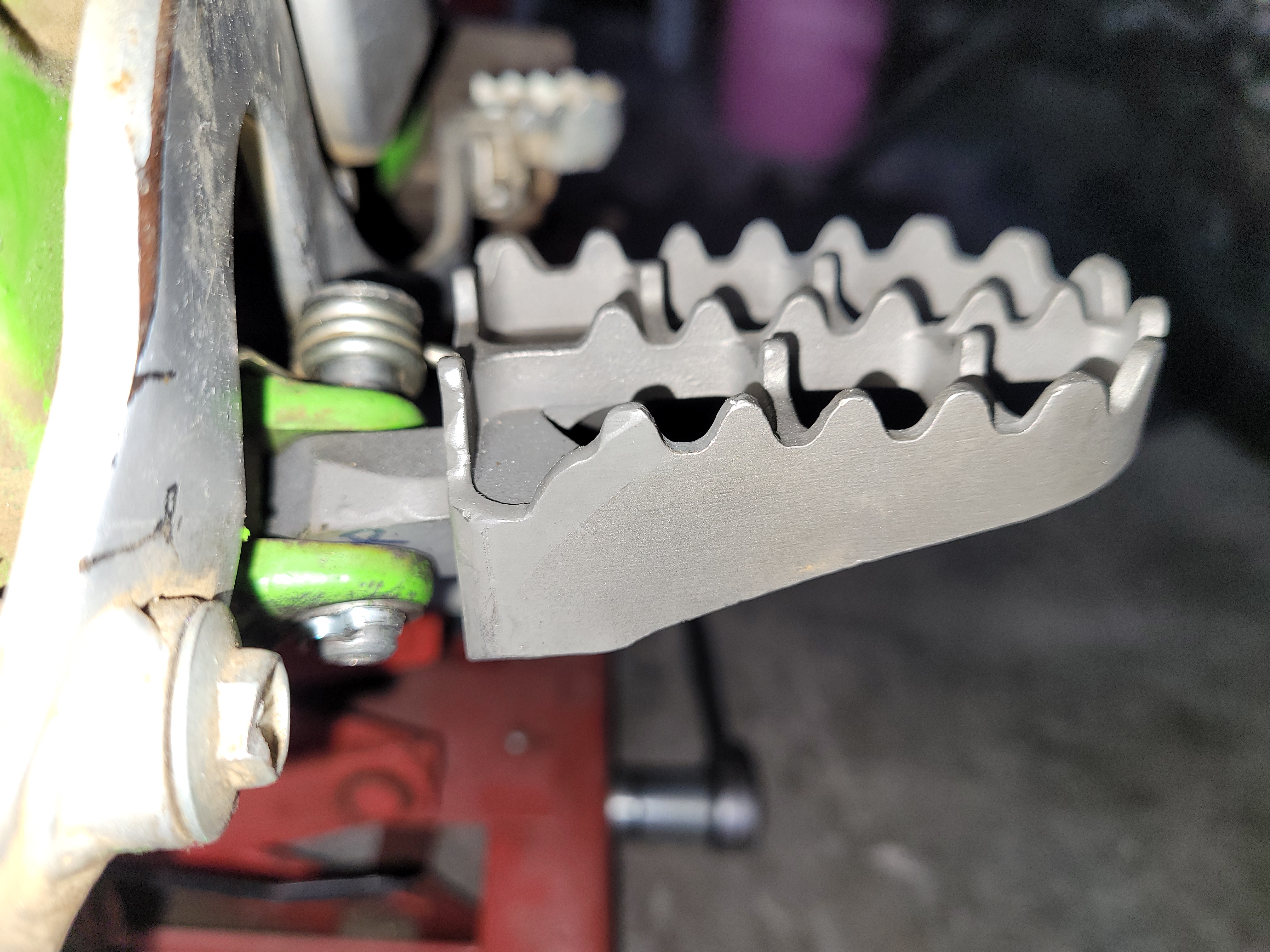

Re: wider foot pegs
I like IMS Super Stock Foot Pegs. Have them on Kawi, Suzi, & BMW. The pair for the KDX didn't fit quite right out of the package.
See photo showing upward angle.
See photo with red line indicating where it was necessary to grind material off new foot peg to achieve proper fitment.
See photo showing perfected install. Looks & works great!

billie_morini wrote: 10:52 am Oct 02 2025 I like IMS Super Stock Foot Pegs. Have them on Kawi, Suzi, & BMW. The pair for the KDX didn't fit quite right out of the package.
Those look great!
I need to look into wider foot pegs for my 92... That may be the solution for me, assuming they work the same on an E series (also assuming that was an H series/220).
Thanks for the great photos and explanation!
