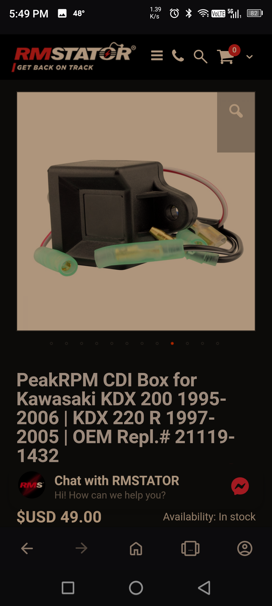

I also noticed that mow RM Stator and Race Tech Electrics are selling an "HP PeakRPM" aftermarket CDI replacement.
They advertise it as a replacement for the stock unit, but with higher performance connotations.
When I inquired asking if they had a timing curve vs RPM chart to share, they advised that it is like a stock CDI, but "with the rev limiter removed." Seeing as how there is no rev limiter, this wording seemed to somewhat contradict their continuation of that statement, saying "it will allow you to obtain up to 1000 RPM over OEM equipment."
Jaguar's ignition timing comparison graphs show his curve advancing about 250rpm earlier than stock, and reving out about 1500rpm higher than stock... That's awesome 👍
This PeakRPM CDI gains about 1000rpk on the top if it functions as advertised, so for $49.00, that's not bad at all...BUT...an SS109 Wild Azz Racing CDI or Jaguar KDX Performance CDI would obviously be way better!

Maybe I am no fully understanding this but perhaps someone can help with something.
OEM
IGNITER
21119-1432
$532.69 x 1
Aftermarket
PeakRPM CDI Box for Kawasaki KDX 200 1995-2006 | KDX 220 R 1997-2005 | OEM Repl.# 21119-1432 $49.00
Same part right?
Slight difference in price.....

The aftermarket unit will replace the existing OEM & is an absolute no-brainer versus buying a brand new OEM unit at $500, and allegedly the aftermarket RM Stator version has a 1000 RPM broader power curve. Same application, slightly revised part for better performance.
I was looking for one of the hand built custom ignitions that has a more broad power curve than even this aftermarket $49 CDI. Well worth it for those of us who are trying to get the maximum performance out of our machines in every department possible. I don't care if I have $5,000 into my bike, it will still be way cheaper than buying a brand new Beta 200RR Race or 250RR Race Edition, and SIGNIFICANTLY cheaper than buying a brand new Austrian bike.
