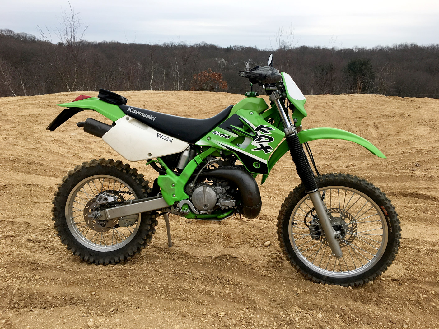

I was able to get out for a quick ride today and I can def say WOW. A good deal more power and torque throughout. I have only had the bike for a year and a half so Im not really used to the engine, but obviously it is a big improvement over the 17 year old top end. For now I will order up an FMF Gnarly Desert pipe but after that Im done for a while I think, lol.

- IMG_0784www.jpg (587.22 KiB) Viewed 22593 times

Ya, that looks great. I think the Gnarly will be a good addition. Thanks for the pic.
