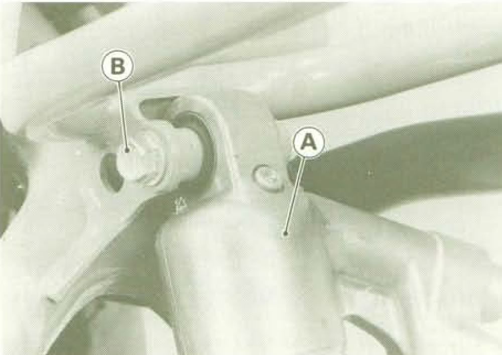

Quick question. Is there a bearing or something at the top of the rear shock where it connects to the frame? This part.
On mine I see what looks like a seal on each side and maybe a bushing in the middle like the swingarm. But nothing moves at all.
I just don't want to go crazy with a hammer and torch if everything is supposed to be like that.

and on the parts diagram it looks to be a bushing:

I figured there was something there. I just don't know if it is supposed to move or not. Light taps with a hammer does nothing.

You might have to press it out, getting it out with a hammer is doable but you might damage the bushing

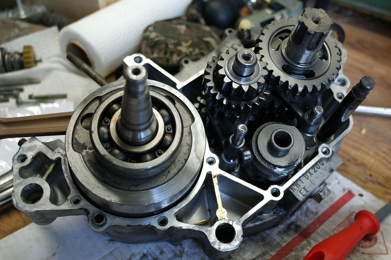

Well I guess it wouldn't be a true rebuild without tearing it down the the very last nut and bolt.

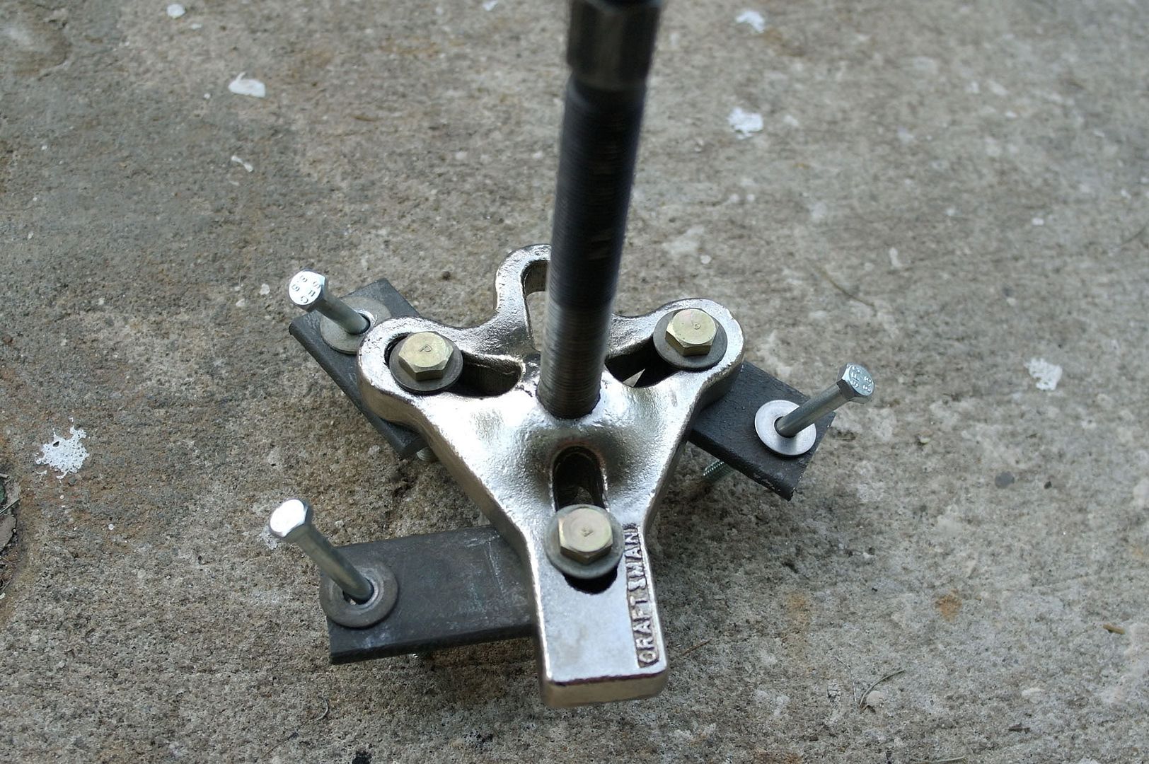

Made up my crankcase splitter today from a harmonic balancer puller and some steel bar I had lying around.
Worked like a charm. Total cost was about 3 dollars for the longer bolts that screw into the case.
I will be keeping my eye out for a cheap harmonic puller for myself since this was a loan from a friend.
The bearing pulled out with the crank. I guess this happens sometimes? Does it need to be pulled and reinstalled in the case or can I leave it on since I am not replacing it?

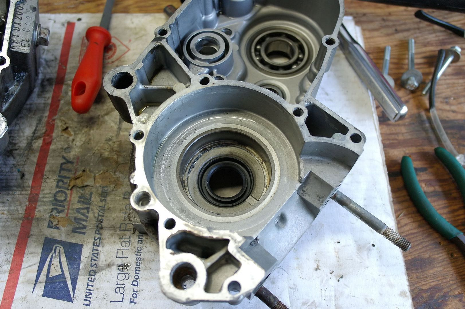

This seal I believe is good. I never had any gas/oil in the stator side so I will be leaving it alone.
I will be replacing the other seal though since there was a gas smell in the oil and I am already in there.

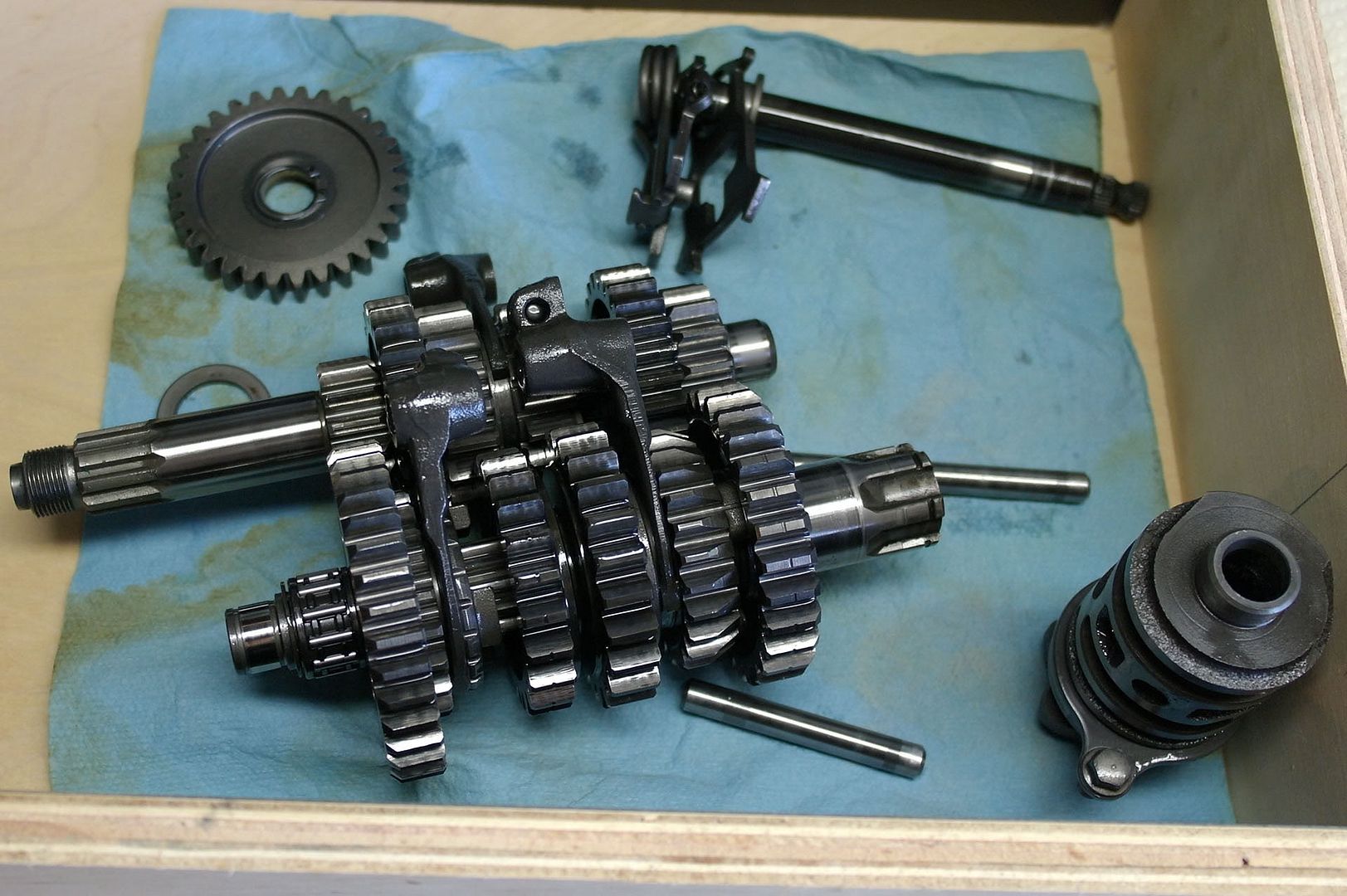

Transmission looks good. I don't really know what to look for aside from worn/chipped teeth or metal or something. Everything moves smooth.

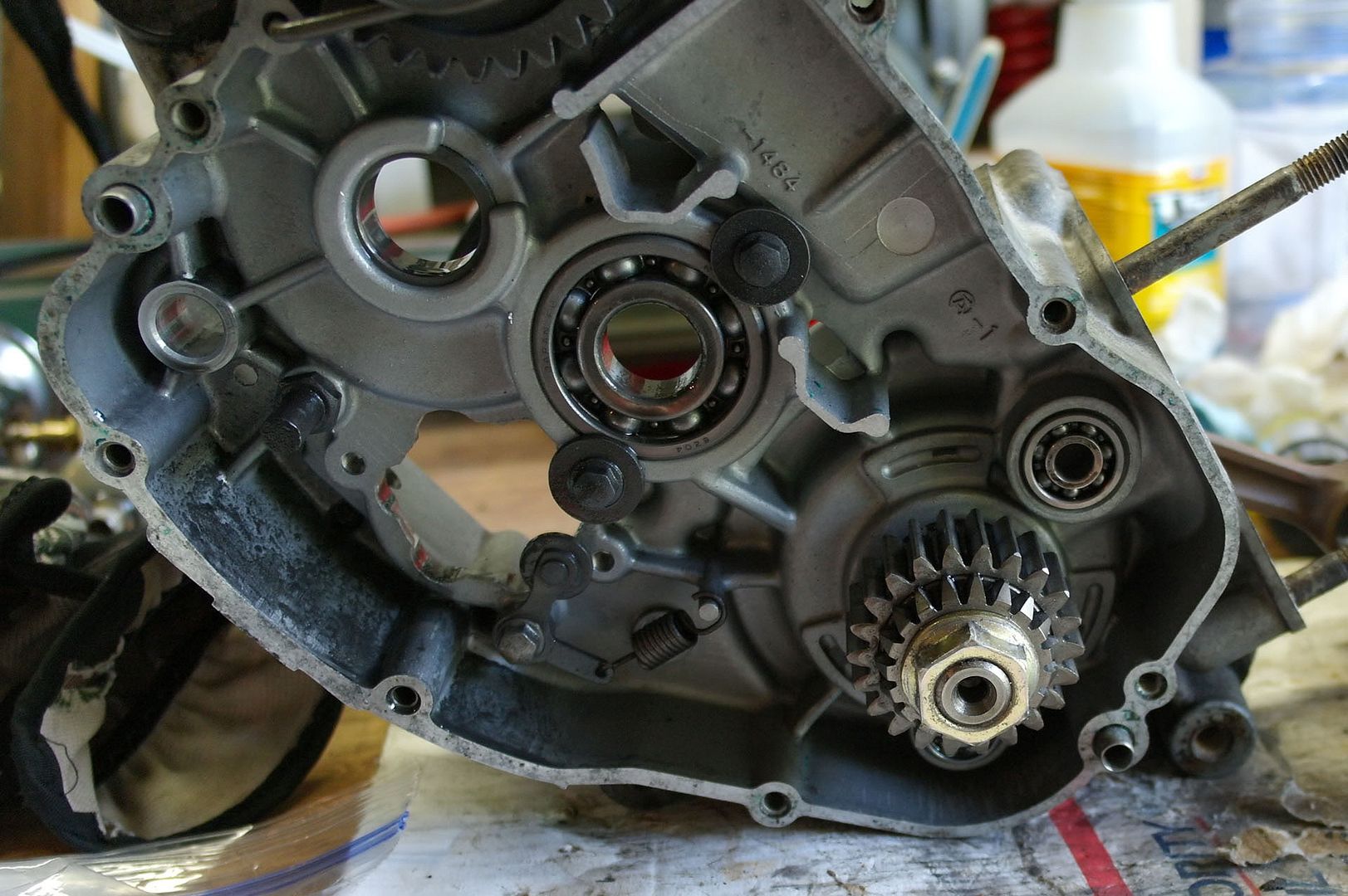

A couple of problems though. First off, I didn't think this all the way through.
I didn't take off this nut on the right side of the crankshaft before removing everything. The manual says it is torqued to 58 ft-lbs.
How can I go about getting any leverage now that everything is apart?
The second problem is that of the crank seals. Ronayers has two listed, 92049-1047 and 92049-1068. From some research it seems like they changed the seal after '89 from the 1068 to the 1047.
So I need the 1068 seal correct? I am just a bit puzzled as to why they would change literally that one piece after the first year.

Remove and replace the crank bearings. DO NOT chance reusing them. They are damaged when you split the cases.
That nut can be taken off with an impact wrench.

Slick_Nick wrote:Remove and replace the crank bearings. DO NOT chance reusing them. They are damaged when you split the cases.
+1 If you have to split the cases for any reason then you should replace the crank seals and bearings. Do you want to take the 50/50 chance of doing this again after the first ride?
