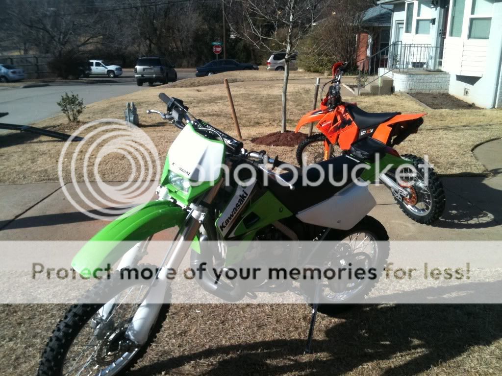

New to the site and thought I would post some pics and info of my project.
2003 KDX 220 stock
2005 KX 250 forks and trees :grin:
2006 wheel and spacers
Soon to come:
Wiseco piston
FMF pipe
Jetting
Reeds
RBD Axle so I can have a back up wheel & tire
RBD Carb Mods
Ride on

I picked the forks and trees up from ebay for $100 :grin:. I took the tree from my kdx and had the stem pressed out and pressed in to the kx tree with no knurling required. I also pick up a 2006 KX 250 wheel along with the axle and spacers from a 2005. I will tell you that the hub on a 2005 wheel and 2006 wheel are differant and therefor require the spacers for that year wheel, learned that the hard way. I orded some KLX300 headlight straps from local dealer...OUCH. All in all I have about $400 in parts in the front end. I took it out yesterday for the first time and it is not even the same bike..

You know it does frankenschwinn. Got the axle in from RB Designs today. You can check it out next ride. Let me know when you get the ring in!!!

kdub405 wrote: Got the axle in from RB Designs today.
How did it fit up?

How did it fit up?
rbates9,
It fits up perfect....Its nice to have a back up. :supz:
