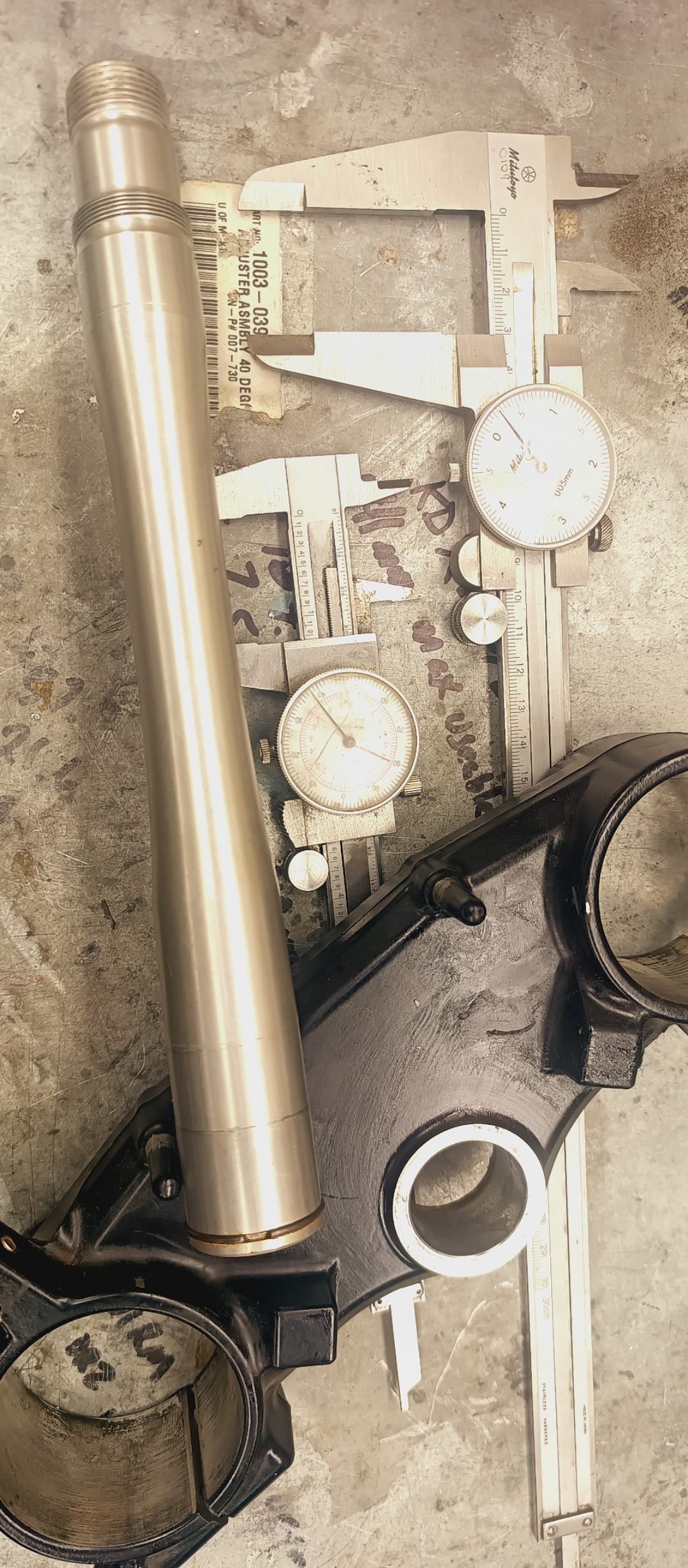

The 2020 KX250(F) KYB stem's press fit diameter was in fact the same as the 1990's 2000's (KYB) KX125/250 triples though, 30.15mm or 30.16mm, as well as the same as the '98-'06 KDX's.
This 2020 KX250(F) triple I just pressed apart had this retaining clip construction. If running the flanged type stem vs the circlip type, I'd have to bore the triple slightly larger or turn down the flanged end slightly to make the stepped flange o.d. just a hair smaller. I see in the photo above that the KYB YZ fork'd triple clamps also use the retaining clip style, ***which are also 30.15mm press fit.***

I didn't get to press out the CRF450RX steering stem tonight, rather unfortunately, as when I just started getting pressure on it, my homemade shop press' Enerpac RC106 10-ton hydraulic ram blew a seal after 20 years of my use, + it's prior life, as I'd bought used from an auction of used industrial supplies from a NASA facility! I guess it's had a good run... I really should get a pressure gauge to install on the hydraulic line if I rebuild this, it DOES say 10,000psi max on it.
