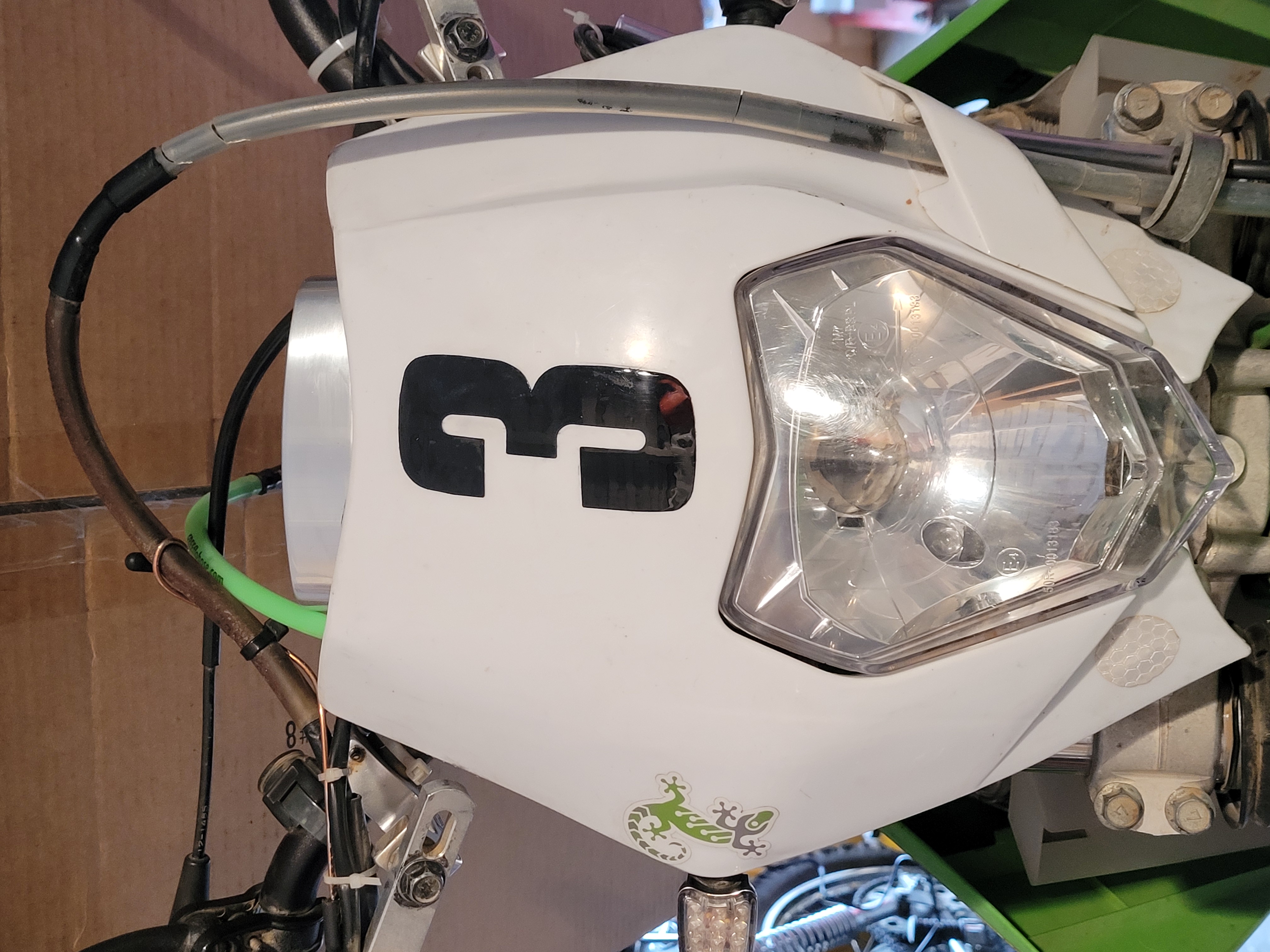

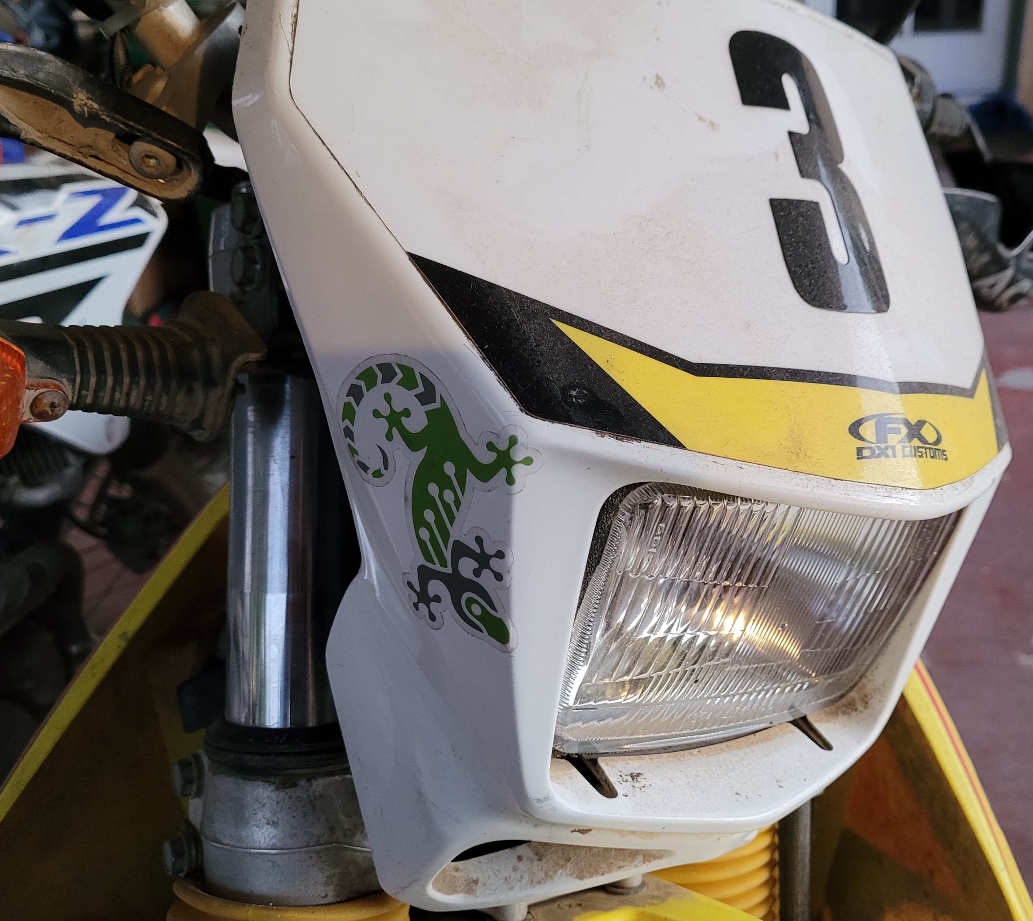

fun project you have. When completed, consider placing sticker of a koala or 'roo on the fairing. Kinda like the gecko on my KDX & DRZ (photos).
- Gecko-KDX.jpg (2.22 MiB) Viewed 36 times
- Gecko-DRZ.jpg (2.11 MiB) Viewed 36 times
