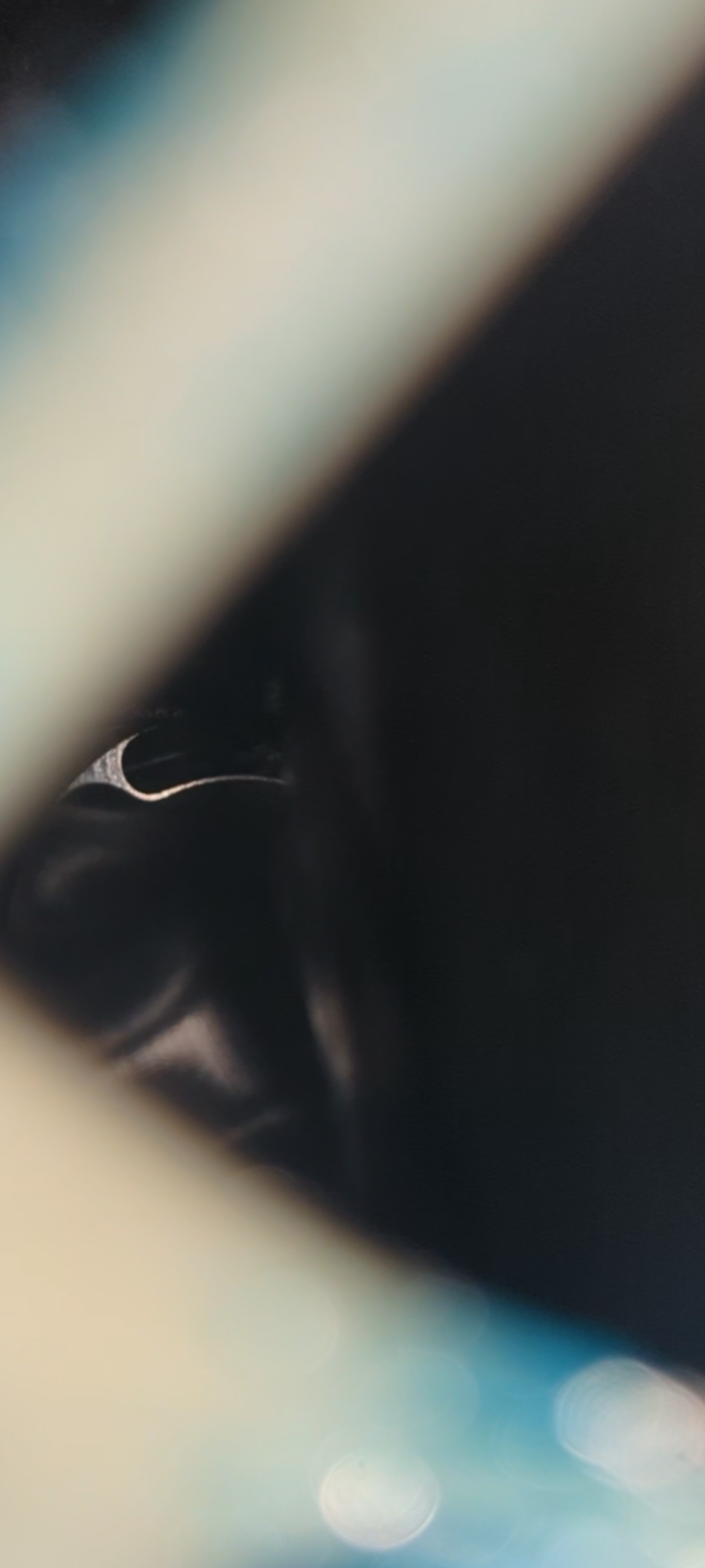

I had some free time on the drive up here to do some thinking. I took a look at the video and got a good still frame from it, it almost looks like the air boot starts dipping down the further to the right you go. Or maybe it's the photo, but maybe I need to take a closer look tomorrow. It definitely doesn't show signs of lean running or too rich, but just seeing that bothers me and I can't get my mind off of it. Too bad it's almost 12 o'clock.
Also, I need to verify my idle/slide height, as when I got the carb I adjusted the idle a bit once I got it on to get it to idle properly (stupid of myself) as I forgot metering rod carburetors are very sensitive to idle/slide height. I don't remember how much I turned it, so I do need to verify it's close to the stock height it was when it was sent to me. Again, it's running perfectly fine, but just not knowing bothers me.
Here is that still frame:
