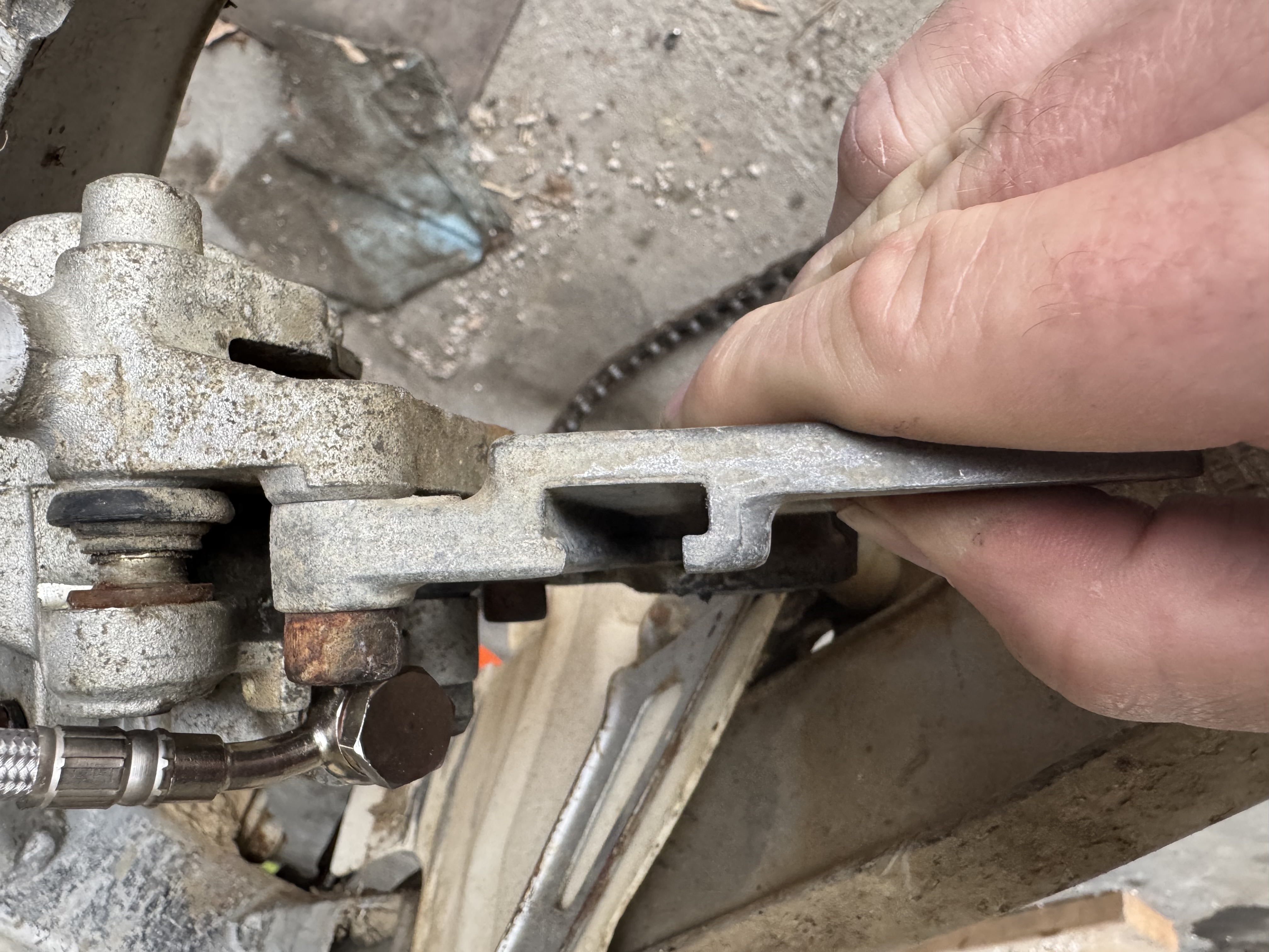

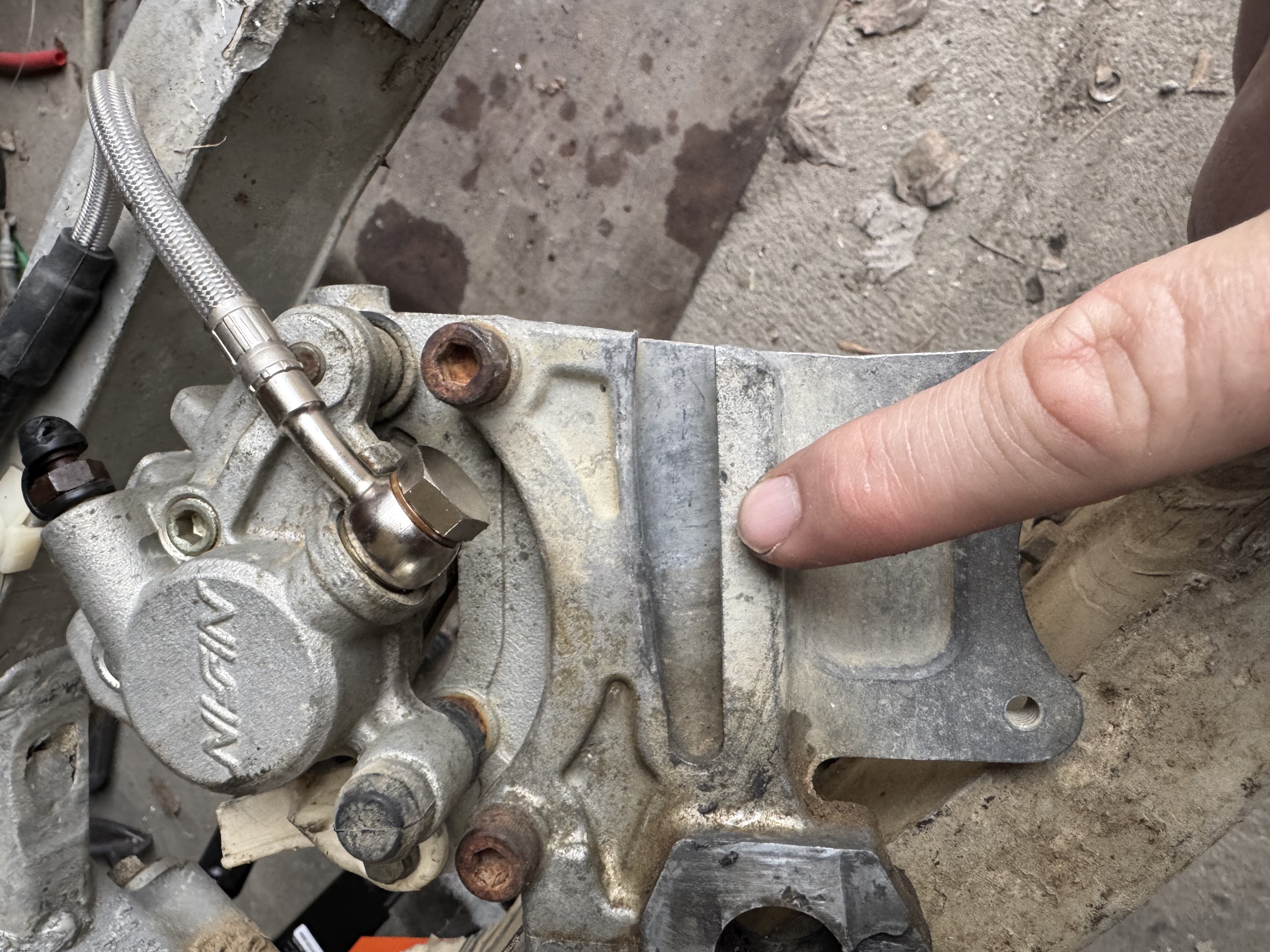

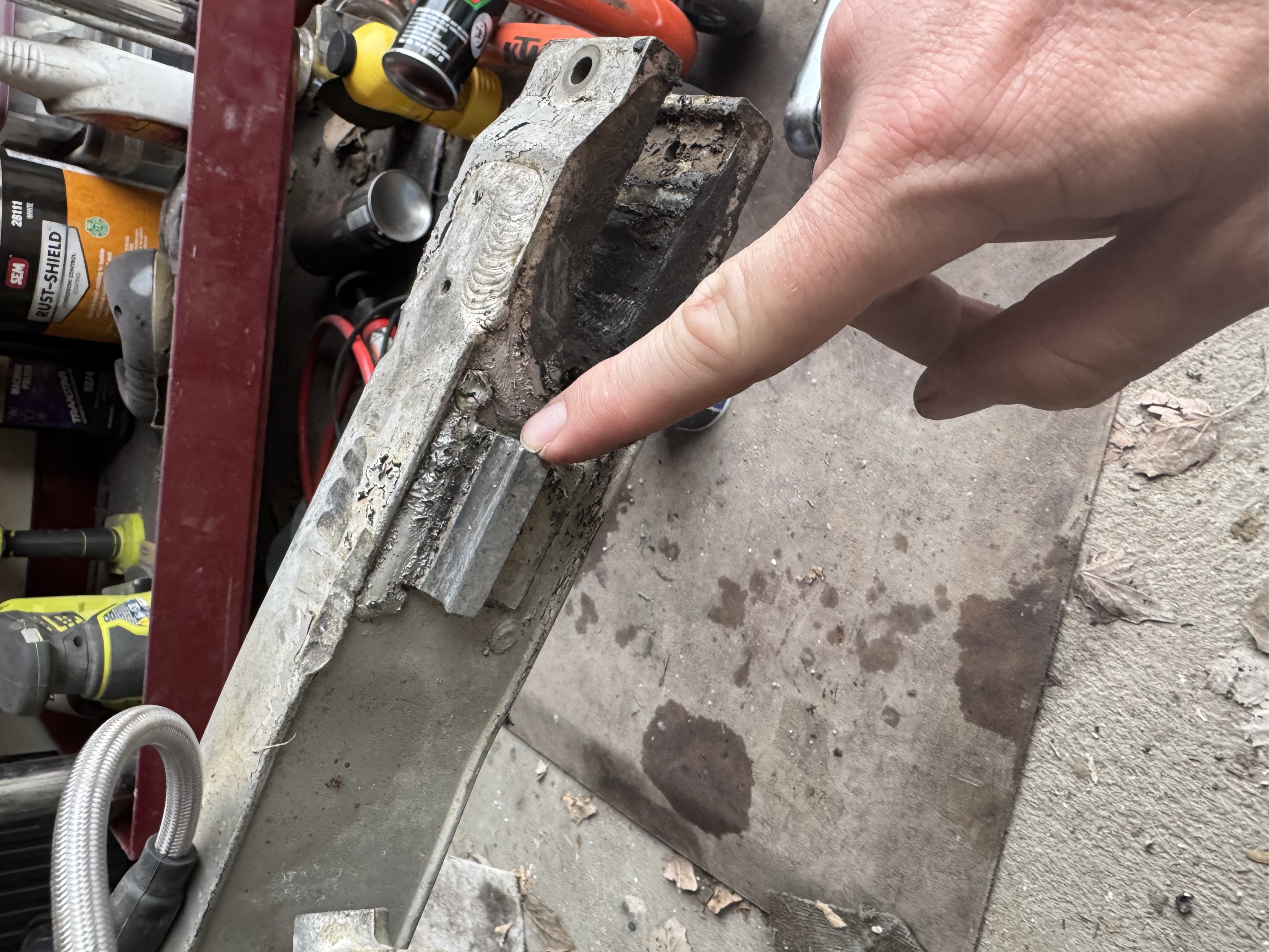

Re: 91 kdx 200 rear wheel spacing?
Sorry it has taken me a minute to get updates.
After checking, I am missing the 2mm washer. Does anyone know if it has to be that exact washer or can any 2mm thick washer work?
How would I check if the brake caliper slot thing is worn?
I will attach pictures.
Any help is much appreciated.
Thank you!
Thank you!
- IMG_4692.jpeg (2.11 MiB) Viewed 7360 times
- IMG_4691.jpeg (2.38 MiB) Viewed 7360 times
- IMG_4690.jpeg (2.62 MiB) Viewed 7360 times
- Posts: 1563
- Has thanked: 311 times
- Been thanked: 144 times
OUCH!
Yes, your rear caliper hanger's interface slot to the swingarm is far beyond worn out....
You can find them used on eBay with and without the rear caliper, and potentially even new from Kawasaki or New Old Stock.
Also, the Scott's Performance Shark Fin heavy duty rotor guards are integrated into a billet CNC machined caliper hanger replacement as well... but at a hefty price tag of $150.
https://www.scottsonline.com/Product_Pu ... BI_ID=2164
