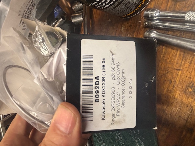

This might be a stupid question but I would hate to start this project with a stupid mistake. I have a 97 220 and am doing a fresh top end rebuild. I had a shop hone the cylinder, measure the cylinder and order a Wossner piston and rings. The rings come with a stamping on them. N100. Do they get installed with the stamp upwards? I am guessing so but I want to make sure. It didn't come with instructions and I couldn't find anything on their website. I have searched here and not coming up with anything. It's been 30 plus years since I have been in a two stroke so I am taking it slow.

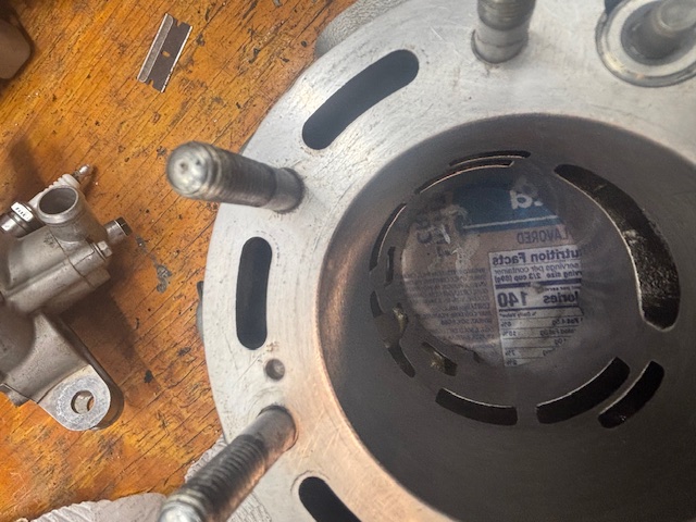

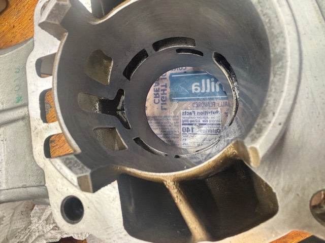

I didn't consider that. I brought it to the local repair shop (they don't specialize in any one brand but work on a lot of different machines ranging from jet skis, snowmobiles and motorcycles.) to have the measure the diameter of the cylinder so the right sized piston and rings could be ordered. I had them order the piston and rings. They knew what machine it was so I figured they knew if it could be honed. I attached three pictures and from what I know about sleeves it doesn't appear to me that it is sleeved. The third picture is of the Wossner piston and rings that they ordered. I don't know the history of the bike since I have only had a little over a year but disassembling it I was under the impression it was all stock. Nothing has been done to the exhaust or intake so I was thinking everything was stock.

It is hard for me to see on those pictures. See if there are any chipped edges around the ports.
Electrosuion coated cylinders do not have strong cross hatching like most other cylinders.
Hopefully they took it gentle. Maybe they used one of the brush types that is for deglazing.
On the ring ends, do they have an arced end? Is there a piston ring pin in the piston that would match up to it?

KDXGarage wrote: 09:11 am Apr 05 2026 It is hard for me to see on those pictures. See if there are any chipped edges around the ports.

I think I'm good as well. Back to my original question-Wossner rings. Does it matter which way the rings go in? Does the stamp on the ring go up or down?
[/quote]
N100 stamp up on both rings.

Wossner piston rings should be installed with markings (numbers, letters, or dots) facing up (towards the top of the piston/combustion chamber).

billie_morini wrote: 05:03 pm Apr 06 2026 Wossner piston rings should be installed with markings (numbers, letters, or dots) facing up (towards the top of the piston/combustion chamber).
Thanks! I am good to go. I was having problems connecting to their website but finally got through as well and found an install guide. Must be because of a foreign website? Who knows
