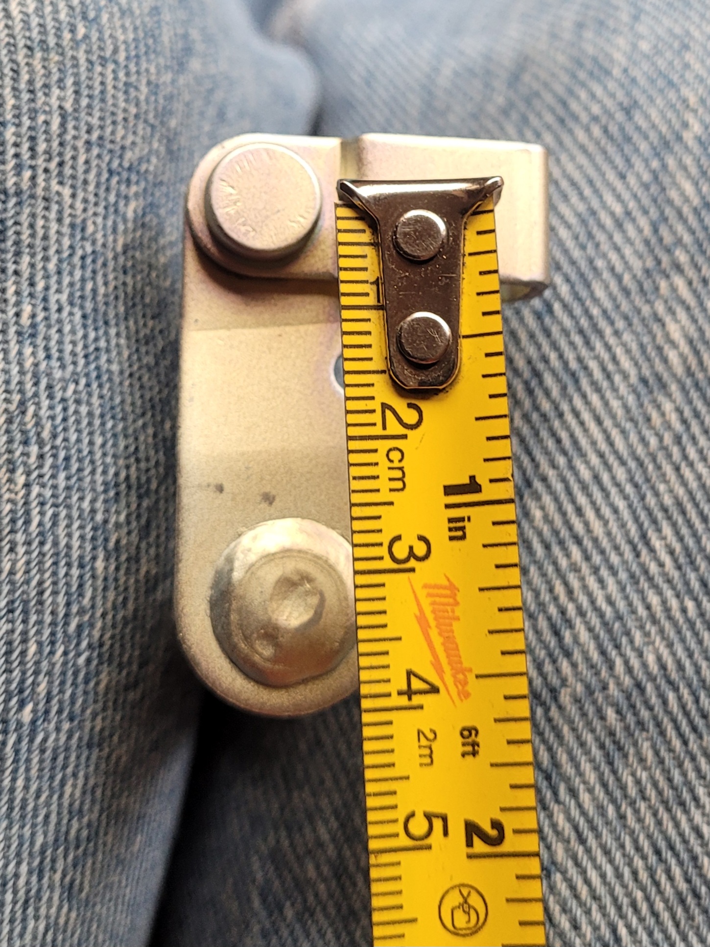

I asked Jeff Fredette why his new clutch activation arms appear to have welds (because I thought it would be made on a lathe). Jeff said, "Since Kawi doesn’t make the arms anymore, I have sourced a different arm that I have to modify hence the modification." So, this answer is along the lines of Kawibunga's shared thought.
Back in JAN 2023, Moonstomper reported the measurement of 27 mm between the center of the shaft beveled head and rivet. Here'sa photo showng the Fredette arm length measured at 32 or 33 mm. So, this is a good thing.

billie_morini wrote: 12:32 pm Mar 30 2026 I asked Jeff Fredette why his new clutch activation arms appear to have welds (because I thought it would be made on a lathe). Jeff said, "Since Kawi doesn’t make the arms anymore, I have sourced a different arm that I have to modify hence the modification." So, this answer is along the lines of Kawibunga's shared thought.
That's what I suspected as to why it was a 2-piece or rather 3-piece (w/coupling) shaft vs 1-piece.
