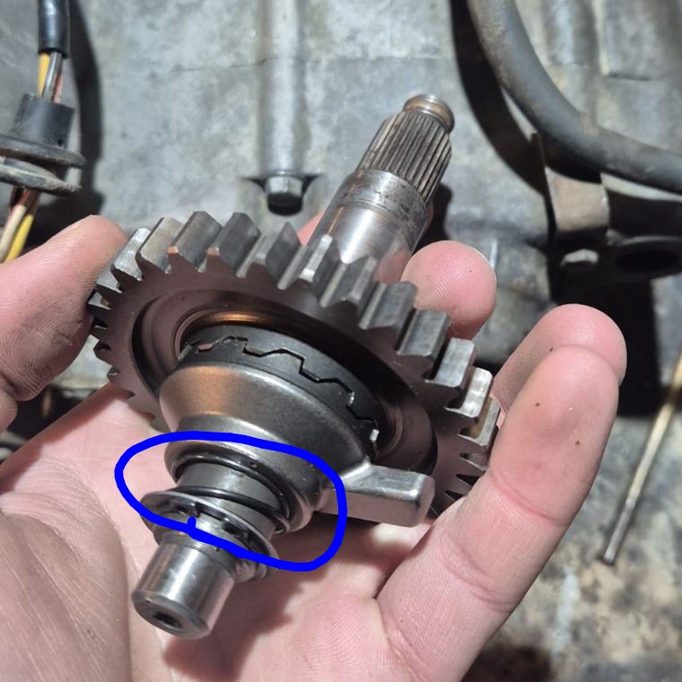

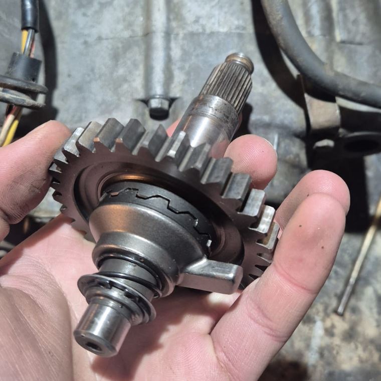

Re: kickstart problem
Everything seems to be fine there
- PINION 2.JPG (43.08 KiB) Viewed 71419 times
- PINION 1.JPG (79.14 KiB) Viewed 71419 times
The coil spring in the assembly is likely to be weak and causing this engagement issue.
Are u talking about the spring in the video ?
The other one, at the other end, and the plastic bush I bought original, but this little one they don't make it anymore.

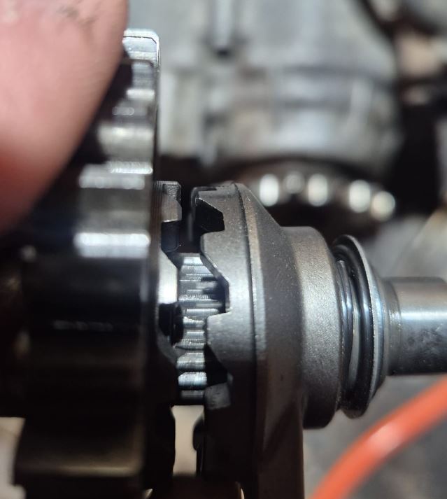

That small spring behind the ratchet assembly is the one that likely needs replaced if the kick starter is slipping while you kick.
I replaced mine and it helped a lot, but it wasn't a total fix. My gears looked like yours, not extremely worn.
If you compare a new one (I found one on partzilla) and compare it to the old one there is a noticeable difference in stiffness.

- PINION 1~2.JPG (100.03 KiB) Viewed 70984 times

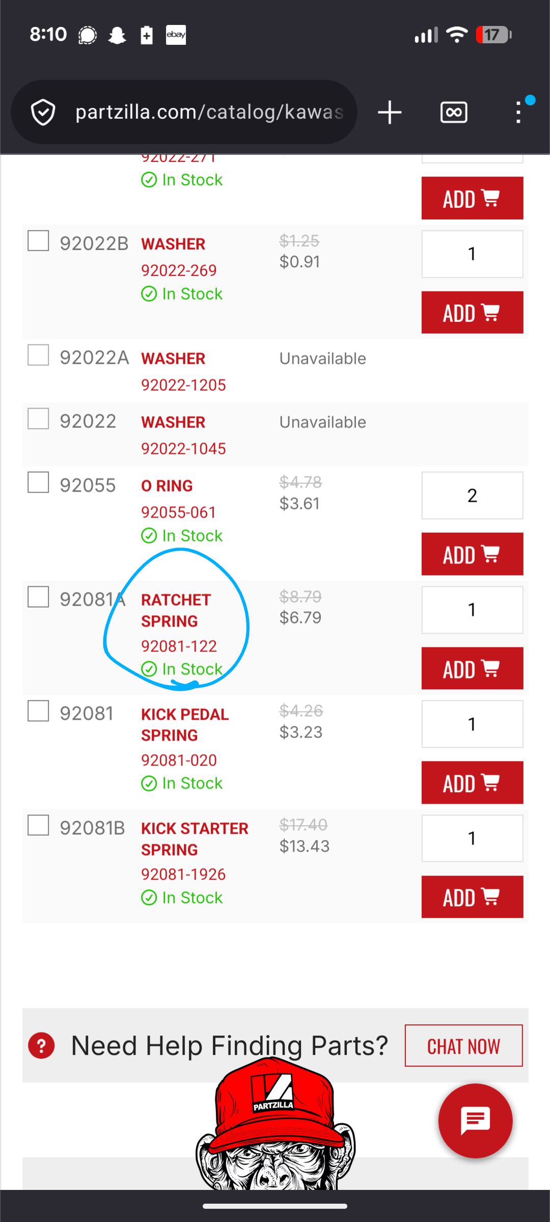

Partzilla still has the OEM spring in stock.
If you find a stiffer one that would be amazing. I could definitely use one hahaha.
- Screenshot_20260323-201047.png (459.04 KiB) Viewed 70977 times
- Screenshot_20260323-201019.png (655.67 KiB) Viewed 70977 times
SpruceItUp wrote: 07:12 pm Mar 23 2026 Partzilla still has the OEM spring in stock.
I believe somewhere on this forum, it is documented someone finding a spring that is like the stock powervalve governor spring but stiffer or softer, in order to alter tuning characteristics, so finding a similar spring for the ratchet mechanism of the kick starter is certainly possible as well, going slightly firmer in pressure rating.
